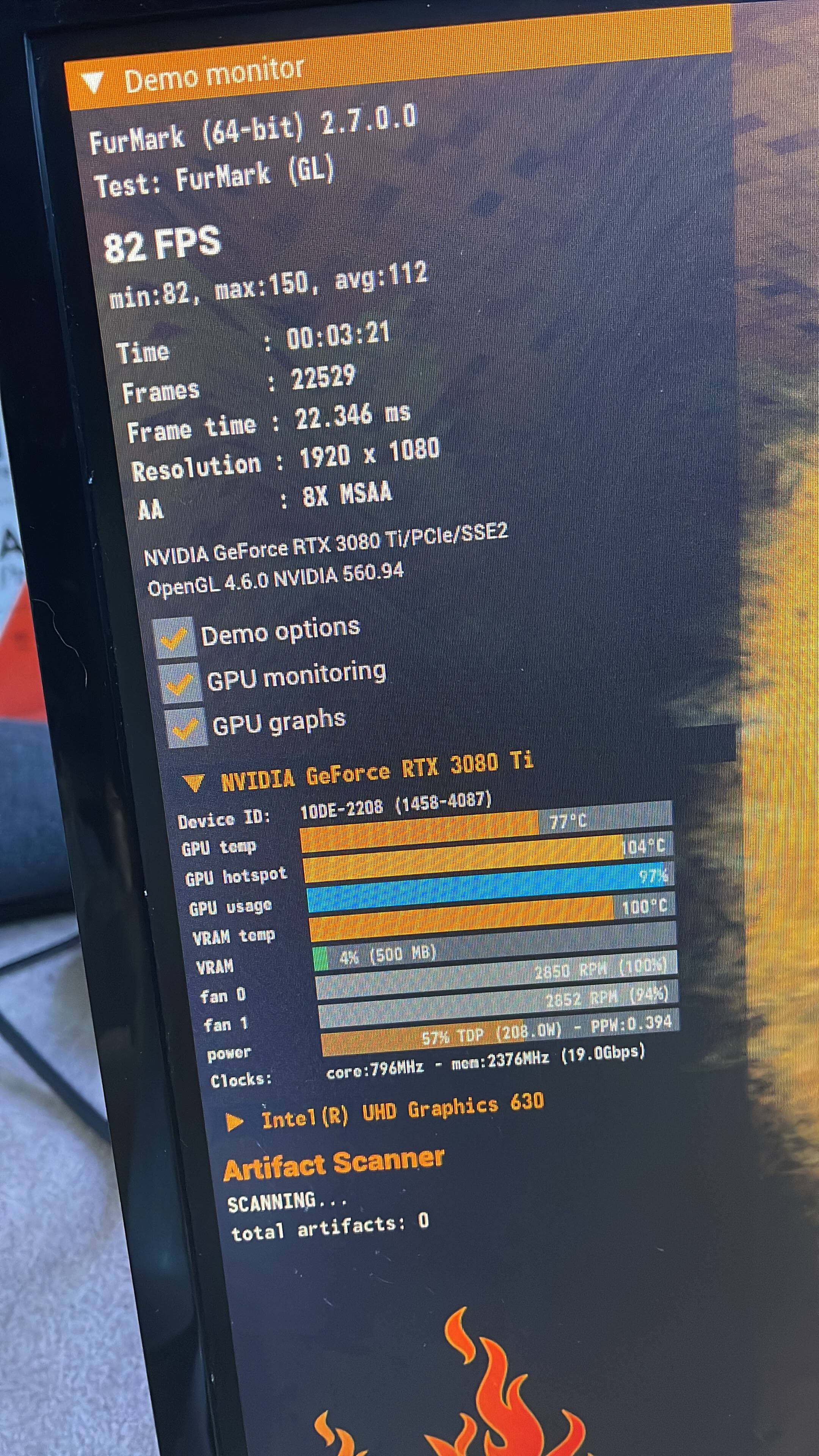

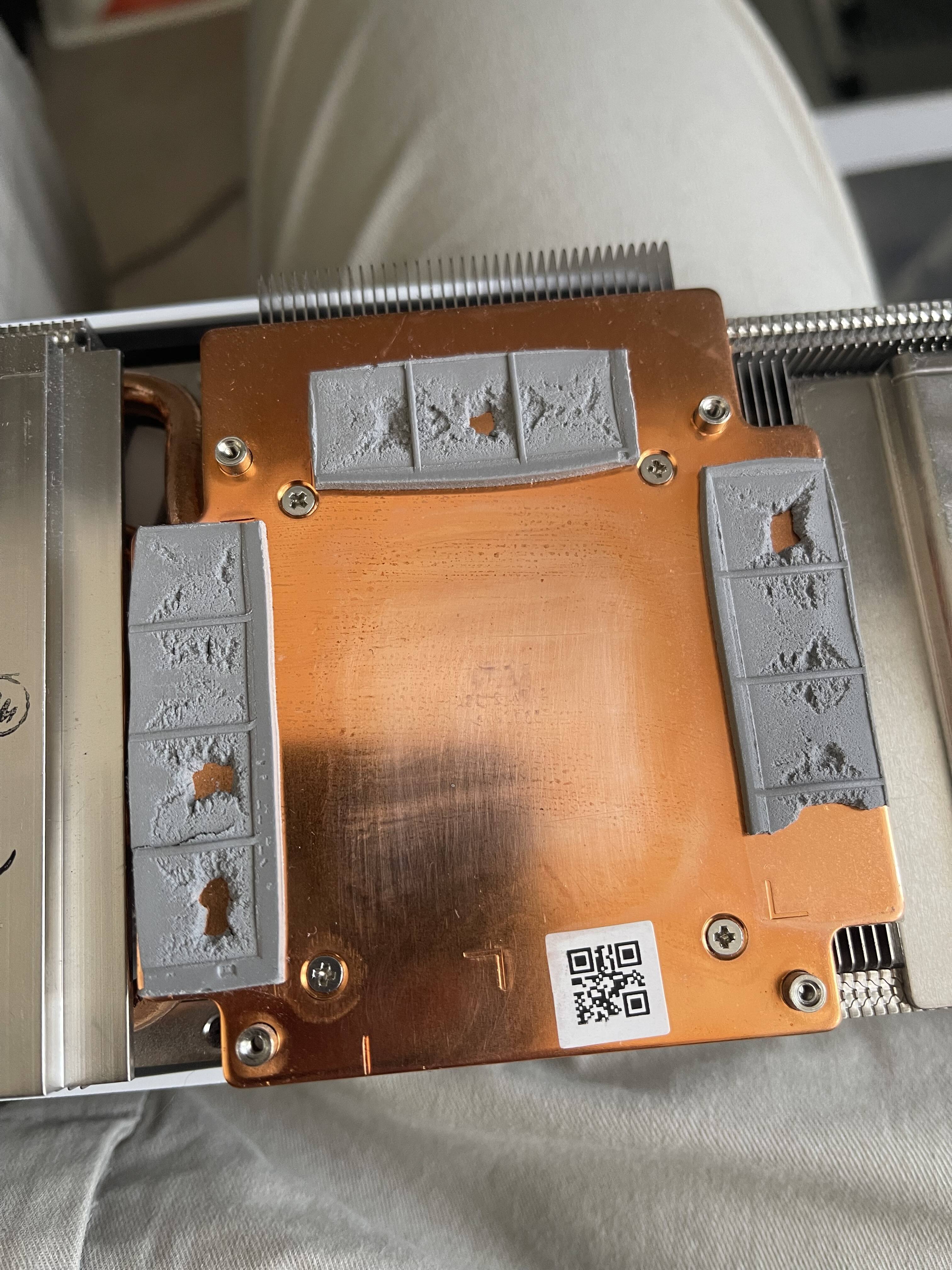

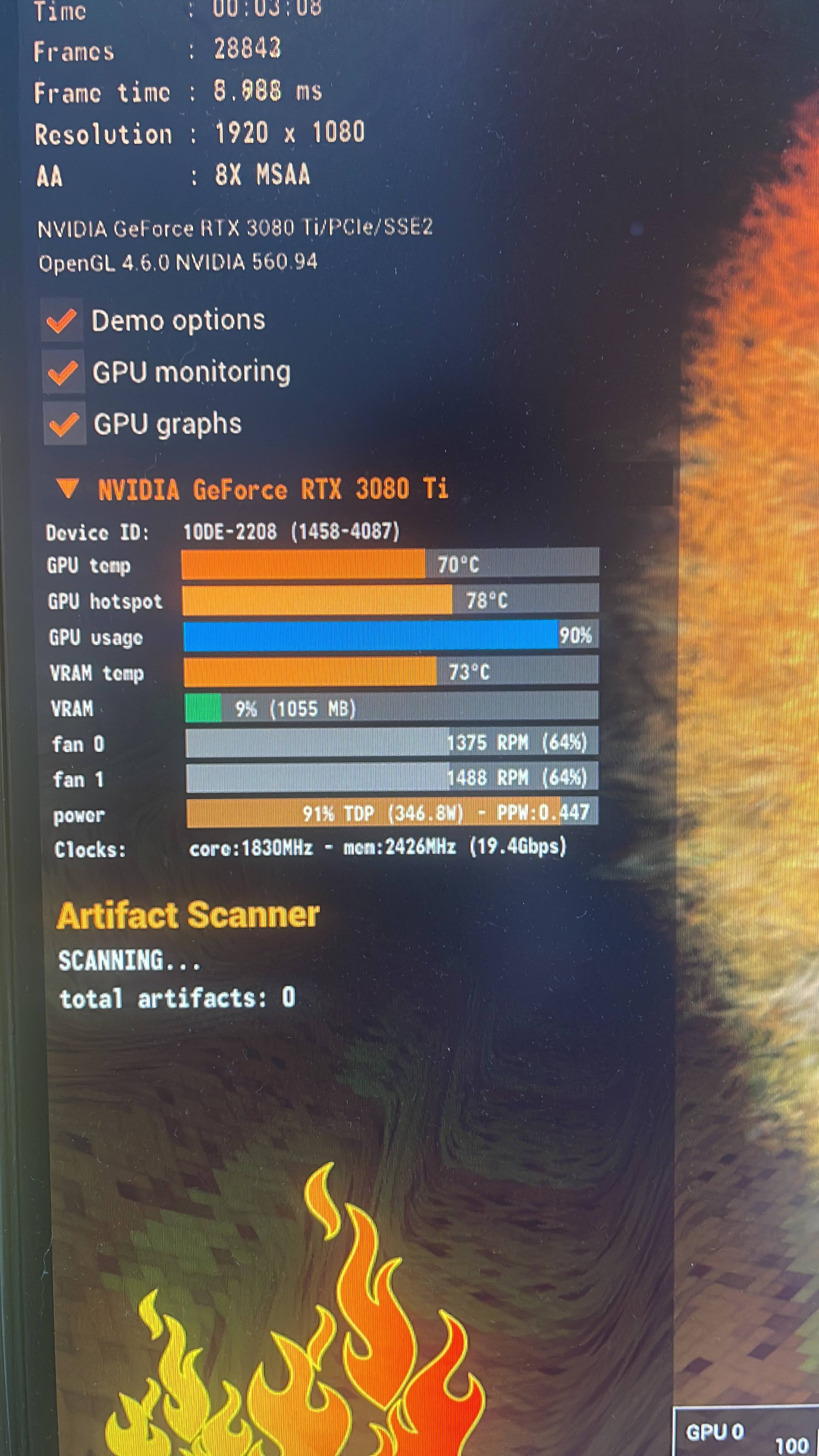

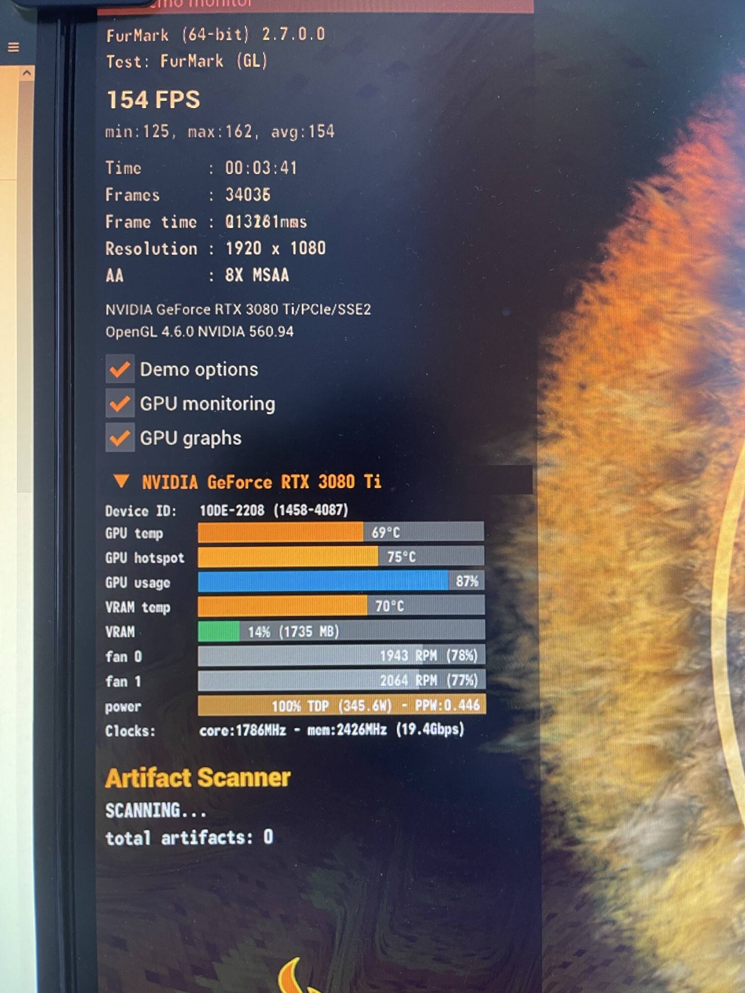

I'm quite impatient so I've done the gpu thermal paste, not pads as I'll need to order replacements - already seeing a huge difference in temps even in furmark...
With the case door detached I'm getting a max hotspot of around 82 but as soon as I put the door back on, it understandably crept up to 90 - my vanity of seeing the GPU might not be doing it any favours temperature wise. I just worry about the sag, it's a big card.
Thinking of what else I should try in terms of placement or fan setup, I do still need to do those pads.

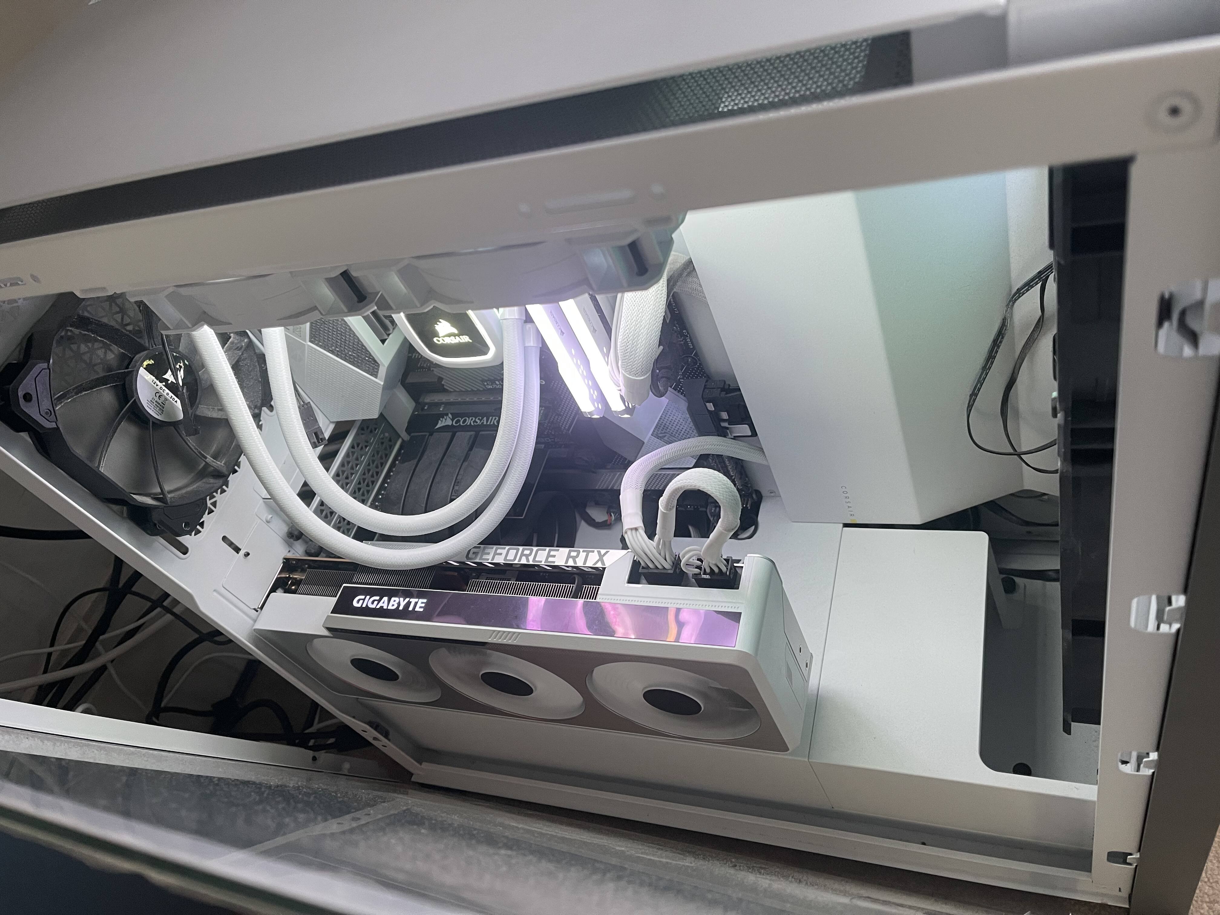

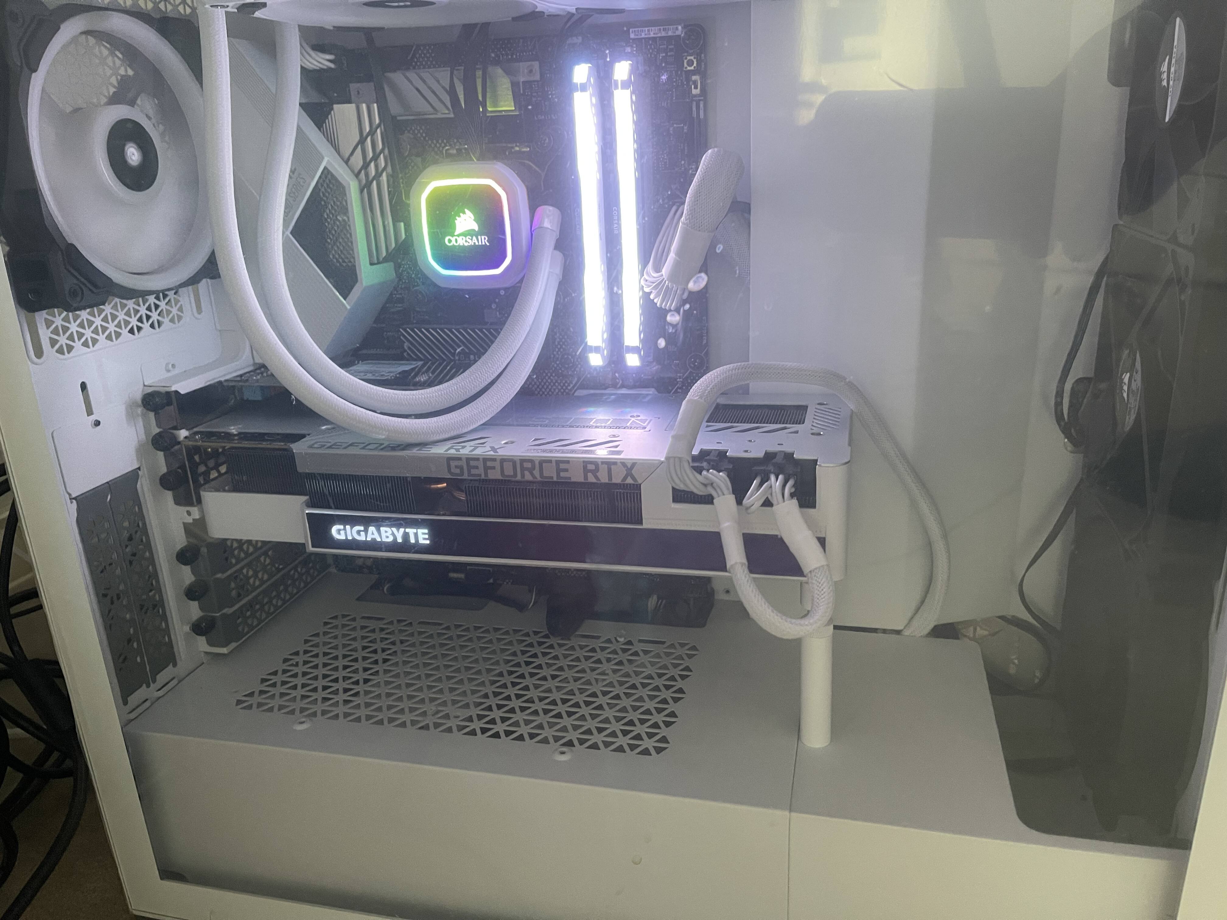

Beautiful build, but yeah, there's a HUGE problem: The card can't breathe.
Also, it looks like you have front and rear intake which is gonna be less than ideal. I'd absolutely put flip that rear to exhaust and if you don't already, I'd also to top exhaust
You can skip the pads and do K5 Pro. It's way cheaper than buying all the different correct sized pads
Oh I will swap that rear one around, derp.. I do have top exhaust with the two fans on my AIO cooler, arrow pointing up.
I'm going to invest in some sag brackets, they're only like £5.
Appreciate the suggestion for K5 pro, it looks pretty nifty but sounds messier than pads? 🫠
Good. And never forget: we all make mistakes
Good idea. My sag bracket cost about 40cents given that it's a stack of pennies wrapped in tape :L

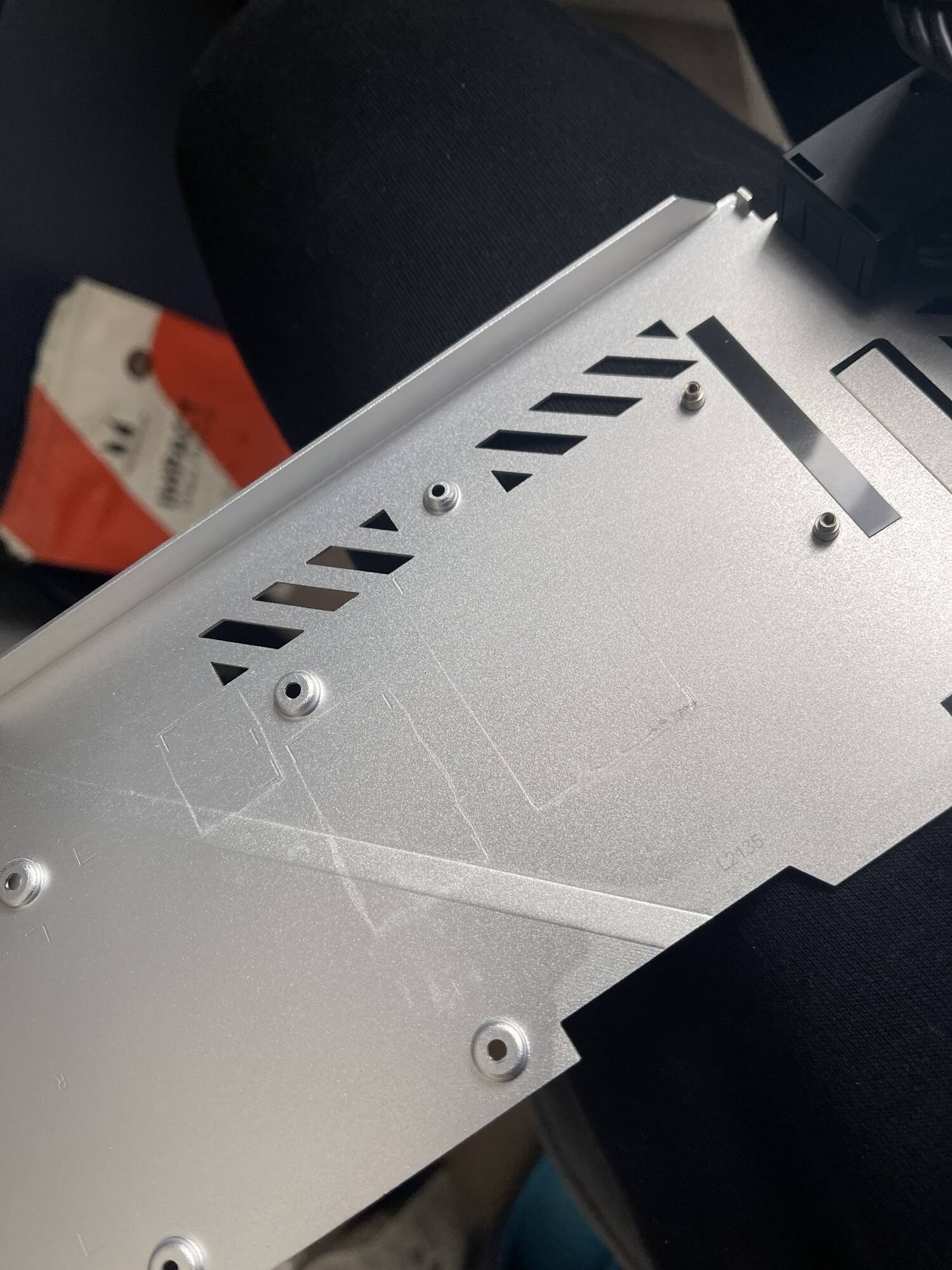

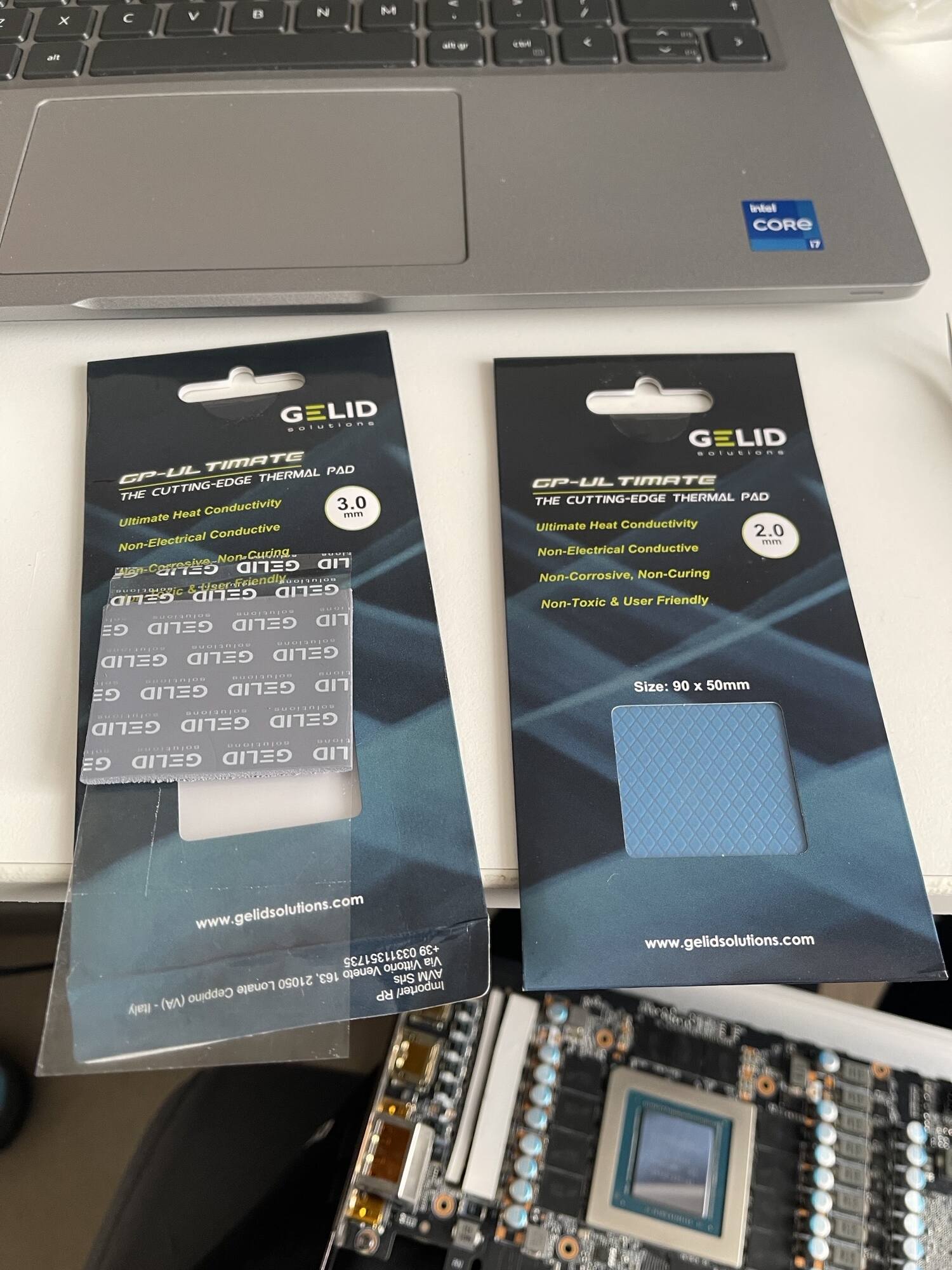

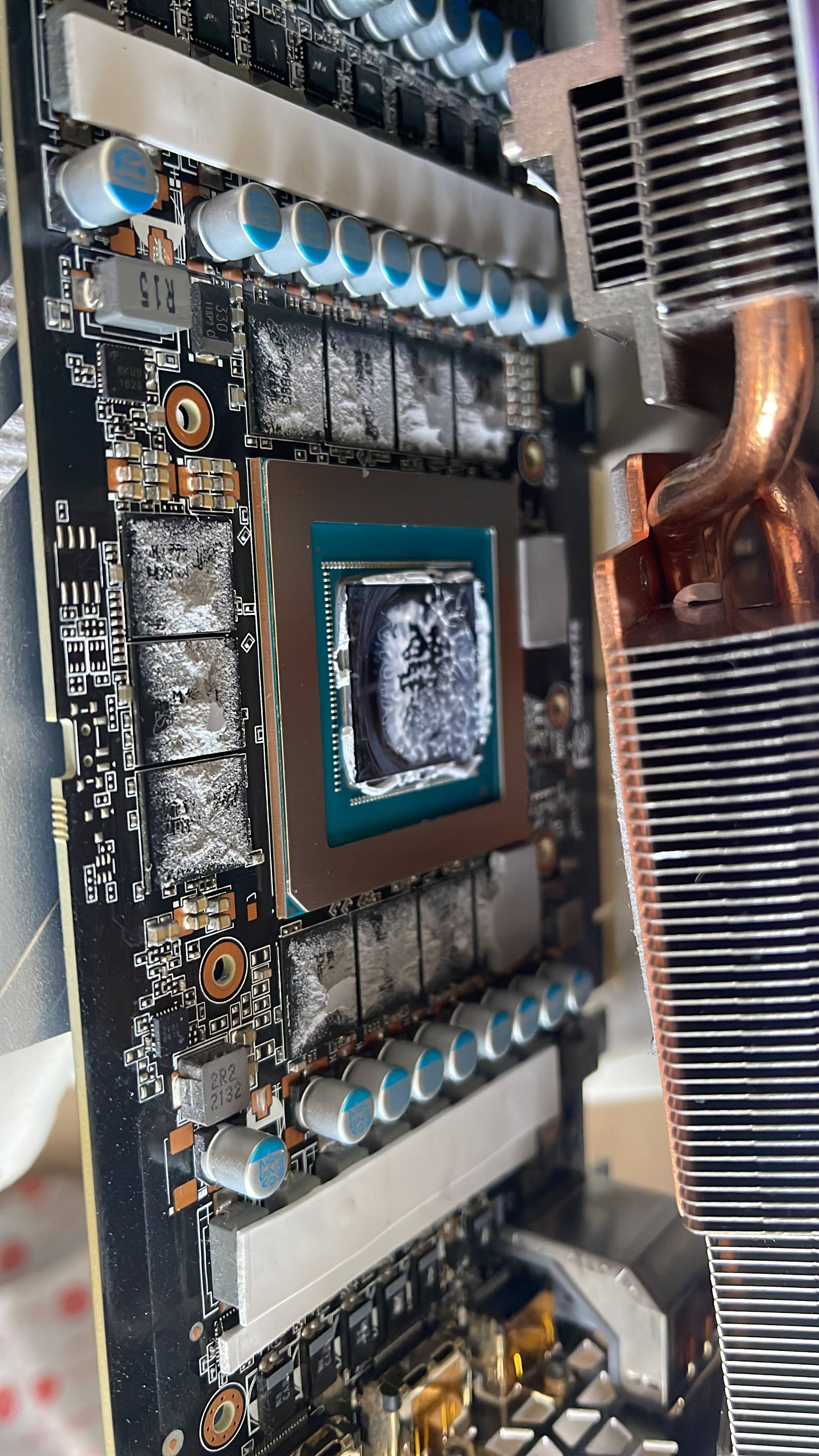

I did it (got gelid pads because I kinda looked forward to the measuring and slicing to the correct size lol)
My dumb ass only got these photos but no issues since I've changed the 2 and 3mm pads

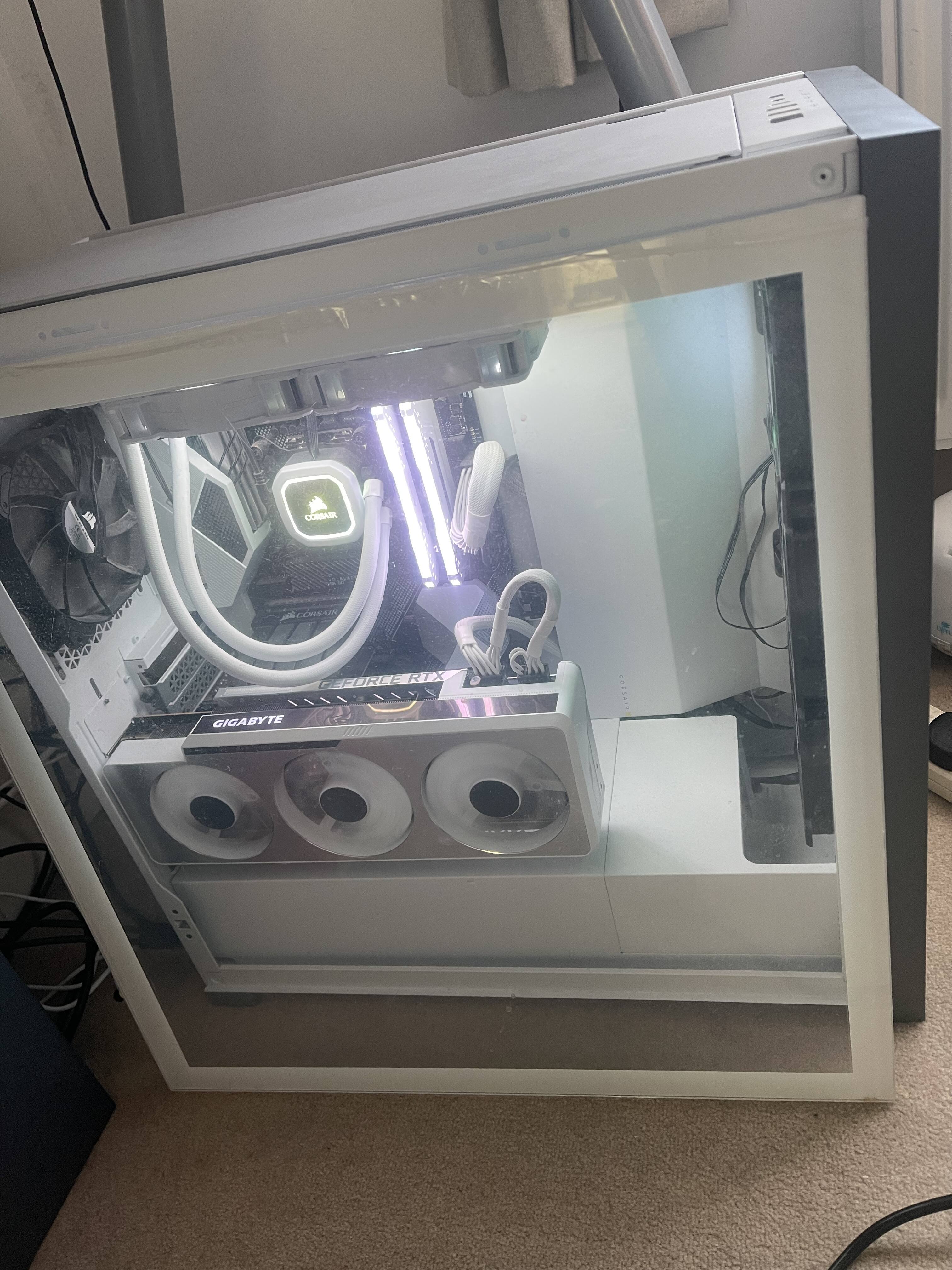

Also got the stand for the GPU and changed orientation, and removed a bunch of old corsair LED's, and their controllers from the PC just to simplify and reduce power consumption.
Not a huge change in temps with new pads but they were very oily and the VRAM ones were very dry as seen in previous post so I'm glad i changed it. I'm guessing the chip overheating was causing the VRAM to warm up?
*** Oh and I flipped the rear fan around so now i've got 3 intakes at the front, 1 exhaust at the rear and 2 exhausts attached to the AIO cooler at the top.***
