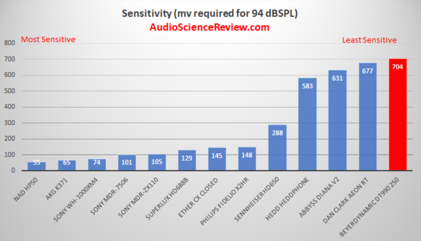

You are confused. A preamp doesn't amplify the sound and from what I read, the dt990 pro are not very sensitive at all. You will need an amp to get decent sound from them. Not sure if the gen 3 is the same as the gen 4, but the scarlett only outputs 22mV @ 300 ohm.
And this is the chart for the dt990 pro's
