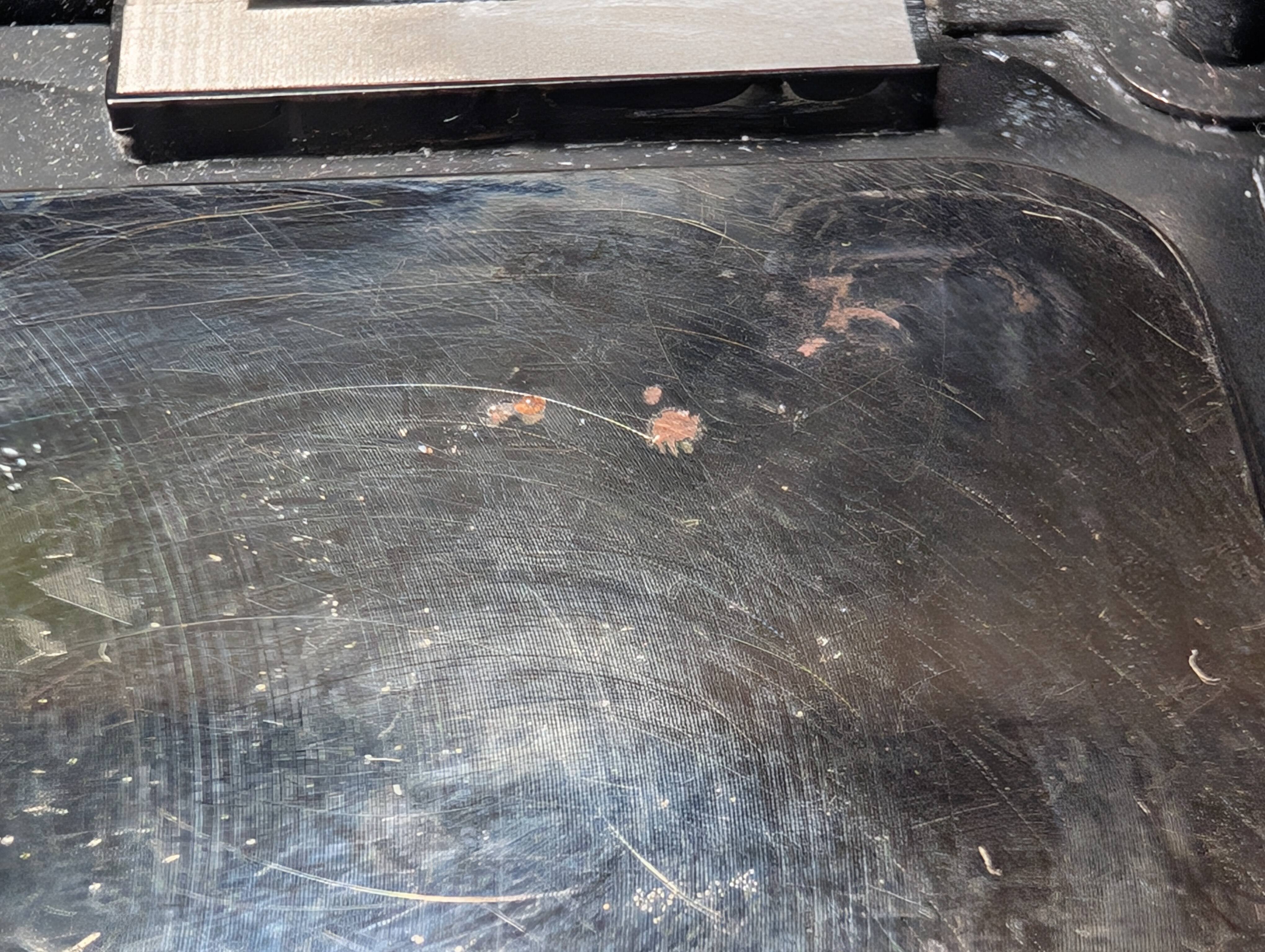

So i thought i'd update in case somebody comes across the same issue:
It looks like the cooler was the problem.
After some looking around, I found this article: Link
I had a closer look at the cooler and saw some exposed copper on the part which contacts the die.
So I went on ebay and luckily I managed to find an original cooler from a 3080ti FE. I fitted it with the same putty and paste, and now it's fixed!
It seems like my old cooler's vapor chamber may have been compromised so it was just a hunk of metal trying to cool the card.

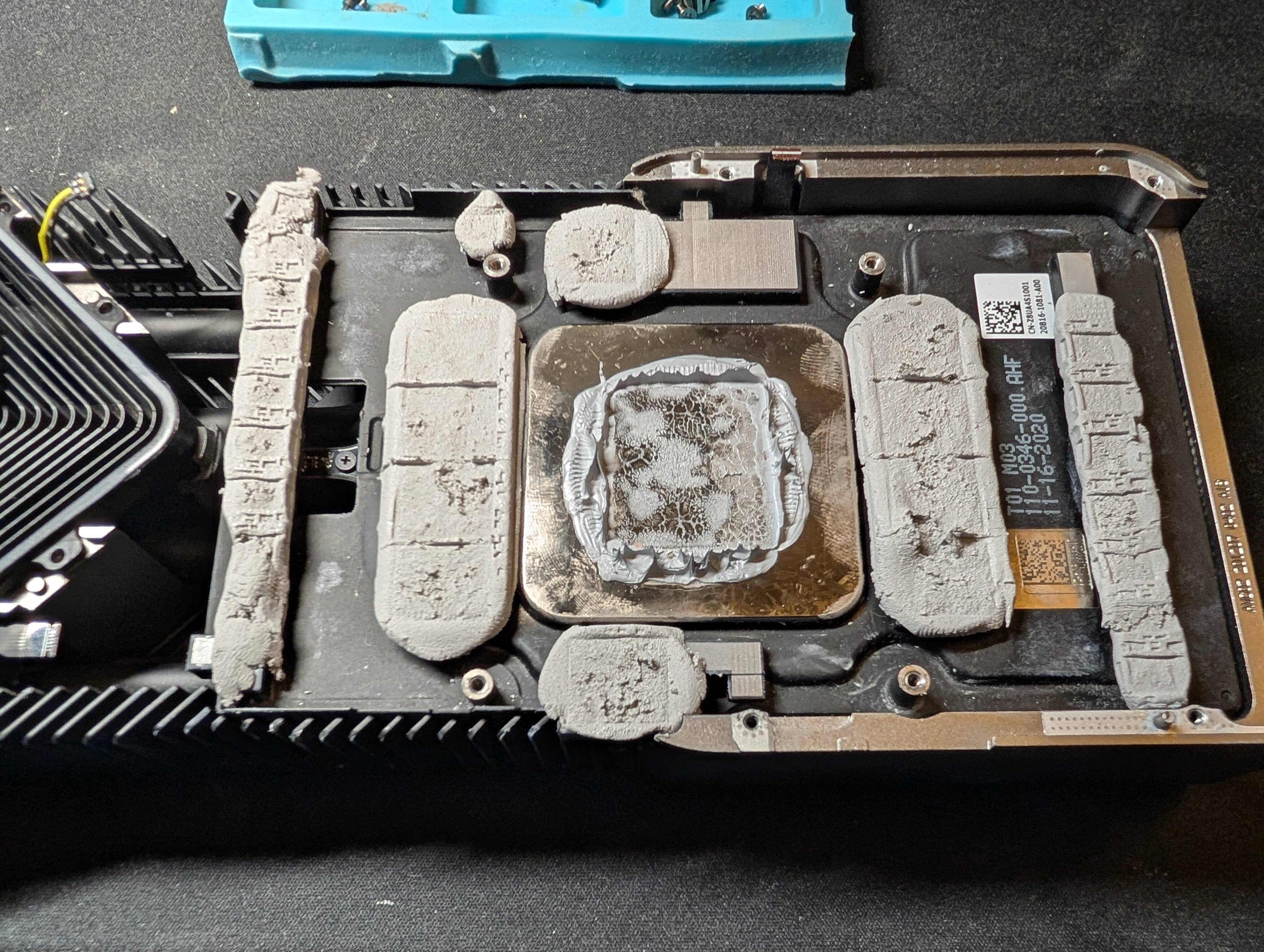

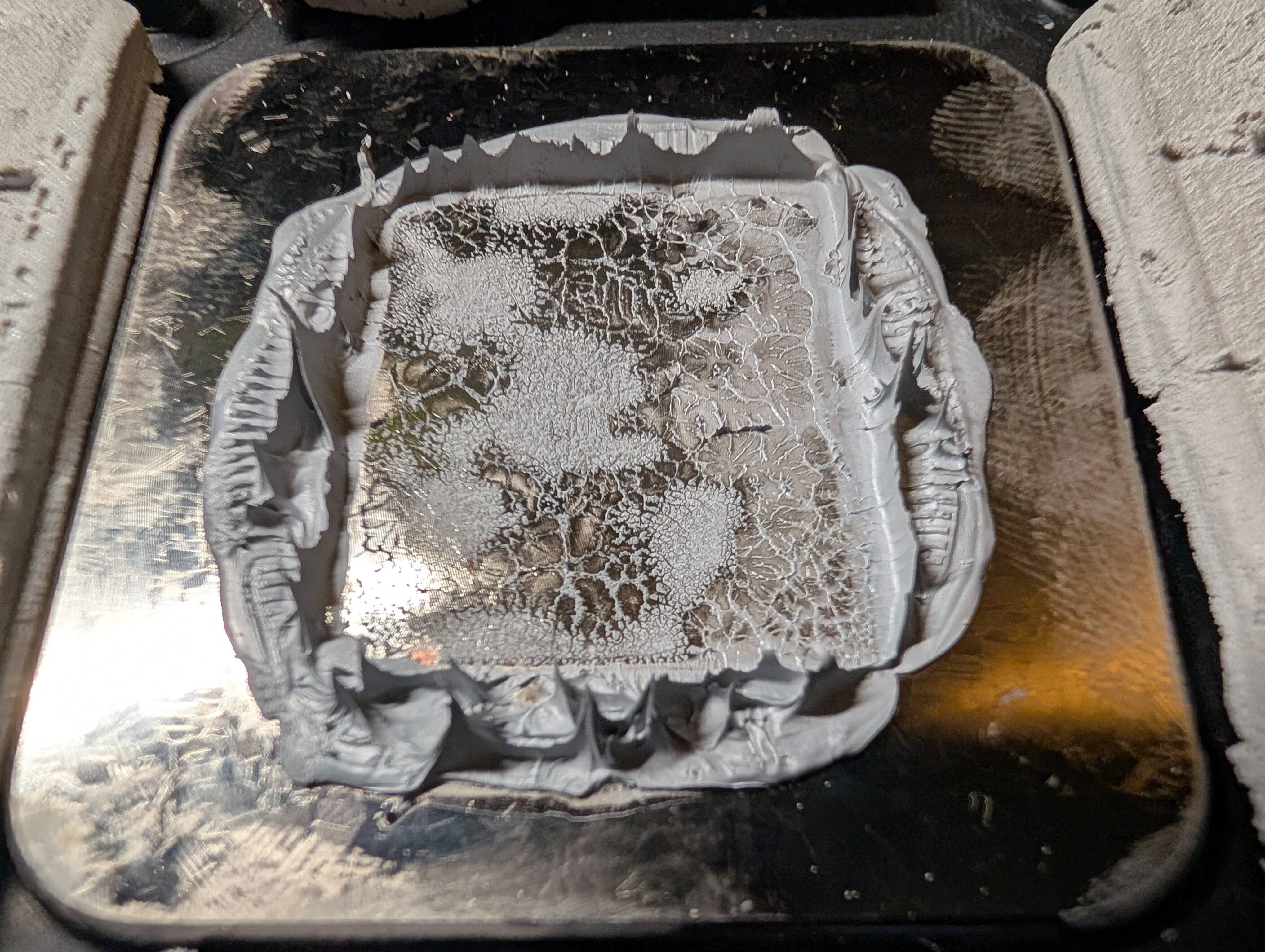

The cooler after the most recent attempt (the smooshed bit on the fets on the left side was all good before I knocked it out of shape)

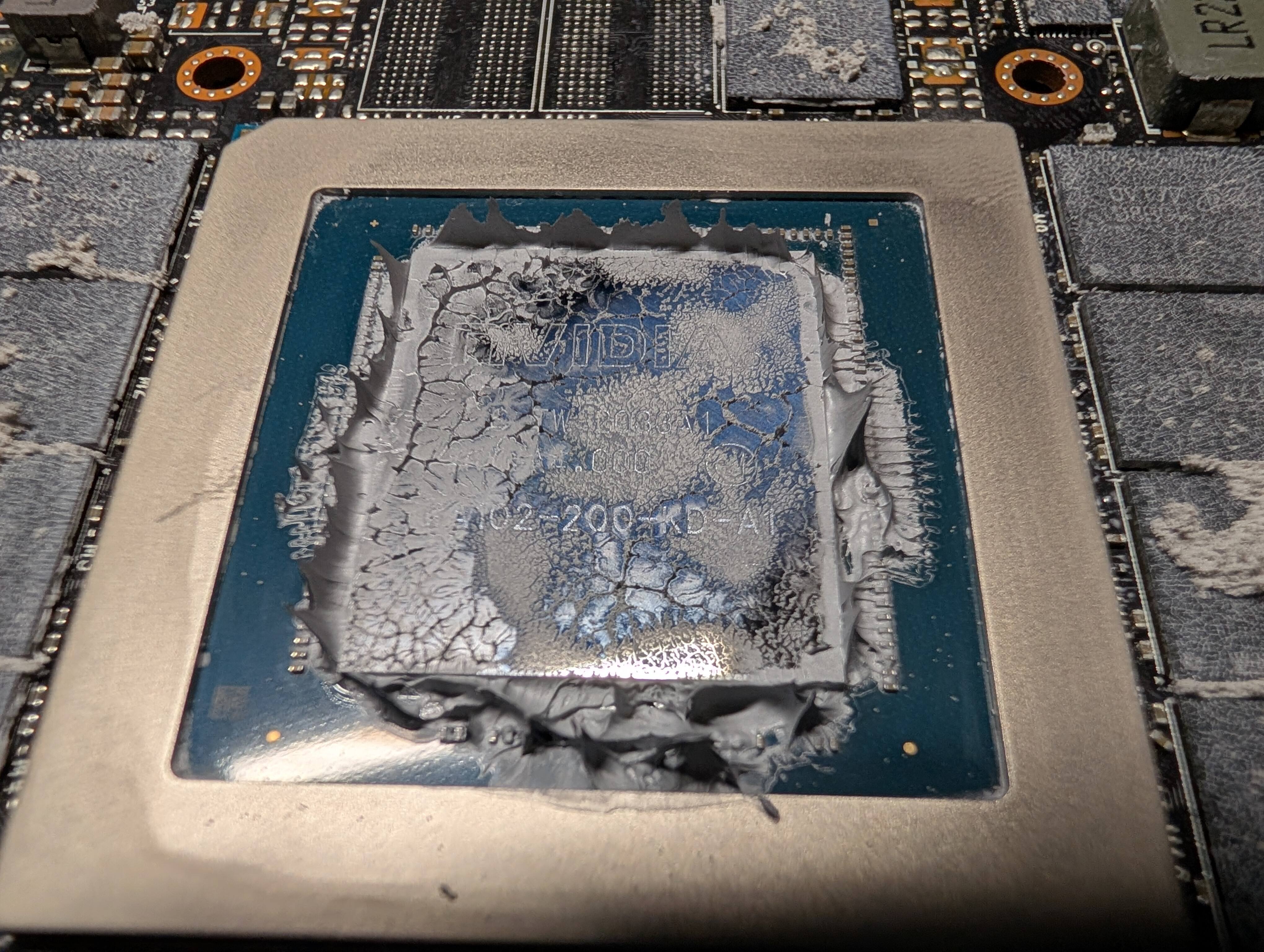

The spread on the die after unmounting, looks like uneven pressure on the left side for some reason :

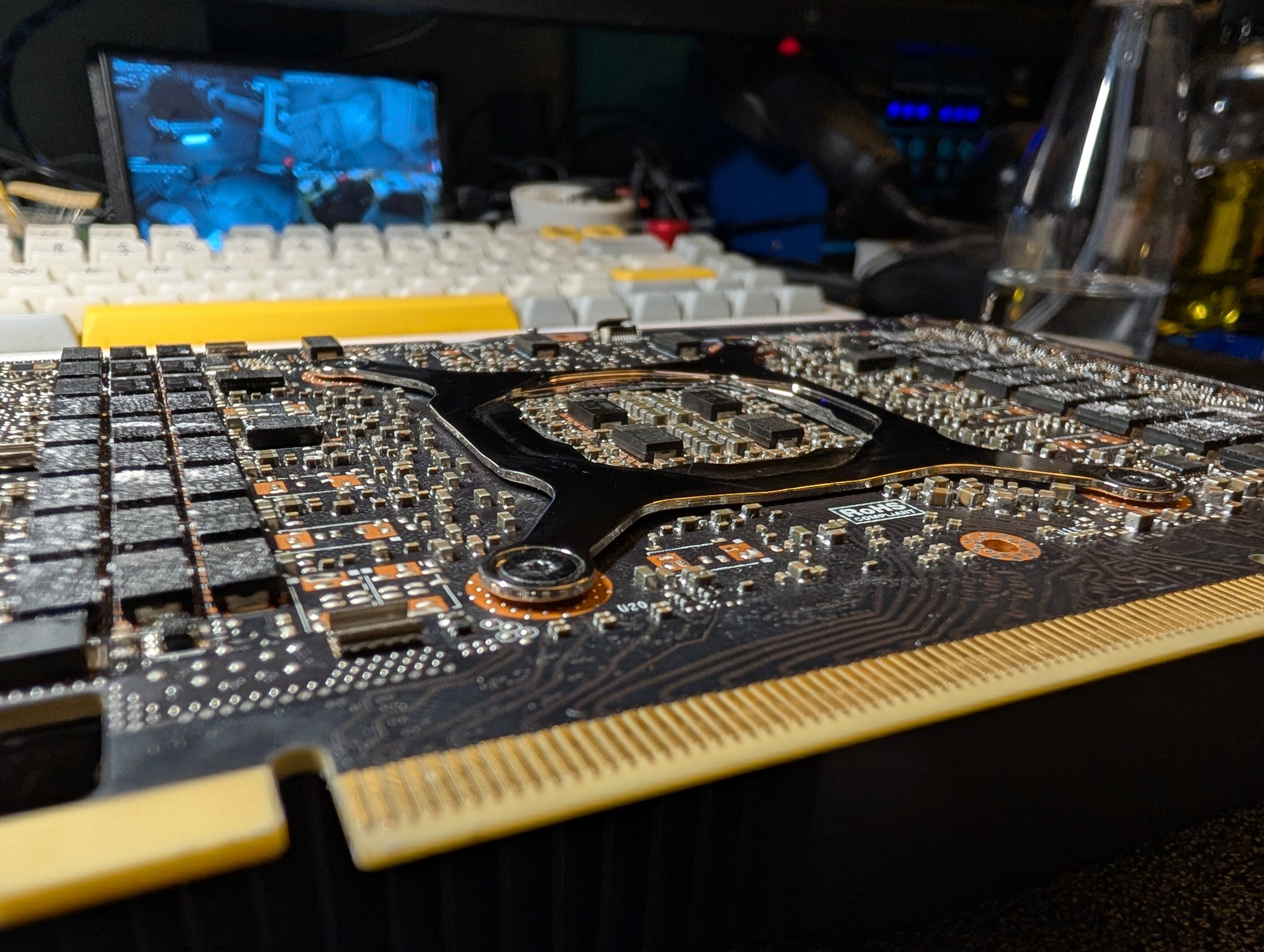

The bracket:

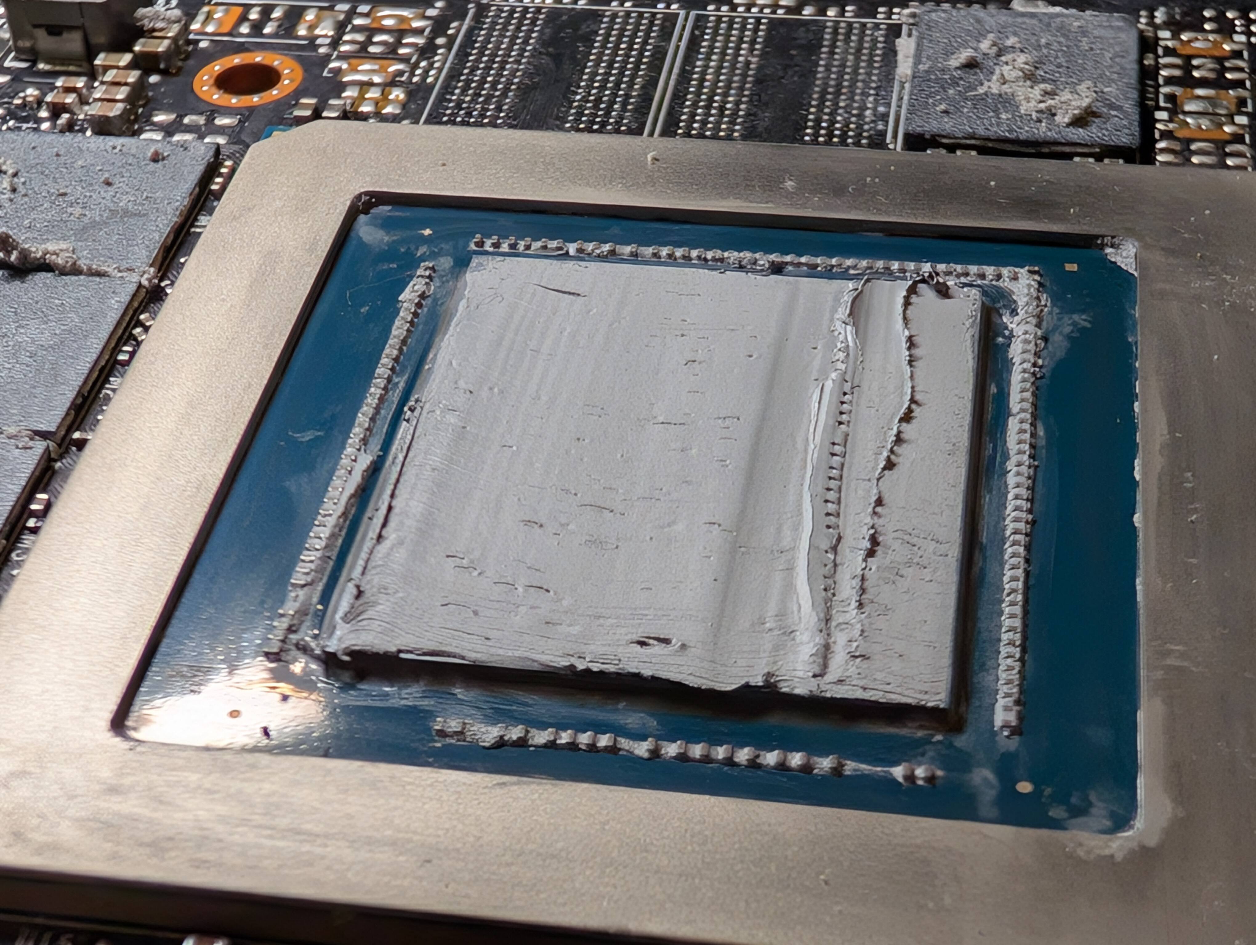

The re-paste:

3 hours ago, Oxious said:
I've tried a little thermal paste, a lot of thermal paste, a pea sized blob in the middle, a thin spread, a cross and 4 dots, everything I can think of.
You don't mention what thermal paste.
I redid a MSI MECH OC Radeon RX 5700 XT which are known to run hot.
Used the recommended 1.5 & 2mm pads, Gelid.
I heard that pump out is a problem with paste for the chip so used Thermalright TFX spread over chip with applicator.
Worked well for me, all temps are good even when stressed.
Is my cooler screwed? Has it bent out of shape somehow? Is this just normal with the VRAM dumping all that extra heat into the cooler?
I have read that improving the memory cooling can raise chip temps.

Posted (edited)
I used Arctic MX-6 which is supposedly quite good in regards to pump-out.
I hope it's that simple, although having it sound like a jet engine while gaming isn't ideal. 😞
I've added some more pics to my original post.
Edited by Oxious
It does look like you aren't getting good pressure on the left side.
Here it is running furmark:
