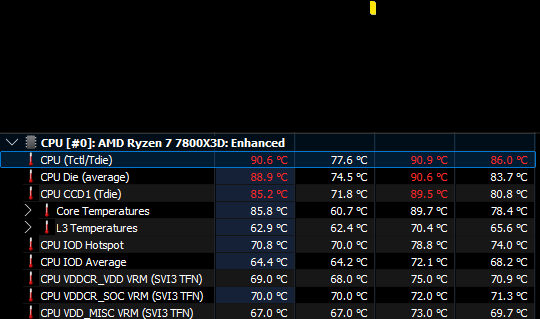

Are these temperatures normal?
Thanks
This was while running cinebench.
Also same thing with GPU and furmark.
Using Be quiet! Dark Rock Elite cooler with
Corsair iCUE 4000D case, built by a shop.
Internet seems kinda inconsistent with if this is normal or not. (Like
While some people on reddit think it should be impossible if things were right.)7800x3d-rx-7900-xtx-temperatures-v0-oc8moam4y3pe1.png
https://linustechtips.com/topic/1605583-7800x3d-rx-7900-xtx-temperatures/
Around 50C idle is pretty normal on 3D chips, mine is at 47C wirh a 360 cooler
And at full load under an aircooler it may just straight reach TJMax because the 3DVcache is blocking heat dissipation, chip ends up 20C hotter than a non 3D - that's what I see on my 7950X3D
So don't worry, in gaming you should be around 70C max

I see. Thanks
8 minutes ago, charva said:
I see. Thanks
And about the GPU, the 7900XTX is a hot beast, mine reaches max 72C but 93C hotspot *after* repasting it with PTM7950
After all it draws more than 400W overall!!
But I have a way bigger card and cooler (ASUS TUF OC), that explains my lower average temp
You may adjust your fan speed up a bit, but I know it's noisy...
Thanks a lot. Thought temperature was causing the USB problem so that's what led me here.
Guess not.
Guess not.
Nah, 80C is hot but within safety limits
Otoh ICue is malwarish, good idea to get rid of it ! 🙂
