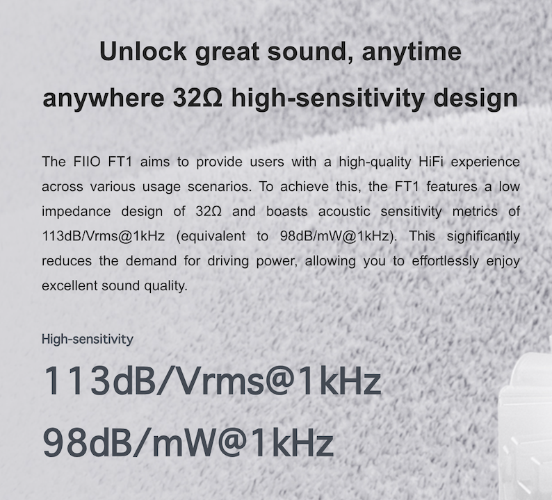

No amp necessary. They're as sensitive as most headphones.
21 minutes ago, eEmillerz said:
However, some people argue that the sound quality may improve with an amplifier.
That's how audiophiles get you to spend more money for no reason.
You might hear a sound quality difference. Whether it is objectively better, or you think it's better is up to you.
The general rule is: If you want better audio, you buy better headphones/speakers.
Hello, LTT community.
I just purchased a new pair of FiiO FT1 headphones, and I'm wondering if it's necessary to purchase an amplifier for them? I currently have a desktop with onboard audio, and I see sources saying you do not need them using this calculator (https://headphones.com/pages/headphones-power-calculator) as an argument. However, some people argue that the sound quality may improve with an amplifier.
Would you recommend for me to get an amplifier? And if so, could you possibly recommend me one - preferably for a low price and compatible with FiiO FT1?
Thanks all :)

Alright, thank you for your advice 🙂 I guess I'll try them out first and take it from there!

Thanks for your input! From the research I've done, the Fiio FT1 does not seem power hungry at all so onboard audio is likely good enough - for me, anyway.
