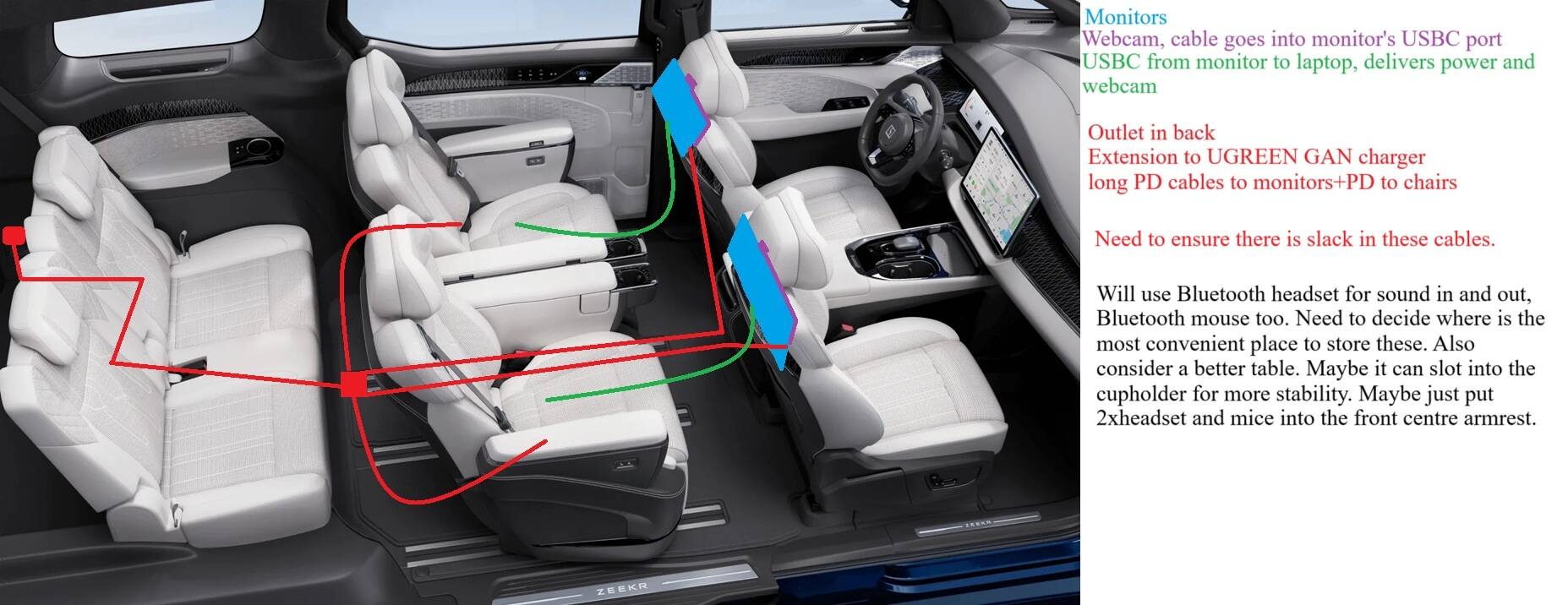

Tl;dr Below is my plan, providing feedback on it would be great. Additionally, I feel that it doesn’t have enough wireless charging options. I would like to somehow add a wireless charger to each of the middle-row seats. Many thanks 😊
Hi all
I previously posted about my current car setup that I use for work, I’m listing it here as reference. I also use this when travelling, it all fits into my backpack (aside from the generator): https://www.reddit.com/r/LinusTechTips/comments/1ihdaiu/travel_work_setup_part_2_working_from_my_car/
It does work “well” as it allows me to achieve what I need to do, work from the car, especially conferencing from the car as a presenter. The main drawbacks with this setup are the setup time itself, internet issues, and ergonomics. My wife also works from the car at the same time but doesn’t conference/present as much as me.
I am planning to replace the car due to multiple factors, and the Zeekr 009 is currently our top pick. I’d much rather drive a saloon (such as the Nio ET7) than an MPV but given the circumstances, this seems like the best option. I tried A LOT of other EVs before coming to this conclusion, a small fraction are mentioned.

  • The main amenity that the car doesn’t have is wireless charging.
    • There is 1 wireless charger in the front seat.
    • Another can be added with a phone holder that plugs into the OBD port for the driver.
    • There aren’t any for the middle/rear seats which is a bit annoying as this would be more convenient, especially as my wife and I usually have to carry a minimum of 4 phones between us (personal and work).
    • I have been trying to think of the cleanest solution for adding this, but nothing has been working well.
      • This includes using the cupholders with an aftermarket addon.
      • There are options to another cupholder so that each seat would have a cupholder and wireless charger, but these all look:
        • Jank
        • Seem flimsy
        • Poor cable management
        • Etc
    • I may need to just use wired charging, or eventually 3D print something more unique.

    • My solution is what you can see in the image:
      • Mount a portable monitor to the headrests of the front seats.
        • I have found options for desktop monitors, but this would be:
          • Too bulky
          • Likely quite dangerous in a crash
          • Desktop monitors tend to squeak when moved and this would drive me insane when driving
        • I would mount them using Magsafe.
          • The mount can hold over 1kg (the weight of most of these displays), if it’s not good enough then I can use 2.
          • The mounts I found do have the option to tilt.
        • It’s easy to find monitors that have the specs of what I need:
        • 500 nits of peak brightness.
        • 4k
          • Not essential, but nice to have
        • Touchscreen
          • I do use this feature
        • USB passthrough
          • Most have a maximum of 1 port, but this is all I need for the webcam to plug into this to keep cable management tidy
        • USBC power
          • PD from the screen to the laptop
            • Again, for cable management
            • I need to ensure that the cable doesn’t put too much strain on the port when travelling.
        • There are ones with higher refresh rates, I’m fine for 60, maybe 120hz for the occasional game
    • Due to the above, I would only need 1 USBC from the monitor into the laptop.
      • The monitor will pass through the USB and PD over a single USBC, keeping everything tidy.

I think this pretty much summarises everything! If you are able to help me with something that I’ve missed, or are just interested in the topic, then please do comment 😊
Many thanks!
