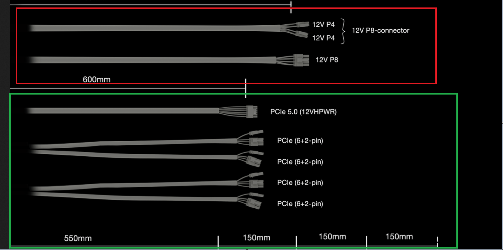

Another question is how would I get to use my current GPU RTX2070 which also has an 8pin port when the only 8pin is going to the motherboard. This is only temporary while I am looking for a 5070 Ti.
You need a different cable to the GPU.
do NOT mix the CPU power cable and the GPU PCIE cables, they look similar but they are completely different in terms of power.
These are the cables your Be Quiet comes with.
RED IS CPU POWER
GREEN IS GRAPHICS CARD POWER
The 12VHPWR is for modern GPU like 5070 Ti.
RED IS CPU POWER
So I will use the PCle 6+2 for the 2070 and the PCle 5.0 for the 5070 Ti yes?
That is correct 🙂

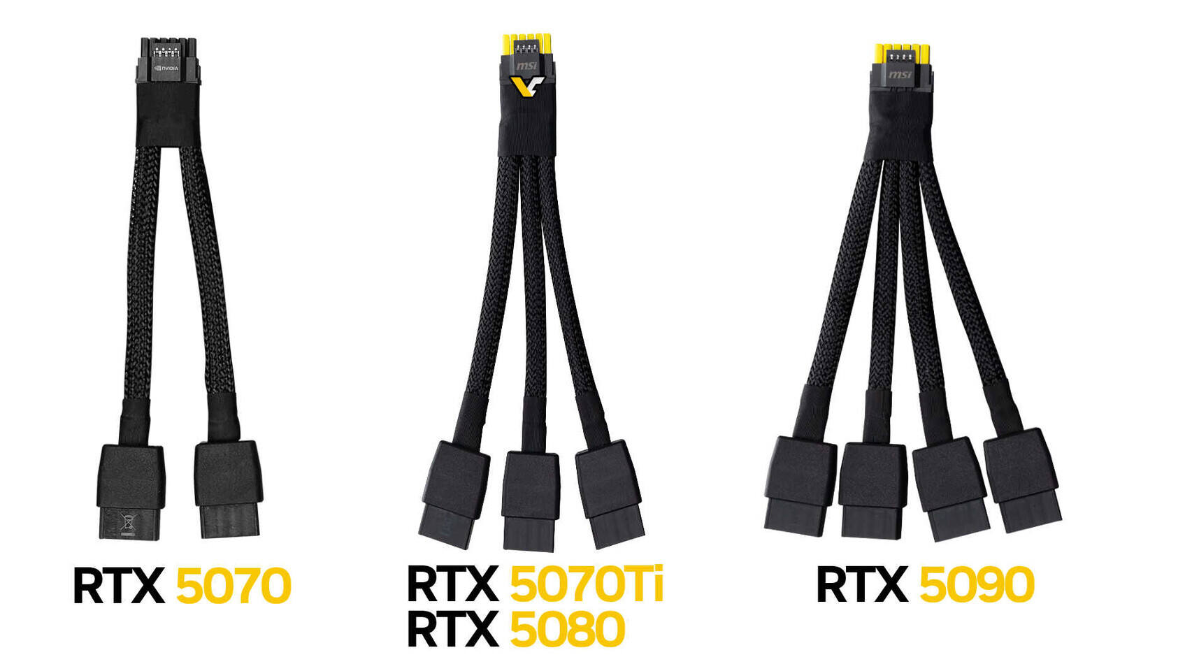

The 5070 Ti will also come with an adapter so you can use it with PCIE 6+2 cables for older PSU's.
But use the PCIE 5.0 for the 5070 Ti.
Adapter that comes with different GPU's for older power supplies that do not have the PCIE 5.0 cable.
1 minute ago, Hinjima said:
That is correct 🙂
