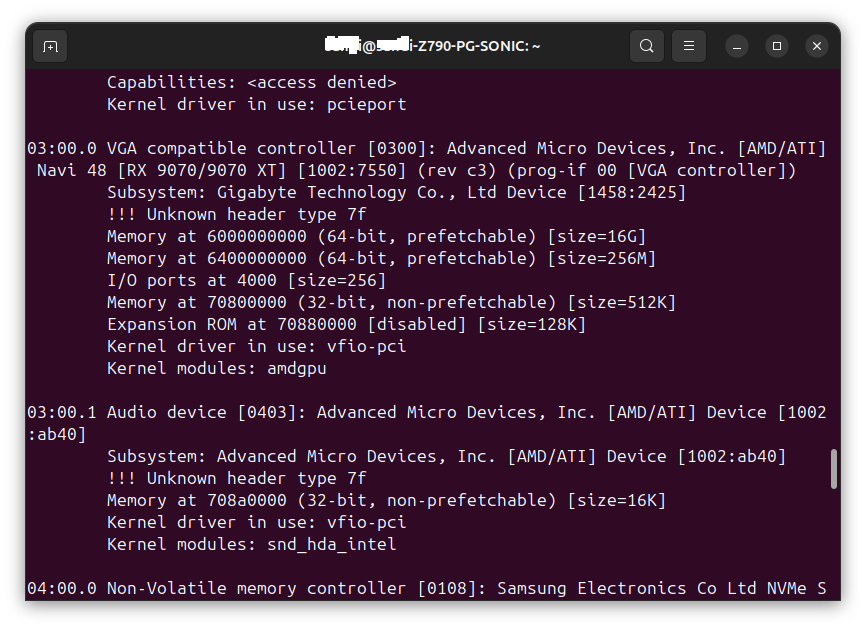

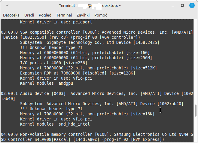

Is IOMMU/VT-d enabled in the BIOS and in GRUB on the host and did you pass both 3:00.0 & 3:00.1 together? What CPU/Motherboard are you using?

I have VT-d enabled in BIOS. I pass both. I have i5-13600K and ASRock Z790 PG Sonic.

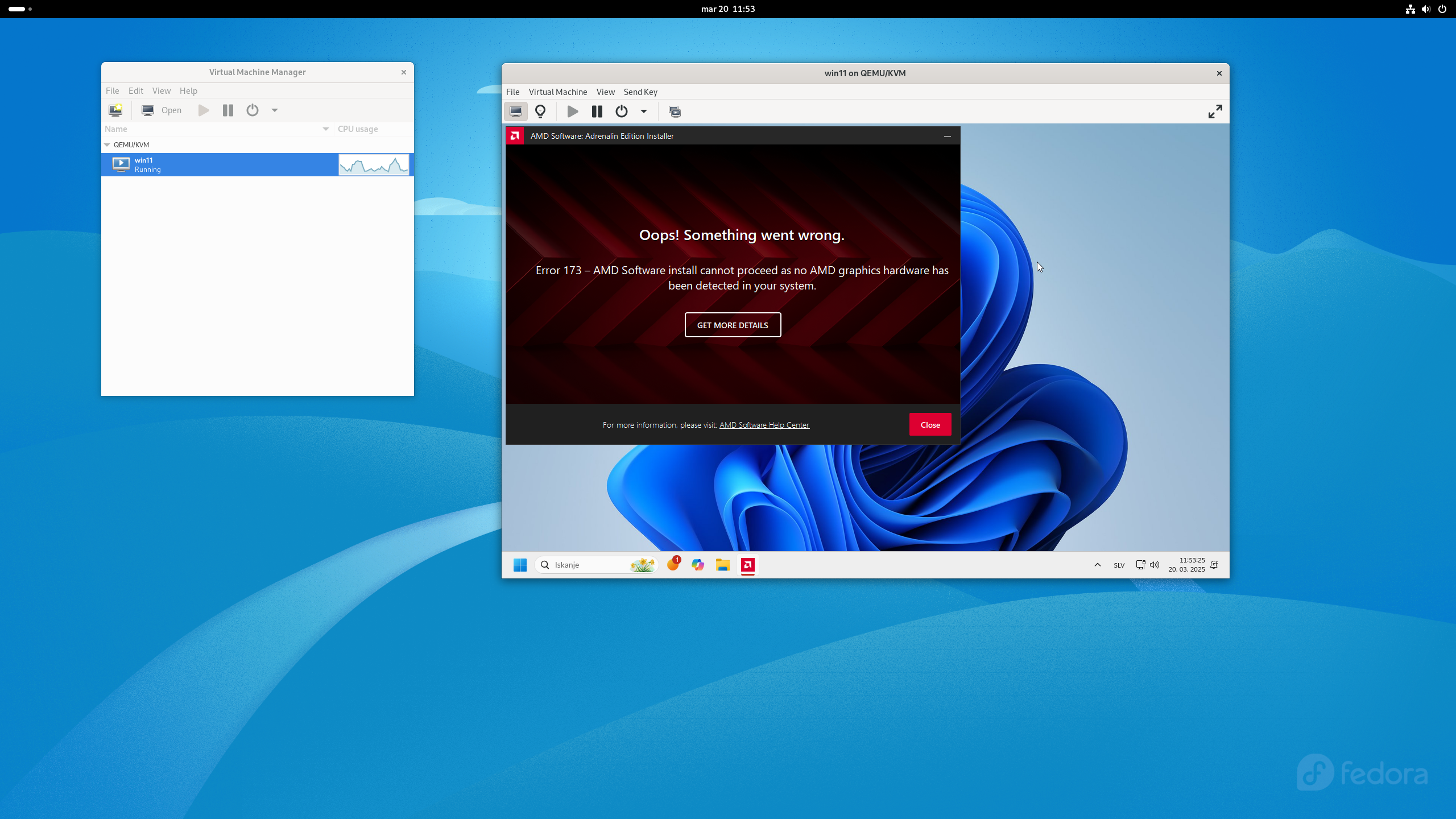

I got this screen when i install AMD Drivers (GPU Passthrough and Single GPU Passthrough):
This one may be related to the re-occuring GPU Reset Issues AMD has had. I can not however confirm that.
This is for the 7000 Series but it may be relevant here, https://forum.level1techs.com/t/the-state-of-amd-rx-7000-series-vfio-passthrough-april-2024/210242

If your VM can't see your GPU then you haven't passed it through. You need to provide more Information about your KVM/libvirt setup and verify vfio is attached to your GPU. As for your previous attempts have you even looked at the GPU reset issue I previously linked to to see if it can resolve your issue?

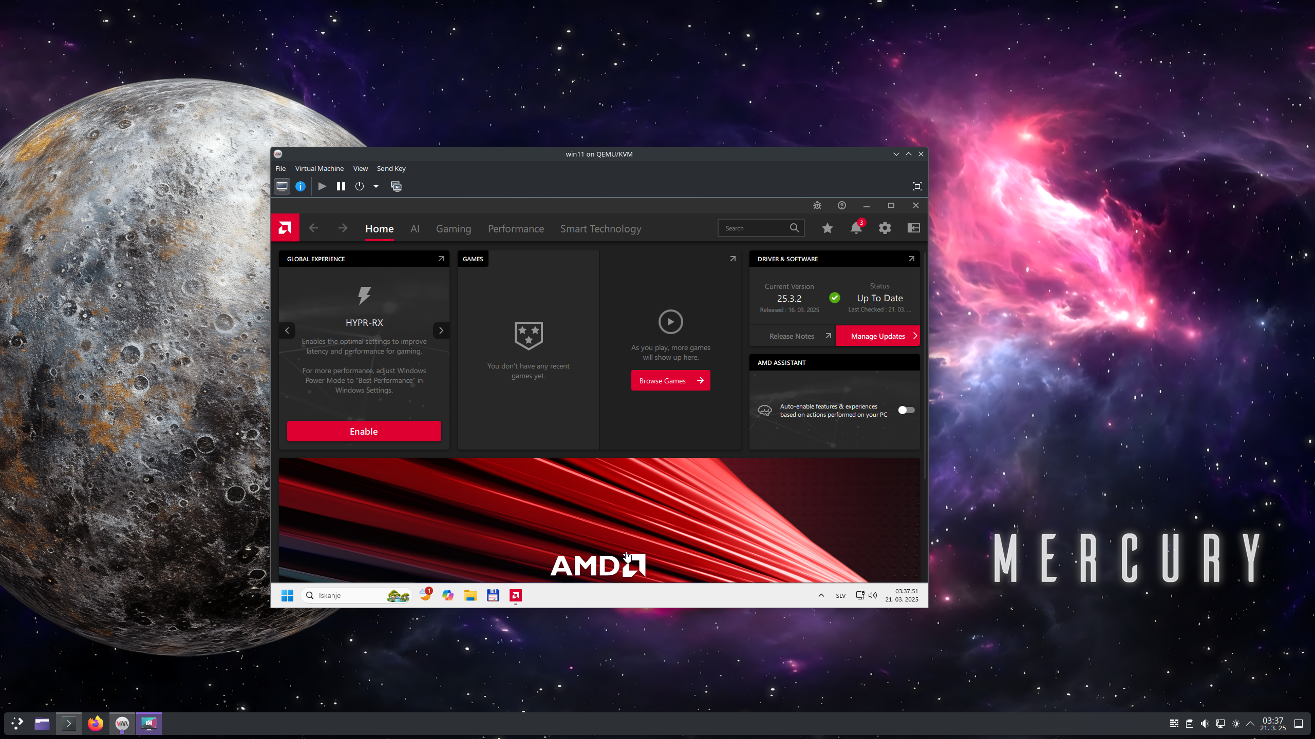

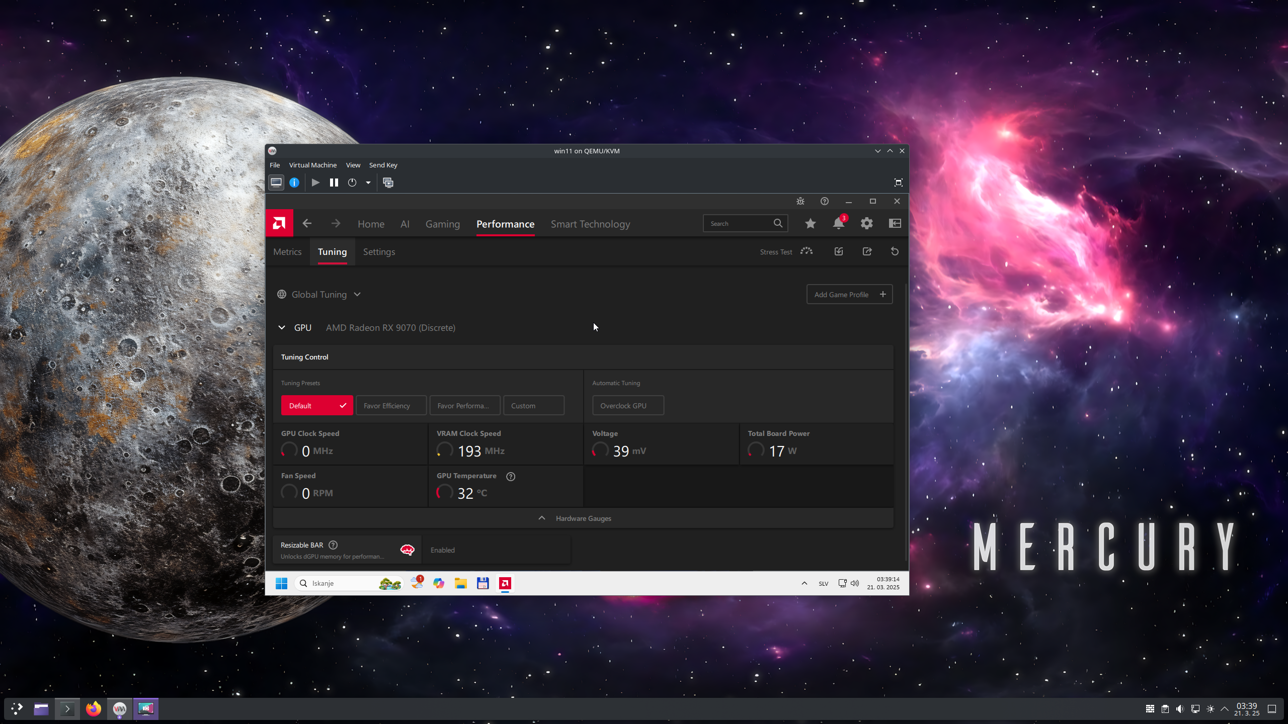

I figured it out for my set up. I'm not in front of my PC now. I will try to share my configs, Grub settings, driver rebinding steps and so on in the next few days.
I had this exact same issue with my 9070 XT. Everything worked fine using an actual attached monitor (no dummy plug, spice or RDP). As long as I stayed on the "Microsoft Basic Display Adapter" driver. The moment I installed the AMD Adrenalin driver in the Windows guest it did exactly this weird test screen looking thing.
The secret sauce was in the OP forum post linked by @Nayr438. According to the post, AMD drivers see that it is a virtual machine, and disables physical displays and adds virtual displays. That's why it is necessary to "hide" that it is a VM at all.
You could probably get away ignoring most of it since it seems like the reset bug is not happening for me (yet). I even left ROM BAR ticked and have Resizable Bar enabled. But, the parts you want to add (only add, leave the existing ones as is for now) to your XML is in the "features" section. As well as the QEMU Args at the bottom of the linked post regarding Resizable BAR if you have that activated on your motherboard.
<hyperv>
  <vendor_id state="on" value="0123456789ab"/>
</hyperv>
<kvm>
  <hidden state="on"/>
</kvm>
