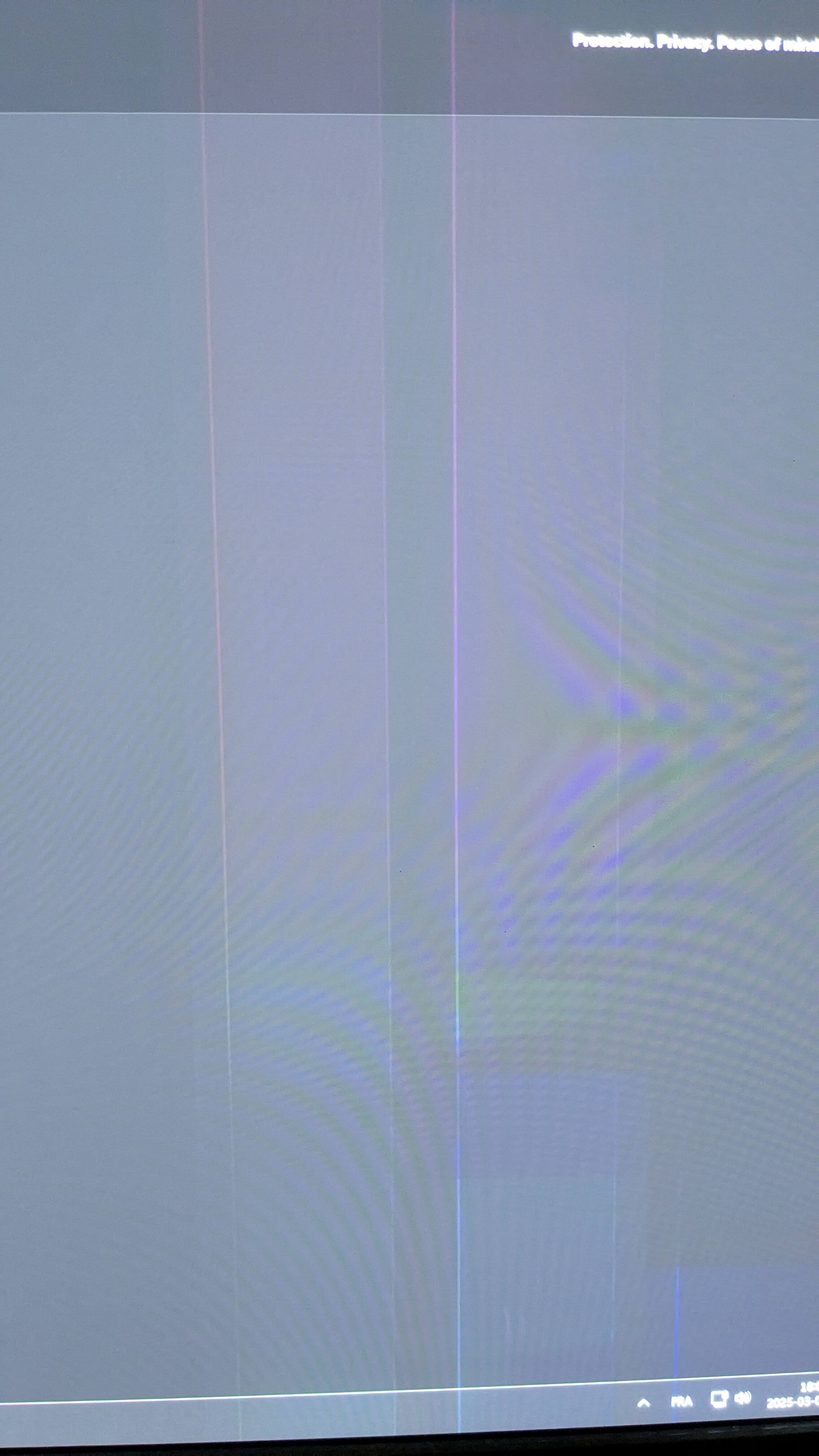

1 minute ago, Diooooo said:
Hello,
Any idea what might be causing those vertical coloured line on my PC monitor and is there anyway to fix this?
MSI MAG 321UP QD-OLED 32-inch QD-OLED 3840 x 2160 (UHD) 165Hz
Thank you
Could be a dying monitor or faulty.  Do you have anything else to plug it into like a console or laptop to check if it happens there too?
Have you tried different cables?
6 minutes ago, Diooooo said:
I tried HDMI. I am by default on DP. It does it on both. I just thought to check here before contacting MSI. It's still on warranty. Just bought it a couple months ago.
If its the same on both then its a panel problem.   If its still under warranty, send it back for a replacement.
There is a possibility the connector behind the panel is not making proper contact or came sliightly loose but I would imagine opening the monitor would void warranty.  Not that they would know but if something happened while opening it getting an RMA done could be problematic.
