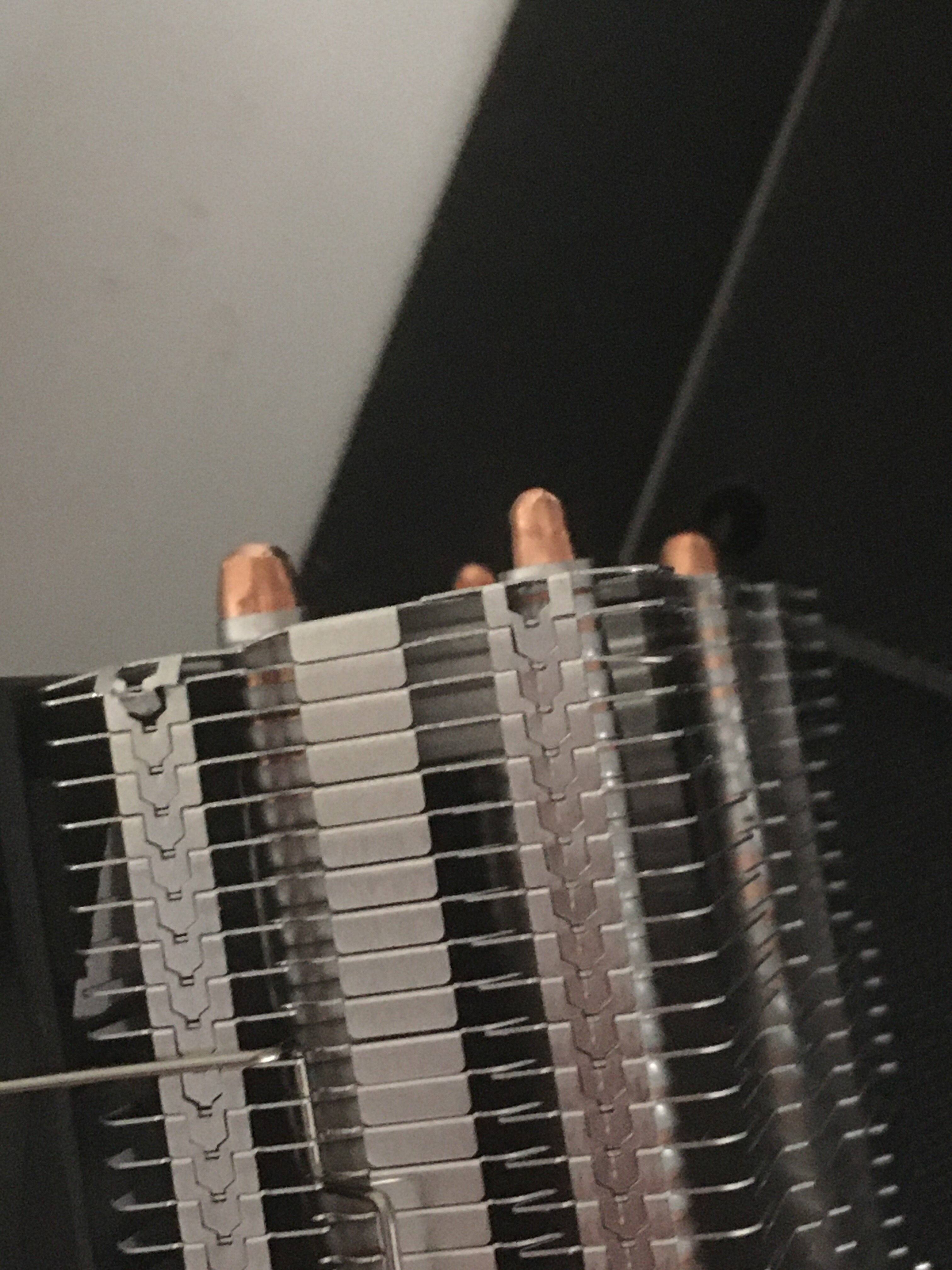

It is going tremendously bad for me. I am having the same issue here as I did here:
I returned the cpu cooler, they sent a new one, I verified that the four metal legs or whatever it's called are not broken and set to 1150 socket
I thought "This time, it will be smooth, the last one was broken", because why wouldn't it? I built a more modern PC, it was hard here and there but I got it to work completely.But still, it went the exact same way as in that post
I started off following the manual, putting the backplate on the motherboard, screws in, CPU cooler down

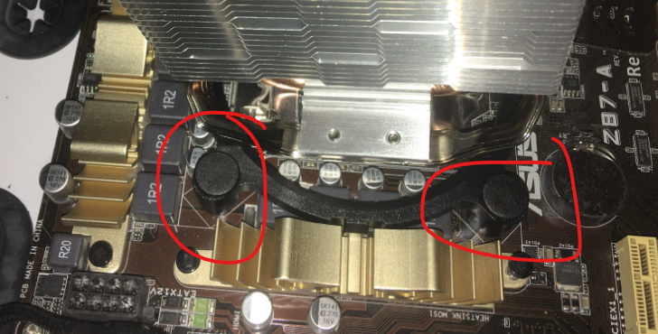

But the CPU cooler couldn't reach the backplate, it has two things that connect it to the backplate so it stays on the motherboard. I tried aligning it many times before removing it all, putting the backplate on the cooler instead, then on the motherboard, the backplate couldn't go into the motherboard now, I gave it the benefit of the doubt and assumed it's because the screws weren't in, so I took the backplate off, screws on then CPU cooler on, but still it doesn't fit. I applied pressure to one of the holes since that's what you do sometimes when building a PC, I managed to get two screws into the holes but not 3/2 diagonal ones, and now those two look like they do in the second image. My concern isn't the thermal paste drying out anymore, it's can I fix these bent legs? They're bent, not broken off.
I made sure to put the fan facing the RAM also.
It made contact with the CPU, so it definitely came down as much as it could.
Sure you can, just bend them back and pop them in to the hole. This used to be a very common problem with LGA775-115x stock coolers. I actually have a AG200 in my closet waiting to be installed on a LGA1700 system as well.

I bent it back like Levent suggested, went back to Manual order, so backplate first, it fits on the motherboard, so I guess I bent them back precisely and accurately enough.
Now, I have the problem as usual, but I found out that I can do this, I can attach one side of the cooler to the backplate. I took images of this, I did it on the other side instead of the one that I did it on in the images first, and gently applied pressure towards the dettached side, it made a creaking metal sound or whatever you should call it, I'd be suprised if I can with ease break metal, but I am not doing this without guidance, can I bend it into place? If you look at the angle the cooler is sitting, that's probably the maximum angle I would need to bend it on the other side to attach that side too. I didn't dare getting it back to the normal 0 degrees angle and I'd need to bend it further to attach it.
It's hard to get a good photo, but I can probably take a better one if these are too blurry and stuff.

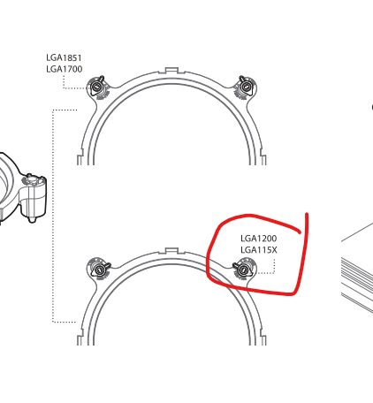

You need to follow the directions for the cooler. It's not fitting because you have half of it set up for LGA1700 and half of it for LGA115x like you need.
image.png.74d05044764718d893a515373929679d.pngimage.png.c0686890beab948d3ba6d796621aadce.png
See the difference in the two posts? The one on the right is in the LGA1700/LGA1851 position.
"See the difference in the two posts?"
"The one on the right is in the LGA1700/LGA1851 position." No, I set it to 1150, I'm pretty sure..
Could that one be one of the legs I bent back, and the positioning with the new legs was far enough from the original position to be stuck at LGA1700 position? I'll check it out right now and tell you if it's set to lga1500.
Do you know what to do? I tried attaching one of those clip things and twisting the cpu cooler medium hard into the other one but before I reached, something else happened.
if the thing you did is the picture above, then that will affect anything at all. If you are OCD about it, you can even attempt to fix it.
Are you saying that it doesn't matter that I broke it there?
its not broken, its just pushed in. Happens to best of us, I think my eSports 34 is also bent like that. I didnt even remember it until I saw your post.
It's still reasonable frustration at Deepcool if you have to suspiciously twist the cooler and guarantee that happens. I didn't even twist it all the way necessary to attach it, who knows how much more would happen then?
