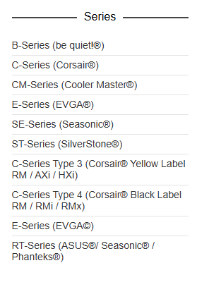

My new PSU is a Corsair RM1000e but I don't see that series listed on the CableMod website as an option for cables.
What am I looking for?
Type 4.
https://www.corsair.com/us/en/s/psu-cable-compatibility

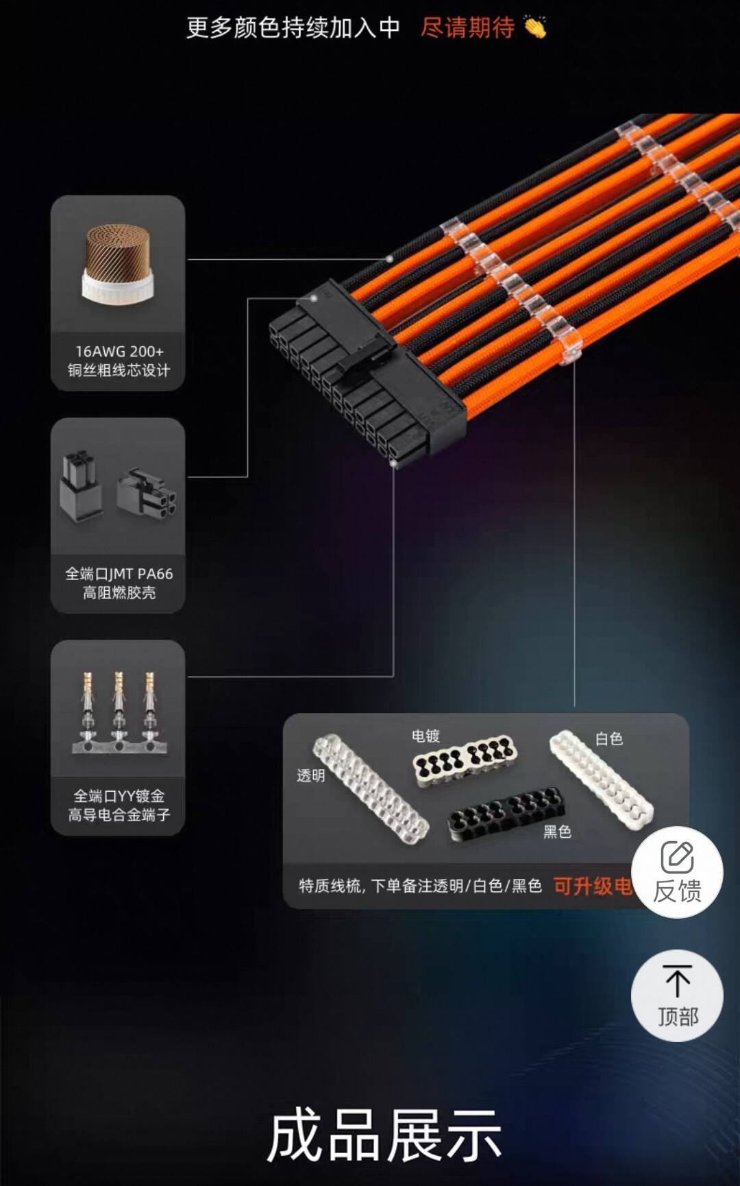

Now, you have a Corsair Type 4 PSU. Cables sold by AliExpress vender and ones from CableMod won't have that big of a difference as long as they have Corsairs Type 4 pinout, and usually they should be the same guage vs Corsair original cables if not thicker (if I remember correctly the lower awg number actually is thicker, do check that information, I remember Corsair uses 16 guage and 18 guage).
Some custom cables may add capacitors to combat piky power draws from 4090s (Good quality PSU already have then inside, so the rule of the thumb is, if original cables came with the PSU don't have them, then you don't need them)
Anyway, copper is copper, the only difference would be connecter plastic/pin quality which may came from the same suppliers.
The key is make sure the vender/cable makers using quality materials (given copper is quite expensive these days), which you won't really know without reading recent reviews if there is any.

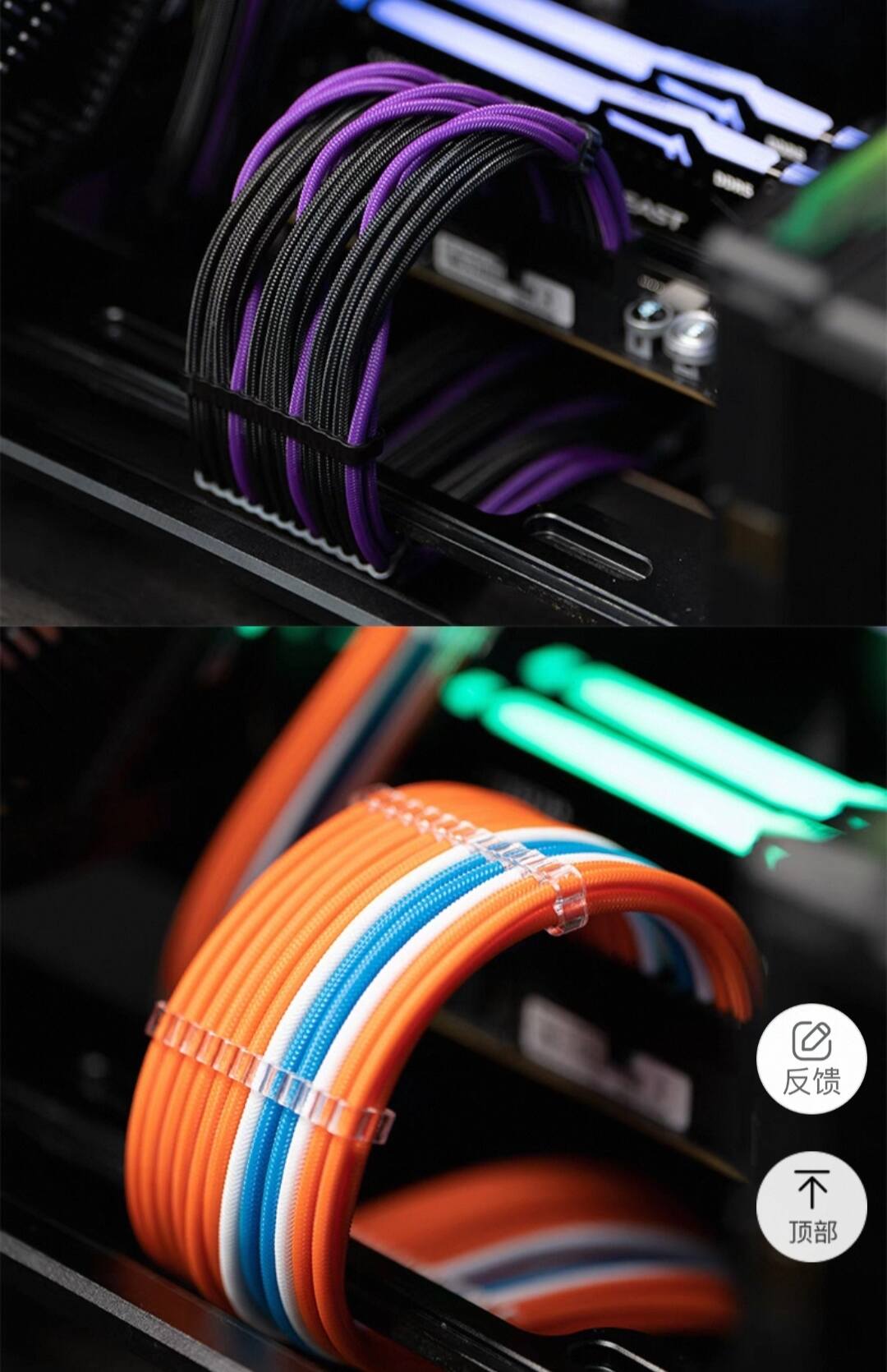

AliExpress (or other third party) venders may even allow you to customize the cable length to fit your particular case, which is how those neat cable managed cases are made. Not to mention they offer cable colors that is not made by CableMod.
Here are some examples of options for a custom cable maker on Taobao(AliExpress) which I used with a RM850e powering a 3080 with no problem (Custom length, all black. Whole set for <40 bucks with shipping).
Not sure if they ship to your country by they are called HZMOD.
