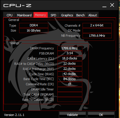

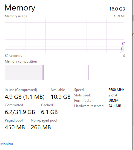

I've recently discovered that my 32gb kit of Corsair Vengeance DDR4 3600mHz has been detecting in BIOS and Windows as 16gb, and seemingly at half the speed. When only using one stick, it also rates each one as 8gb, despite them being 16gb sticks. I'm not sure when this started happening, but I noticed since I just got in a new PSU in prep for an RX 7900xtx I just ordered (upgraded from 750w to 1000w). I'm a fairly experience builder, but not really an experienced troubleshooter, and this one has me stumped. I am sure that when I built this computer, it read at 32gb 3600mhz

It's not half speed, It's just the difference between MHz and MT/s. Sellers market these RAM as they are 3600 MHz but actually they are 1800 MHz & 3600 MT/s. You can check the difference on Google.
Task Manager showing the speed as MHz is a faulty as well. They fixed it on last updates and changed to MT/s.
RAM shows as 16 GB is weird tho. Try to run on Live USB and see if it's becuz of your current Windows installation or not.

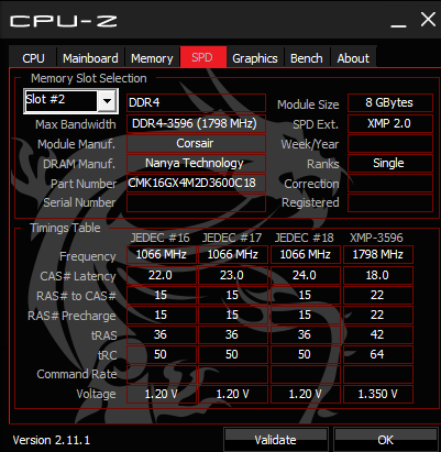

The part number (CMK16GX4M2D3600C18) is for the 16GB (2x8GB) model found here:
https://www.corsair.com/us/en/p/memory/cmk16gx4m2d3600c18/vengeancea-lpx-16gb-2-x-8gb-ddr4-dram-3600mhz-c18-memory-kit-black-cmk16gx4m2d3600c18
Are you quite sure that you didn't pick up the wrong one by accident? Do you still have the box, or invoice?

I don’t, I built this PC about 2 2 1/2 years ago, but you’re right I think I was just being stupid. Could’ve sworn I had 32gb originally, and when I read the sticker on one of the sticks it said 16gb. Now that I’m looking at it closer it says 16gb (2x8gb). Chalk this one up to user error! Thank you everyone for the replies!
