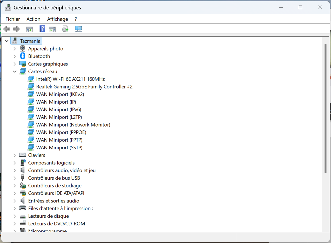

1 minute ago, emosun said:
how bout the actual drivers the hardware needs , are those installed?
Sorry, how do I know exactly what ones to check for? I’d assume everything is installed as it was working two days ago.
I’ve seen limited posts on this issue for my motherboard but they seem to be people installing for the first time.
I second reinstalling Windows, obviously quite understandable if you only want to that as a last resort but it fixed my crappy old gateway laptop when Bluetooth decided to magically not exist. Also make sure you have the drivers that your particular motherboard needs (you can load em on a USB stick).
