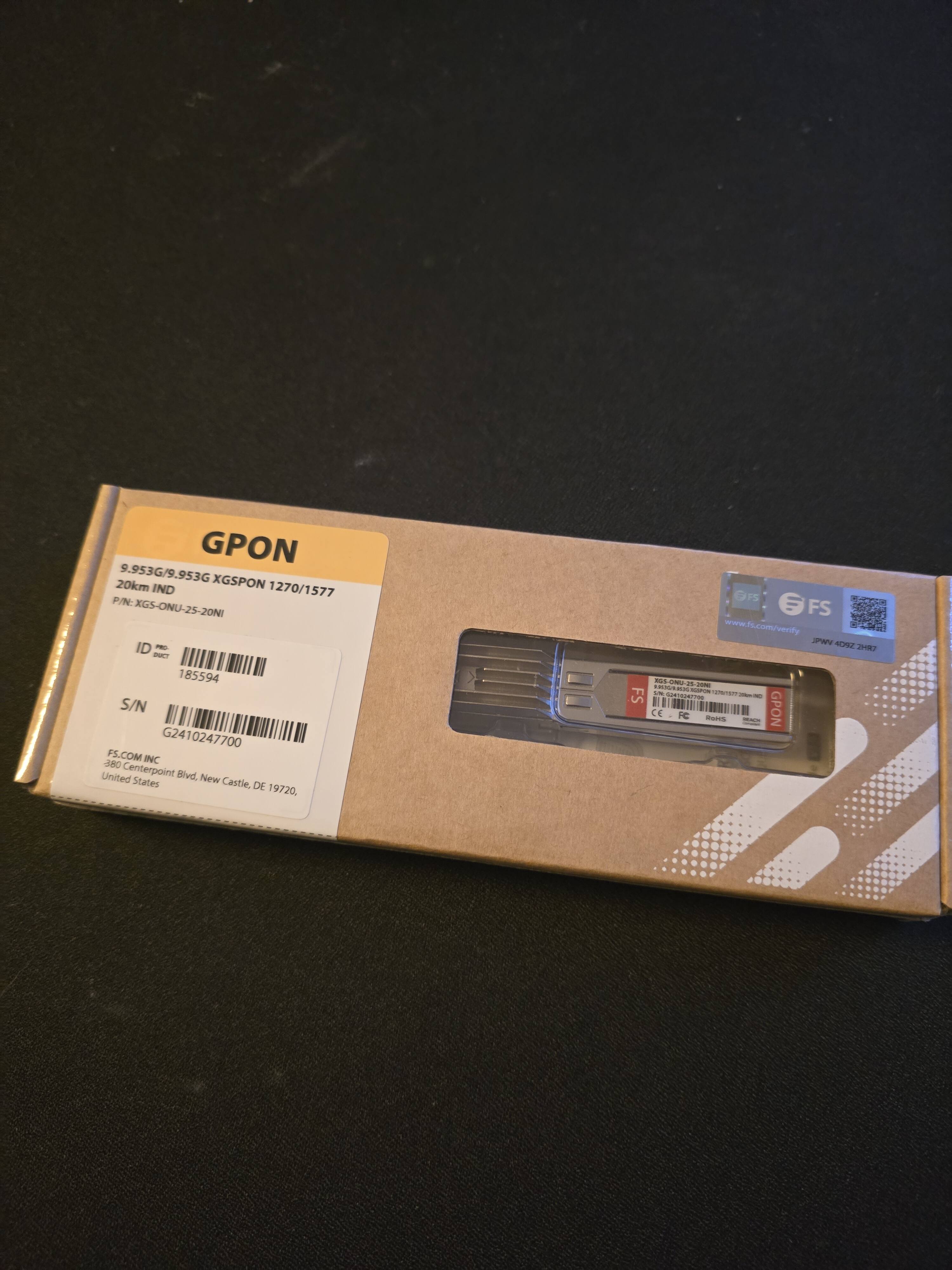

Hello guys, i did order a 10G ont sfp module for directly plugging to unifi pro max instead of a Nokia ONT+ device, Today it arrived but it has 11 number serial number instead of my isp wants a 12 to 16 number of serial number, how do i need to change the serial number ? the product is https://www.fs.com/uk/products/185594.html

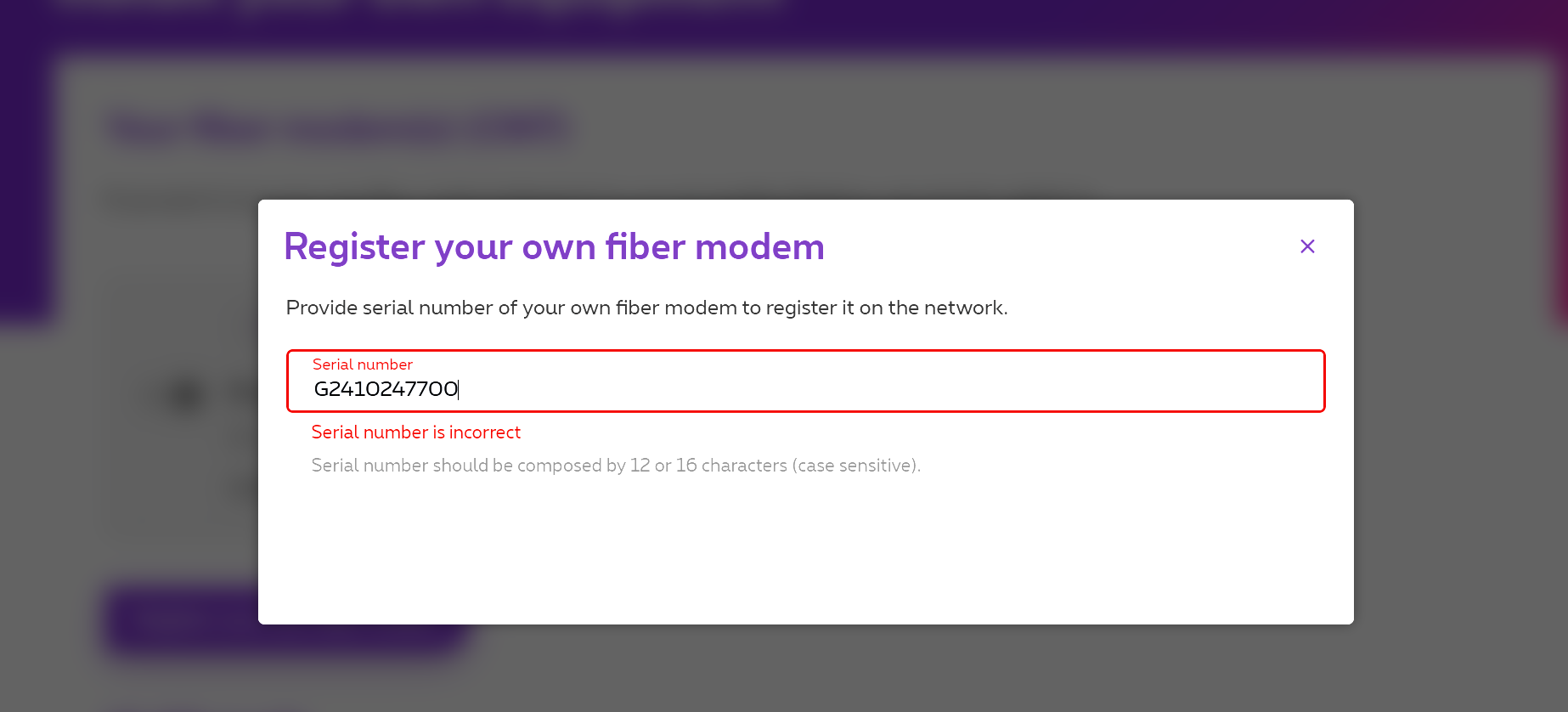

INSTALL YOUR OWN EQUIPMENT is the website of my isp, i logged in to my account and i need to add the new ont serial number here but i cant do it, SF has 11 karakters but isp wants 12 to 16 , IAM NOT SURE but i need to telnet to the devie and change seriam number i think but iam not sure

Have you read the Q&As on the page you linked? The serial number can't be changed. Apparently the SN on the sticker is not the one you need, you need something referred to as GPON serial number.
Quote
Yes, this module is compatible with Netgate pfSense 6100. Note: This module does not support SN modification. If you want to use this module for XGSPON connectivity, you need to negotiate with your ISP to add the module SN to the OLT's authentication in order to gain access to the network.
Hi, Karl. This XGS PON stick can only be authenticated by modifying the MAC address. Modifying the serial number is not supported currently.
Sorry, the SN doesn't support modification; otherwise, the module will not function.
I asked my FS sales rep for the login credentials where the username is the GPON serial I needed. The serial on sticker off the module is not the serial number you need to activate the ONU.
After I received the information I contacted my ISP and provided them with the GPON serial number. After a short wait they performed the change to the network. After that I could insert the ONU module in my router and connected the fiber and everything was up and running in a minute.

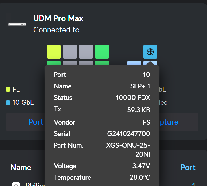

i did enter the GPONXXXXXXX Serial number to isp website, the old one(Nokia ont) disabled but i dont get ethernet from the sfp, any special things to do in Unifi ? or anyting within Telnet to SF SFP+ Module ?

  • XGSPON Serial Number: I’ve located the correct GPON serial number and entered it into my ISP’s "Install Your Own Equipment" portal. My old Nokia ONT was disabled successfully, but I am still not receiving Ethernet from the SFP module. Even tho Unifi sees the Module connected (picture)
