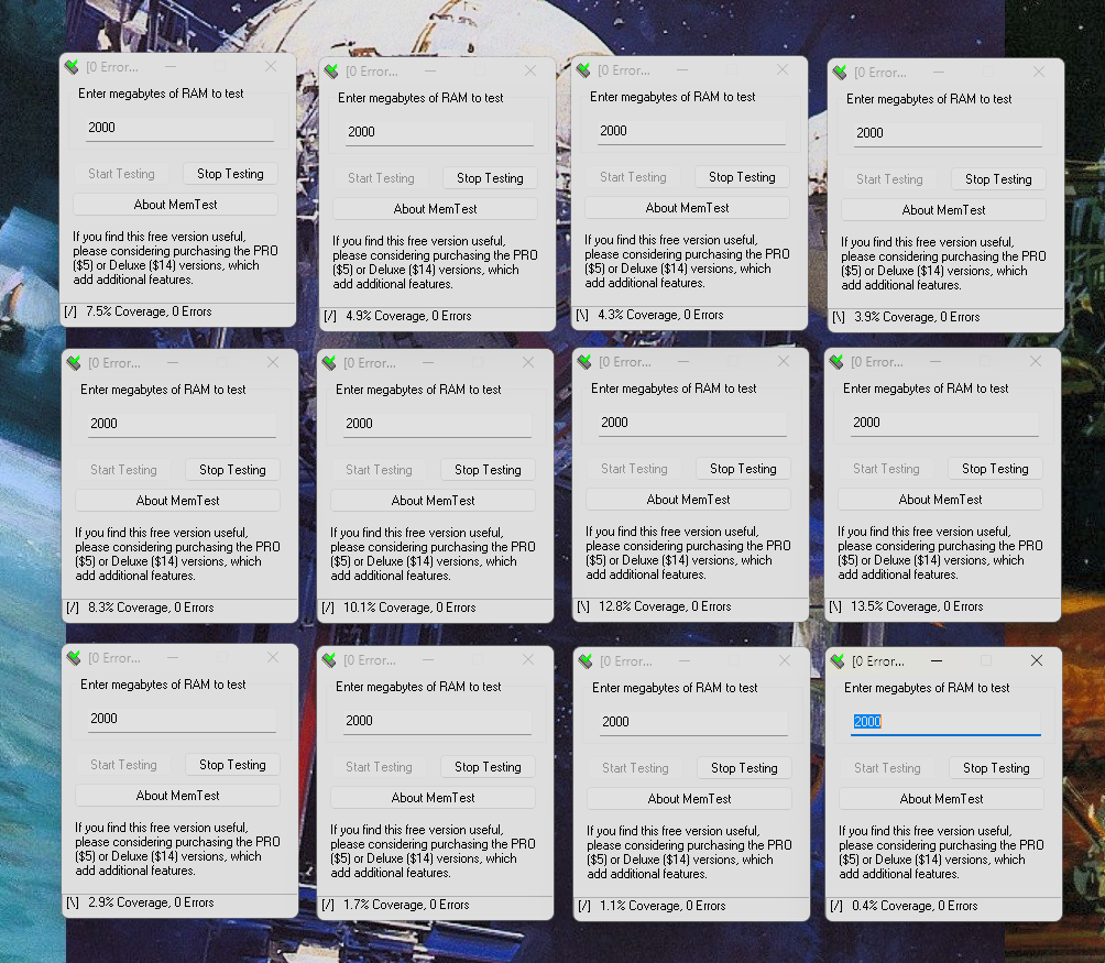

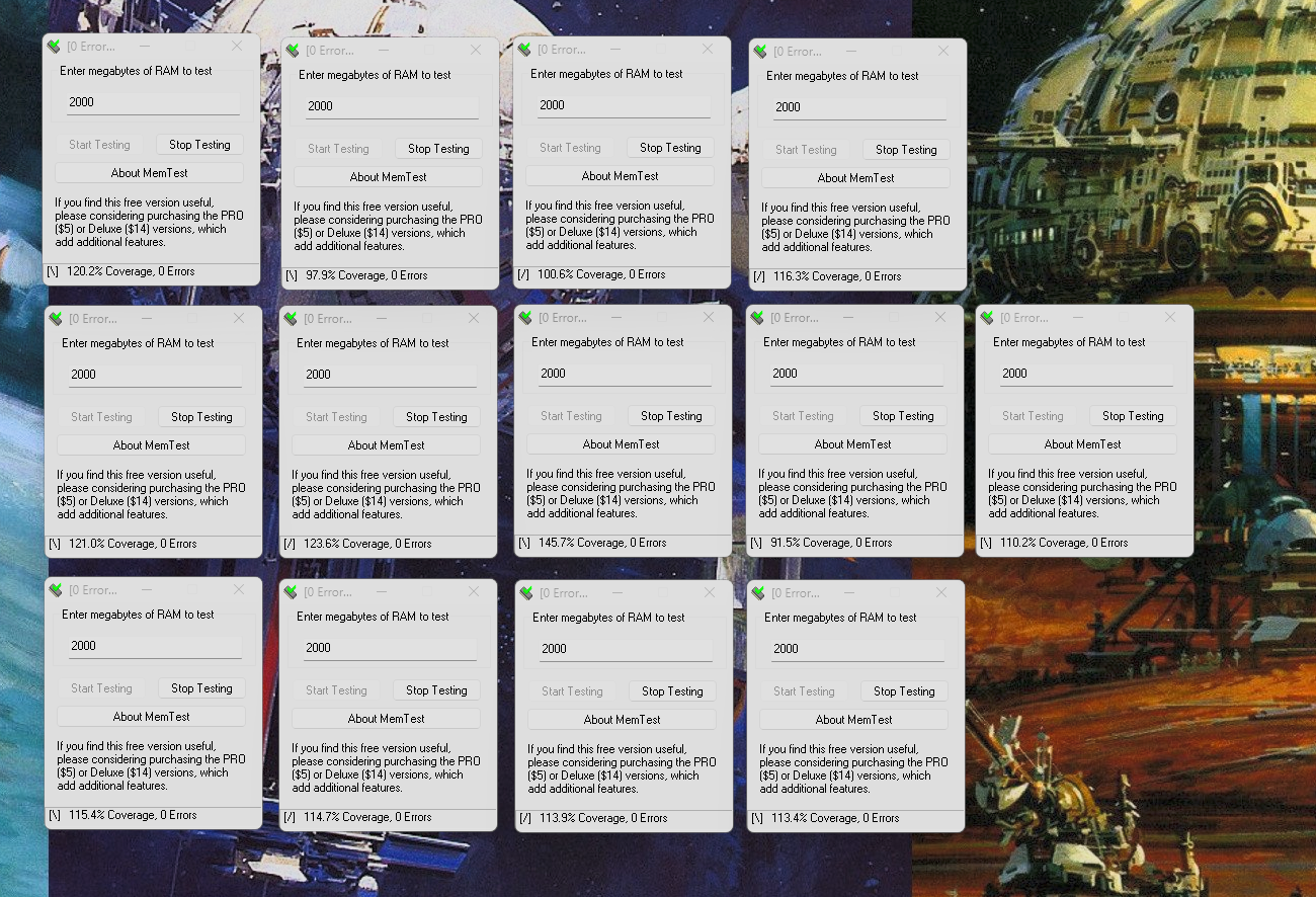

Did you test your curve? Did you test your memory settings?
Your system isn't stable, and that is why your driver keeps crashing.
I don't even crash under any other condition, though. I've no issues with any games. Also, I remember testing these settings for hours with CoreCycler, y-cruncher, 3DMark, and Furmark. Right now, I'm using loser timings with default EXPO and lower curve.
Thanks for the response.
