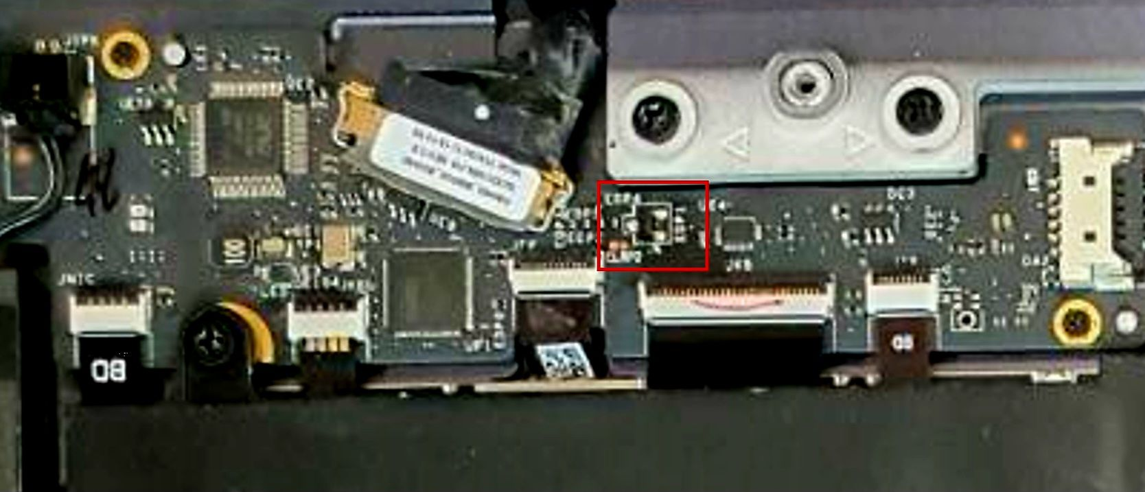

Now Asus is saying the unit was soldered so they won't fix the LCD and also they said there is no flicker. This issue happens often times but not always but the burn in is present at all times.
What do you guys recommend?
I asked them if the soldering happened since the last time I visited them and if not why they didn't bring this up before when I visited there more than 10 times.
I don't trust they tested it thoroughly when they gave the unit back without connecting the CPU fan the last time.
Can you sue them in your country? Get it repaired properly by a 3rd party with documentation and sue them for the repair costs. In the US this would probably be a small claims court case and if they no-show you win by default. I don't know the details of your legal system but it's something to look into I guess.
Yes I am looking into small claims court. But the issue is maybe it won't be possible to find the same quality screen. They need to provide me with an adequate replacement. They are saying they can't do that because I don't have warranty which they removed from day 1.
They caused me so much down time.
They sent this image claiming CID:
Before they said this:
"We can confirm that photographs from the initial repair show no signs of soldering."
now they say this:
"To clarify, the photographs from the initial repair do show signs of soldering, as highlighted in the attached images. These soldering marks, observed during the recent inspection, appear to have contributed to the current issues."
Either the image is low resolution or it's not loading right on my phone but that looks like a soldered SMD component and that's how that should look, same as dozens I've seen on other boards and PC parts. Are they saying that you soldered it? Are they admitting their factory production was so sloppy they can't tell between professional and amateur? Are they admitting that a manufacturer defect is the cause?
