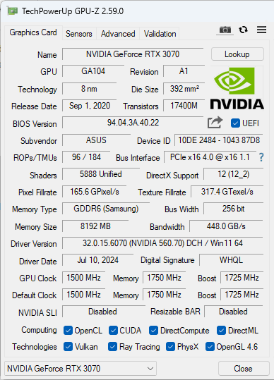

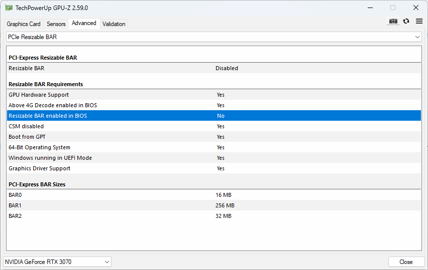

I just switched from a Radeon 6700 XT to a Asus 3070 in my system due to unlimited driver issues with my Radeon card. I've been trying to set up resizable bar support, however everything I've tried isn't working and I want to know if I should return the card and get a different one. Below is a list of everything I've tried and I cant think of anything else. Built the PC myself about 2 years back.
-Above 4G decoding set to Enable in bios, Re-sizable bar support set to Auto, and CSM disabled

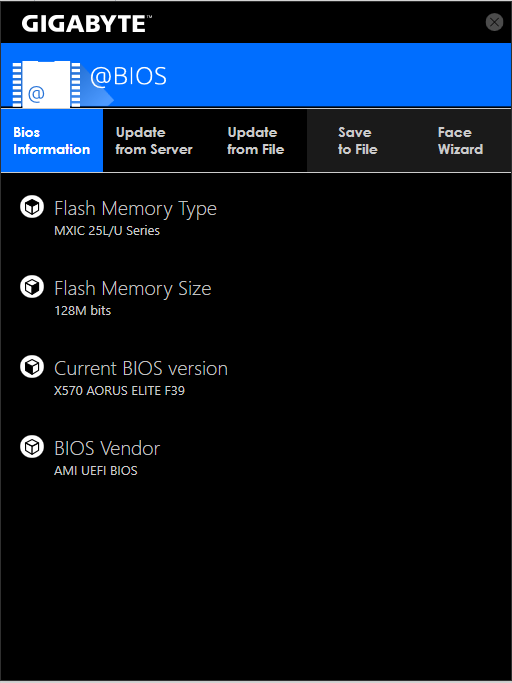

-reflash bios to F39

As you can see I've tried about everything I can think of and it still isn't enabled and I have no idea why. Want to know if I should return it before the window closes so please help ASAP and let me know if there's anything I haven't tried yet please and thank you.

I'd assume it's just a bug with the BIOS, and you might need to do something like disable then re-enable ReBAR to get this to work.
Realistically though, on 30 series cards having ReBAR enabled or disabled makes very little difference for performance (from what I remember, it's something like a 3% improvement at most) so if turning it off and on again doesn't fix it, I just wouldn't bother doing any further troubleshooting.

Gigabytes own BIOS is buggy. You have clear CMOS and set everything again on first post.

Try downgrading the BIOS/clearing the CMOS as others have said.
I just cleared the CMOS and set back to the correct settings in BIOS to no avail. Still stuck.

Generally speaking, if it didnt work then you probably didnt clear it properly. Do it coupe of times, even pull the battery off the board. I have two gigabyte boards that show identical behavior.
I think I did, correct me if I am wrong pls. you take a screwdriver to the CLR_CMOS pins for abt 10 secs. After boot, my BIOS settings were completely reset and I had to do the normal CSM disabled/ enabled 4G decoding and even my XMP profiles were gone. Do you still think I should try it again?
