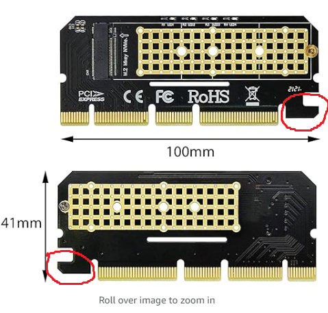

you can add one more ssd on full bandwidth of PCIe 4.0 x4
Just buy a normal pcie x 4 to m.2 adapter
it’s like 5-10$
https://www.amazon.in/CARE-CASE®-Express-Adapter-CC-PCI/dp/B0CHW1ZCP3
https://www.amazon.in/Fastline-Products-Nvme-Adapter-Converter/dp/B0CCDVP2BC
https://www.amazon.in/Verilux®-NVME-Adapter-PCIe-Support/dp/B099RNMDR9
there shouldn't be any problem with pcie signaling, if you use it with pcie 3.0 ssd ( I assume you have that type now in m.2 slots )
and use that adapter in PCI_E3 slot ( the pcie 4.0 x4 slot )
it’s like 5-10$

Ps. you can buy more and use these adapters in other PCIe x16 slots, but the speed will be capped at 1000 MBps (PCIe 3.0 x1)
If the SSD is free, then it's better than nothing.
Hi. Will it be faster/better to get a dual adapter and put both 970 EVOs in PCIe 4.0 x4 port or Get 2 adapters for each and put one 970 EVO in PCIe 4.0 x4 and another in PCIe 3.0 x1?
Also, I can't put an x16 in x4, right?
Only 1 of the SSD's will work if you put them into an x4 slot.
And yes, you can put an x16 card in an x4 slot. As long as the back of the slot is open. Not all are, but they can be cut open if need be.

Your mobo has all physical pcie slots in x16, so you can put whatever you like x1, x4, x16.
dual adapter
Only active pcie switch would work, and these cost like 200$ and more for pcie 3.0 ones.
I already linked and said what’s best.
just buy a pcie x4 to m.2 adapter and use it in PCI_E3 slot, and buy one PCIe x1 to m.2 adapter, and use it in other slot (you can buy two x4 adapters if price is similar)
Hi, one last time bothering you. 😄
I got 2 of these:
https://www.amazon.in/gp/product/B099RNMDR9/ref=ppx_yo_dt_b_asin_title_o01_s00?ie=UTF8&psc=1
While putting the 2nd one in the E4 slot, it is prevented from going in properly by an SSD beside it. The E5 slot is obstructed by a fan above the power supply. Can I cut the lock part in one of the adapters as shown in the picture? E4 doesn't have that lock anyway.
It's just a lock tab, you can cut it, but do secure IT after, so there's no short if you thought it with something. ( Event nail polish will do, if you don't have anything better )
