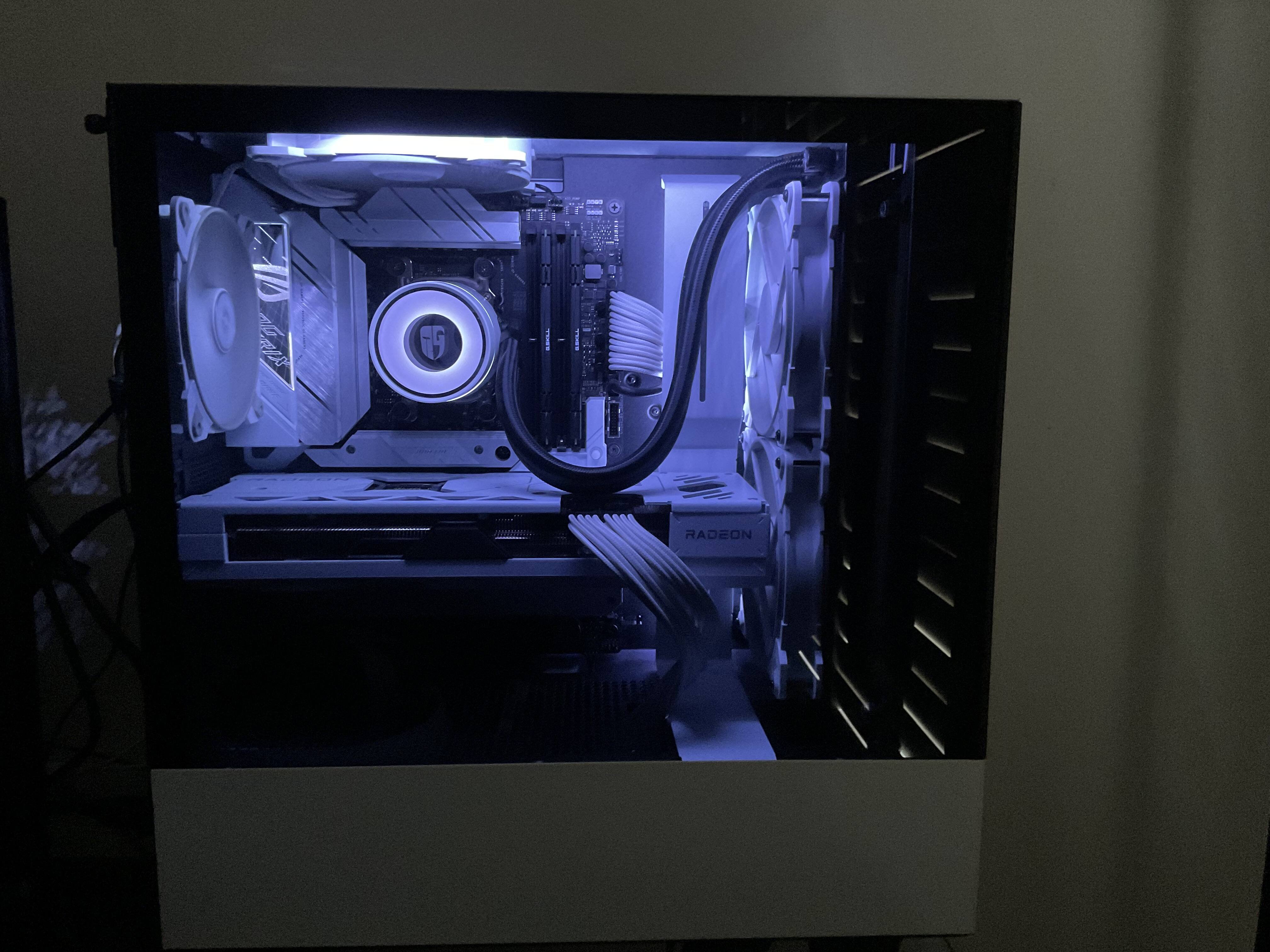

So I’m having 3 issues with my new 7900 GRE so if anybody has any insight, I would appreciate it.
Issue 1. If I plug my second monitor into the integrated graphics, port of the motherboard I cannot overclock my GPU? For the past week I’ve been tearing my hair out, trying to figure out why I can’t overclock my GPU at all, as when I do, I get freezers and gray screens. But here’s the catch the freezers and grey screens would only happen when the computer was idling, and not during benchmarks or in games… In addition, when I turn the computer off, the screen will flash white very briefly. I finally plugged both monitors into the GPU and its now over clocks fine.
Issue 2. When I plugged both monitors into the new GPU, the idle wattage is between 70 and 80 Watts…. I did some research and apparently it’s because of the different refresh rates of each of the monitors as one monitor is 240 Hz and the other is 155 Hz. I made a custom profile and went through a bunch of different hz settings and the only one that worked was turning the second monitor to 60 Hz… which is not ideal. It now idles at like 30 W.
Issue 3. The memory temperature and memory Junction temperature idles at 70 to 75C. When in games, the memory temperature and memory Junction temperature never get above 93C and the GPU core itself never gets above 73C. It just seems that the memory and memory junction idle temperatures are really high for some reason, but maybe this is normal? The hotspot temperature idle is about 50C.
So if anyone has any advice, I’m all ears. Thanks.

RAM: 32GB Gskill
what case?

I purchased the card from newegg new about a week and a half ago.
