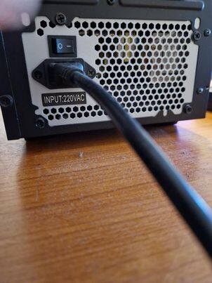

Well, I am currently unaware of how to check my power supply.. It's not a very ergonomic case to be fair, it is made by a local store chain and I am unsure how to get to the power supply without completely tearing the PC apart. I am also a very novice builder with limited experience, I have only changed ram and reseated my GPU so far.
Without knowing the psu we cant advice an upgrsde as for all we know the psu is a bad unit and upgrsding could mean it fails and kills the system.
Got pics of your pc? Since you say its a more custom case it will also be importsnt to know what potential limits are

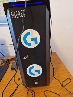

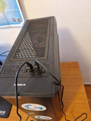

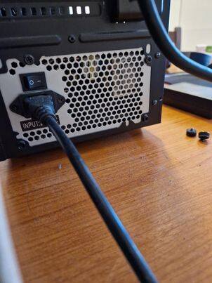

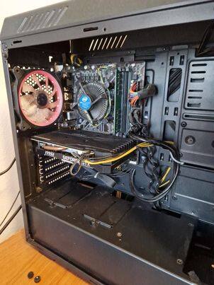

Yes, here are some pictures with the side panel off and with (what I hope is) optimal lighting..  Apologies for the dust..
You can fit up to a full ATX motherboard in there, so that's nice. I don't know how those PSU basements work, as I've never worked with one, but I believe the PSU is somewhat accessable through the back sidepanel.
This is what the back panel looks like. I can see there are bolts attached to the PSU and the WHOLE back panel so if I'd have to get to it, presumably I'd need to take it all apart? I also saw this sticker on it, unaware of what it means, "input:220 vac"..
