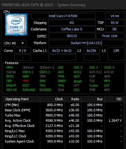

Post a HWiNFO screenshot that shows what your turbo power limits are set to. An Intel CPU set to default values can cause power limit throttling which will reduce performance. Watch the limit reasons data in HWiNFO to check for any throttling reasons.

I'm not exactly sure what to look for (not that tech savy) but hopefully one of these is right 🙂
Can you tell me anything from this or am i doing it wrong haha?

Just now, YoungBlade said:
I believe 4.6GHz is the out-of-the-box all-core frequency for the 9700K. So your CPU is working exactly as expected for stock performance with all 8 cores active.
As for why a GPU upgrade would make it run at 100% now, it's because the CPU has to work harder to keep up. Before, your old card wasn't generating frames as fast as the CPU could process them. Now, it can.
BF2042 is a highly CPU demanding game - especially for the max player count. It is very likely that you are totally maxing out the CPU to the point that it can't keep up with processing the game physics or managing the data to and from the server, resulting in that behavior. You may want to consider an FPS cap around 90fps or so to give the CPU some breathing room.
That, or you can try overclocking. Most 9700K CPUs can do a 5GHz all-core just fine, which is about an 8% boost. For my 9600K, going from 4.3 to 4.8GHz was surprisingly noticeable in CPU limited situations, although that is a slightly higher 11.5% increase.
Really? I could've sworn that it ran with 3600mhz before the new GPU.. Must be mistaken then unless I misunderstood you..
Appreciate the response though! I'll try to cap at 90 or something.. The store I bought the GPU from just told me there's a bottleneck between the CPU and the GPU and that I should upgrade the CPU.. but I'll give your suggestions a shot first and maybe try overclocking just to see if gets a little bit better 🙂
That's the base clock, which is meaningless on modern CPUs.
