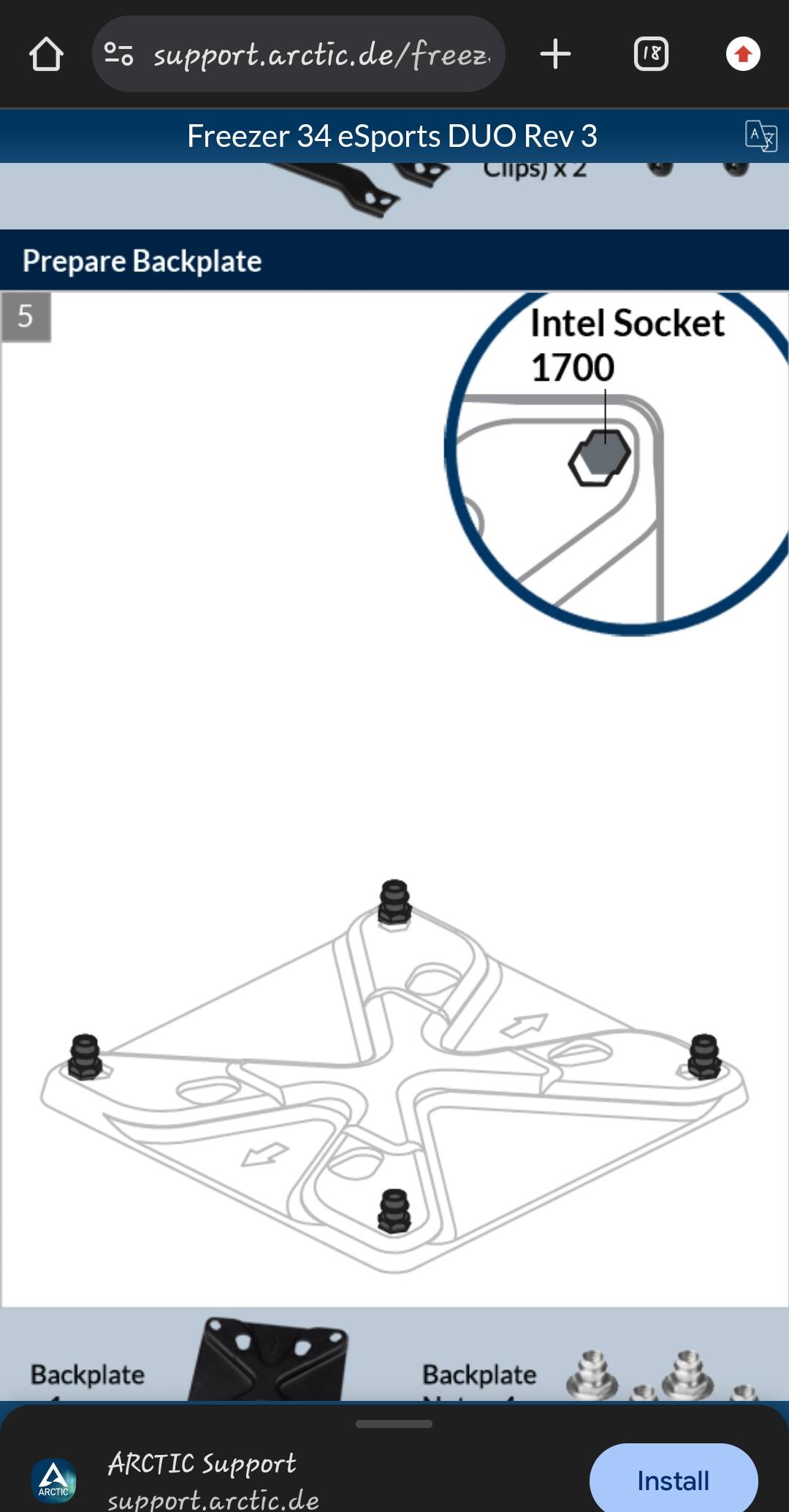

5 minutes ago, frozensun said:
U sure??No, the stock backplate is installed and I already attached contact frame on it.
Yeah, that back plate is just for the ILM. Cooler backplates with few exceptions are designed to mount overtop of it.
Hi guys.Could someone explain me this part because I am confused.
On the pic : prepare backplate, does it mean I would need to remove stock intel backplate on my motherboard prior to installing backplate from Freezer?
https://support.arctic.de/freezer34esportsduor3
No, the Freezer would go over the ILM backplate.
Unless there's a cooler backplate already installed, in which case I have other questions.
Okay..thanks.
