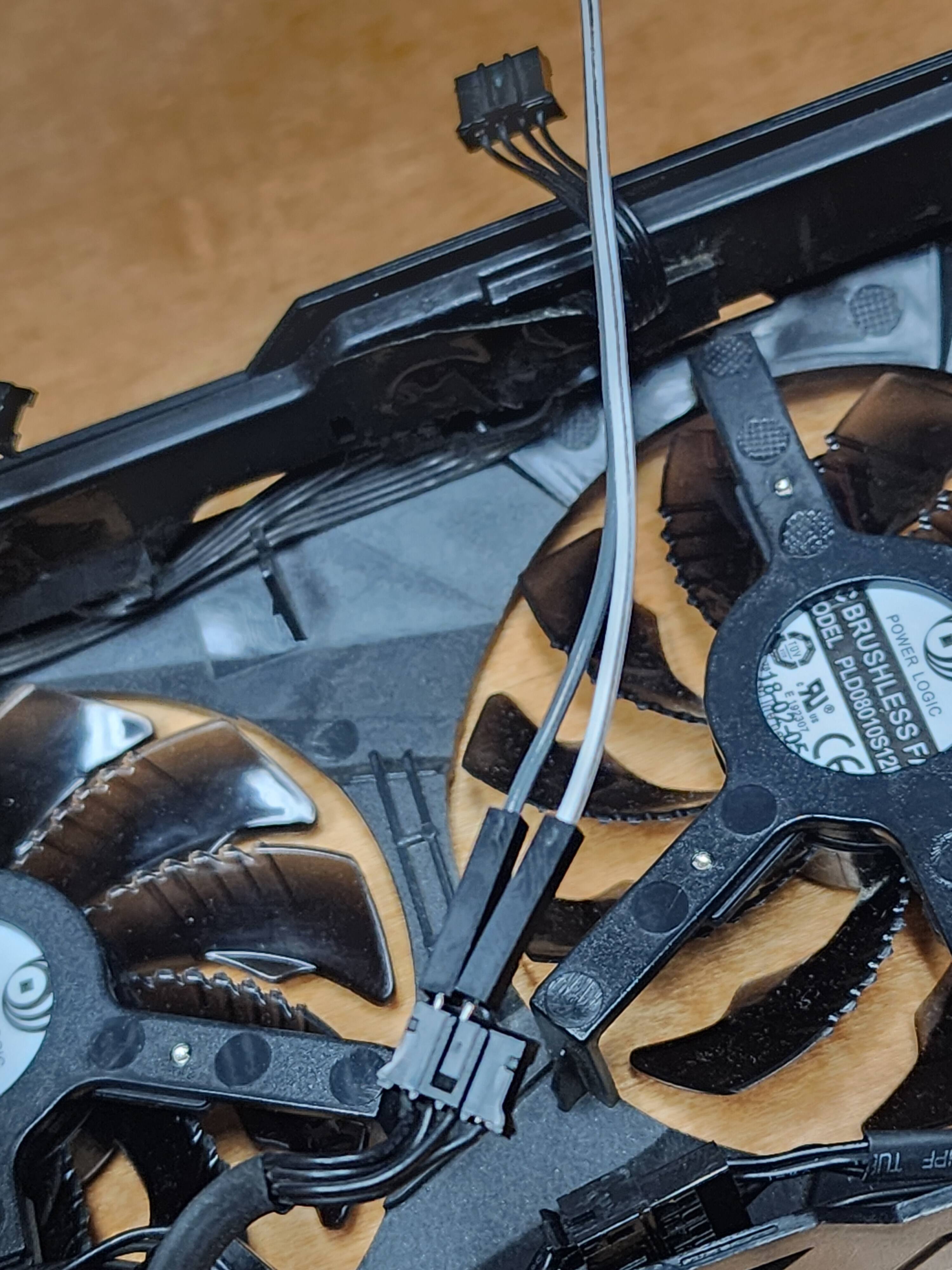

So I was trying to bench test the fans yesterday by starting at 7v and ramping them up to 11v I didn't actually try 12v until today and I saw the fans instantly spin up. Unfortunately only the two outer fans spun up. I then unplugged the middle fan from the harness and the outer fans still spin but then when I plug the middle fan into the power supply I get nothing.
Is there a reason that one of the fans would have randomly died? Would this cause all of the fans to not spin up? When I connected the power supply to the harness with all fans connected only the outer fans spin but they still spin. When I had the fan assembly on the gpu none of the fans spun up.
Anyone know what might cause this? If it might be something other than just a dead middle fan?

The first picture is how I hooked up my power supply to the fan harness. The grey is the ground and the white is the 12v.

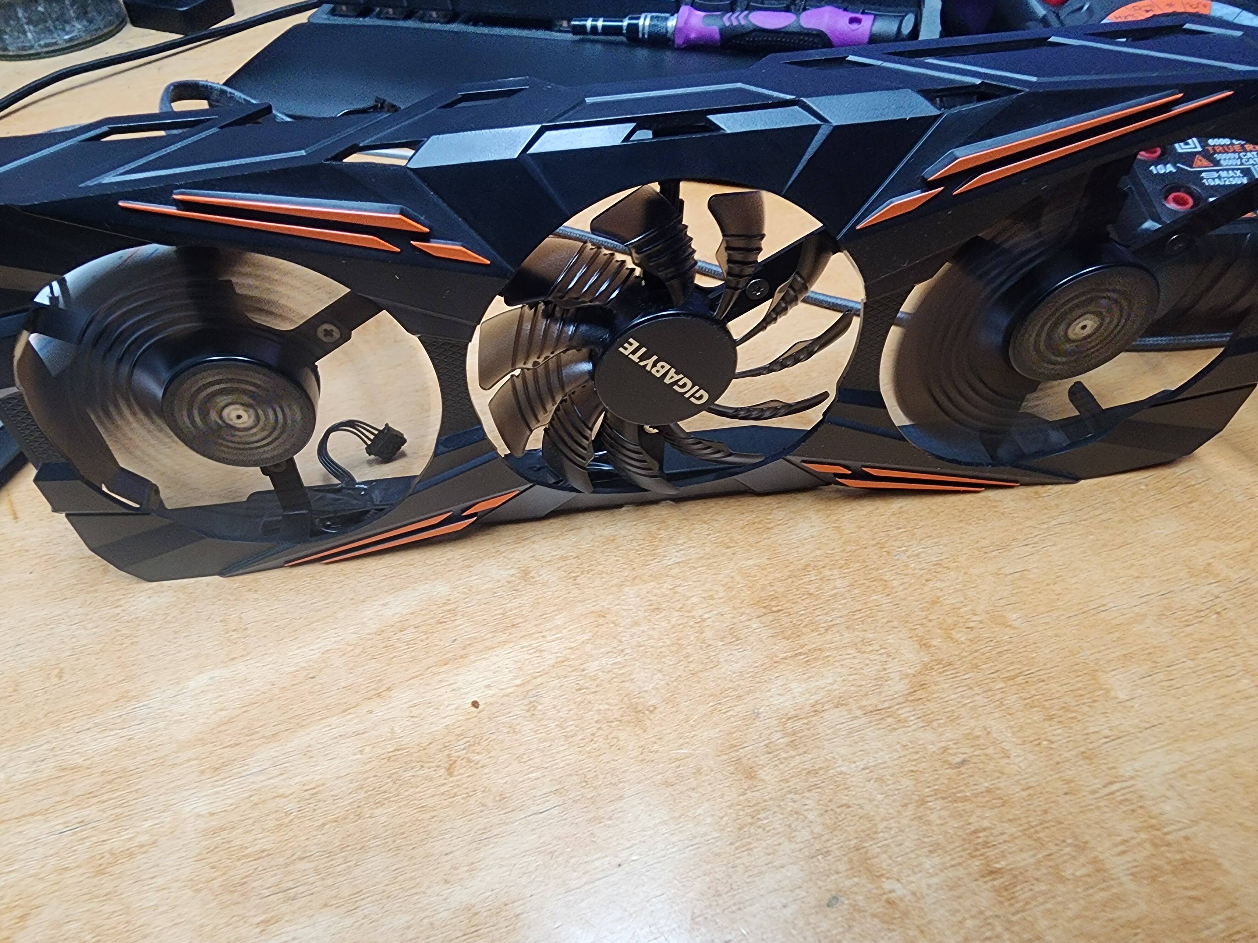

The second picture shows the two outer fans spinning, this was after I had ensured that the middle fan was plugged back into the harness.

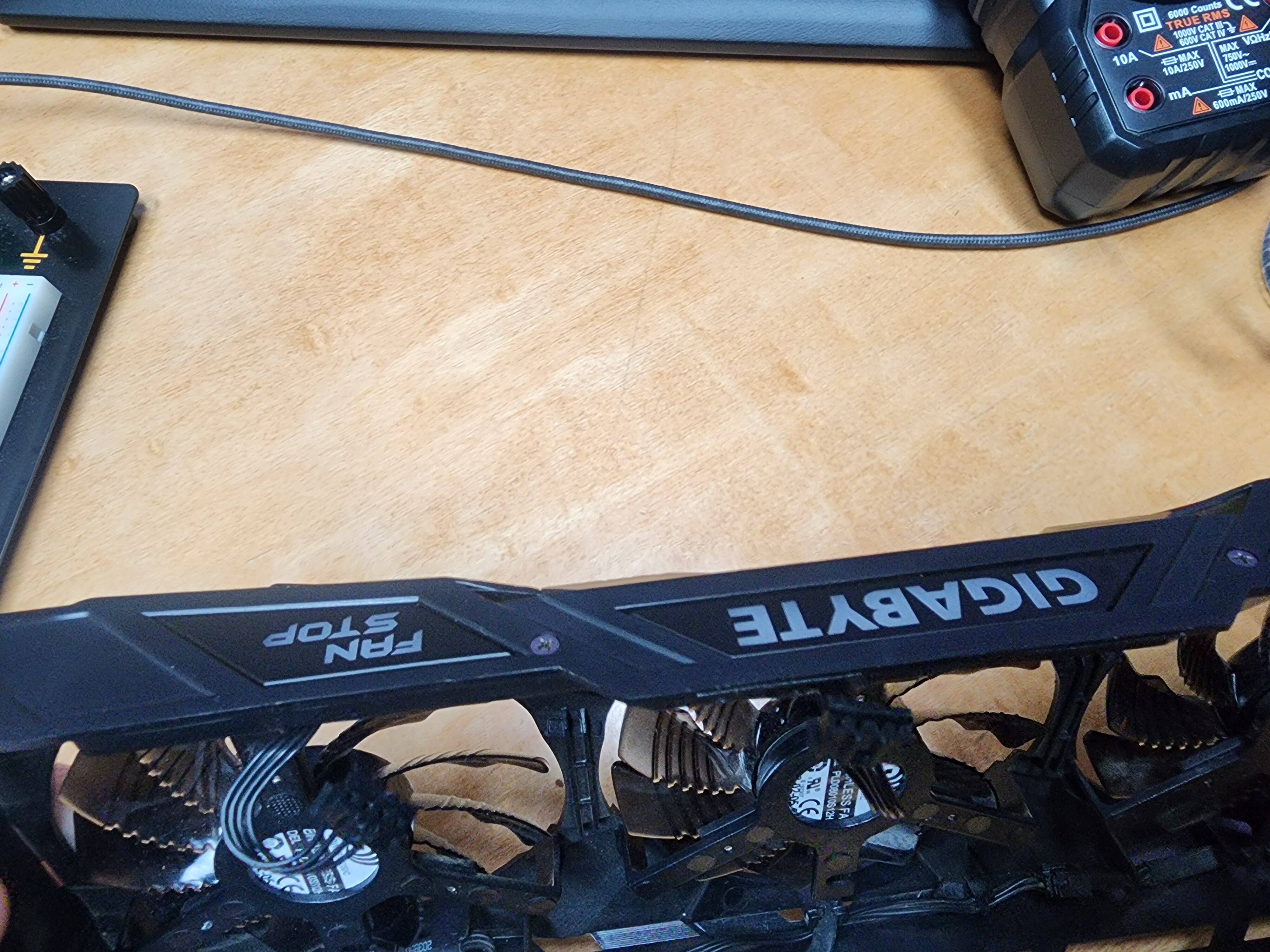

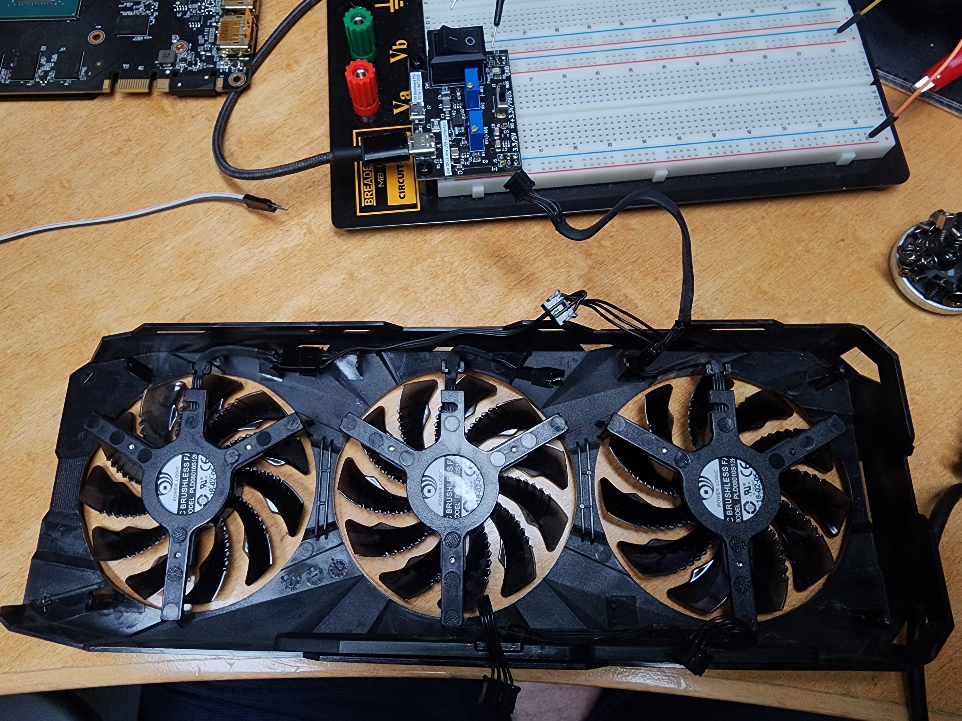

In the third and the fourth picture show some additional fan connectors. But these two fan connectors in picture 3 are the connectors for the rgb panels in picture 4.

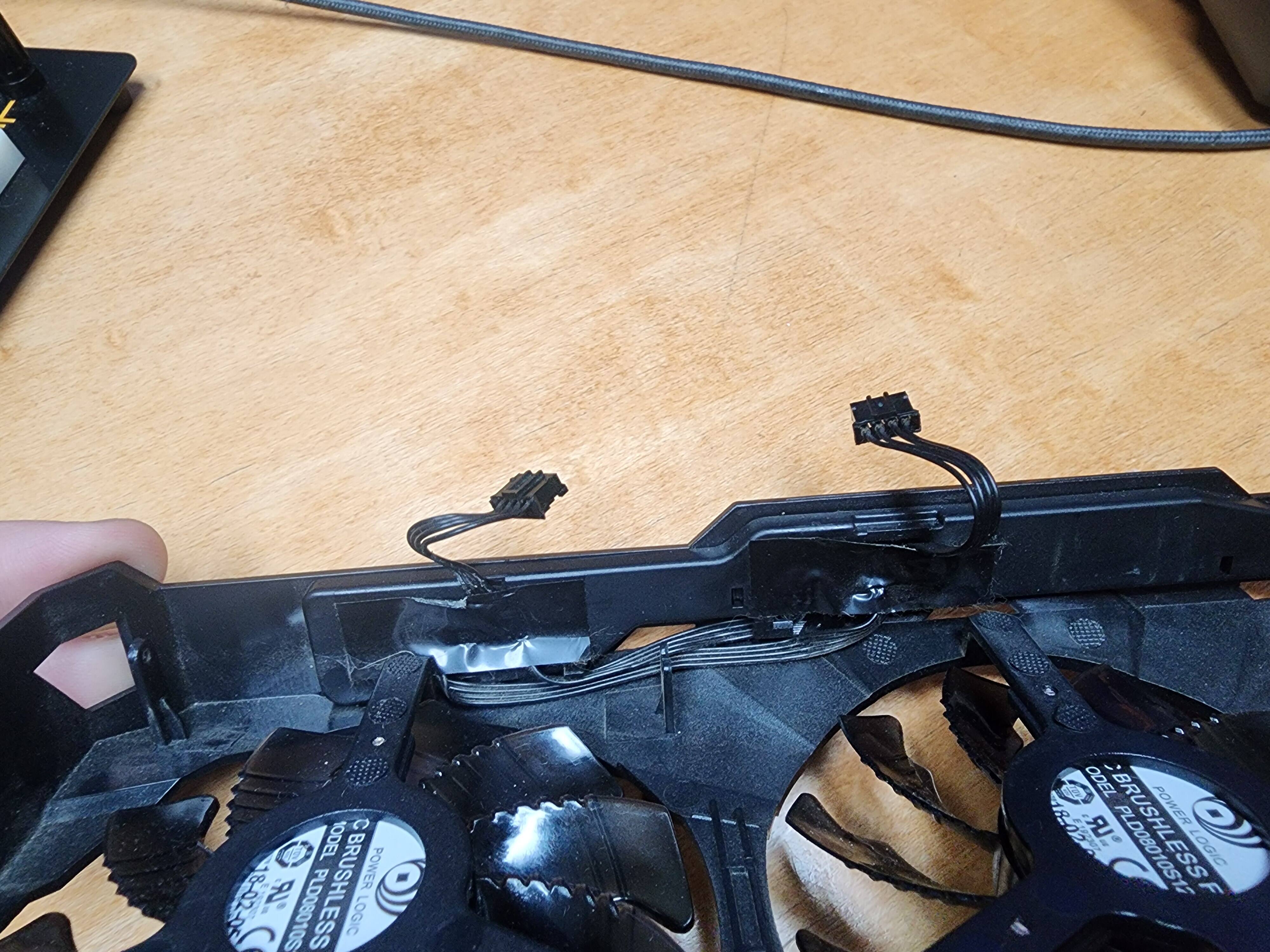

Then in the 5th picture I unplugged the middle fan from the harness and plugged it into the power supply the same way as the other test. The only difference is that the connector is now a female connector not a male connector which means the pins will be flipped. I turned the power supply on and nothing. I even double checked the voltage before I tested the middle fan.
Is there a reason the middle fan might die like this? or did the middle one just go bad before the other ones? Would something on the gpu pcb cause this to die?
