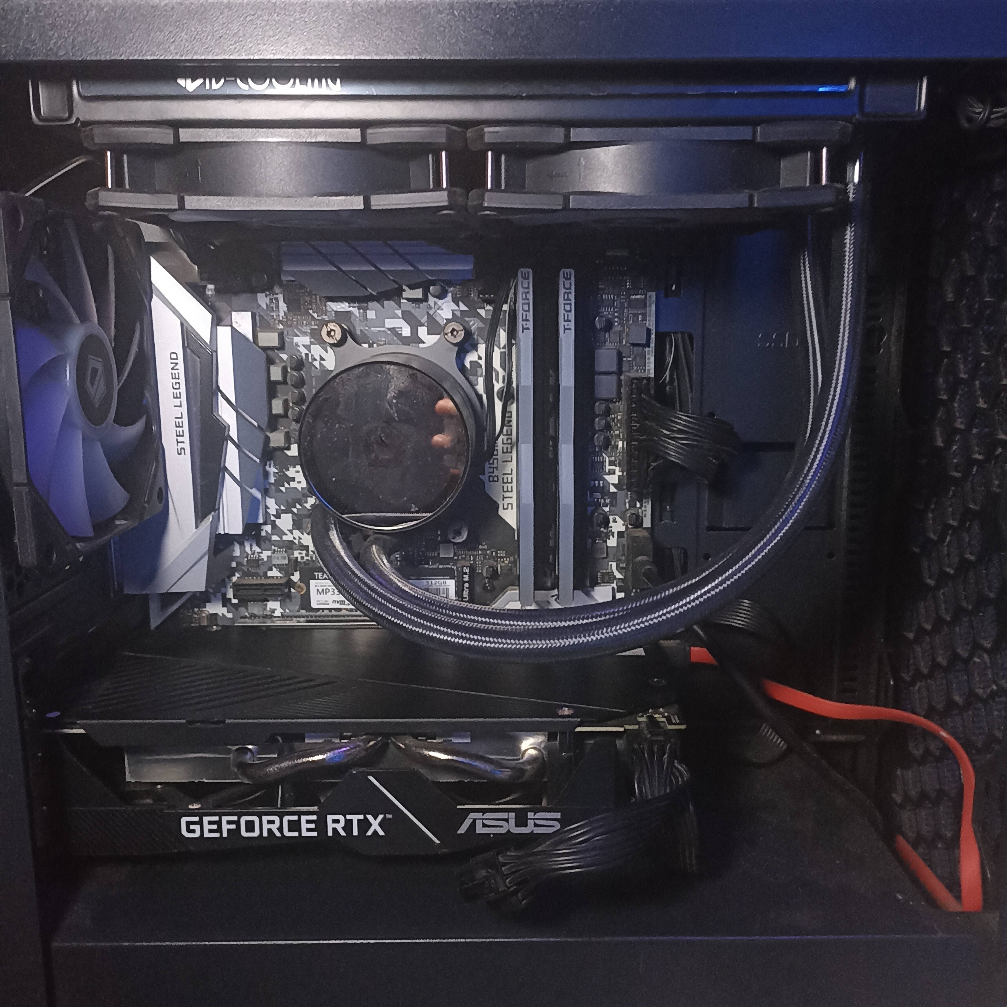

I do yes, my room temperature around 28 C with air conditioner on and I can't say for sure that my pc have a proper airflow but I'll send you the pic of my pc bellow.
What do you think?
https://linustechtips.com/topic/1573365-my-rtx2060-overheating/#findComment-16437031
The gpu fans are a little choked as they dont have much room to breathe, but there's not much you can do other than installing some fans in the front of your case to improve the airflow over your gpu
I see, I'll try that later. Thank you

Probably just the lack of airflow in the case, the front panel looks a little dusty too try giving that a clean see if it makes a difference

Your GPU fans are about an inch away from that PSU shroud which means it's probably only getting 20-30% of the air it expects and with no intake in the lower front of your case the GPU fans are just stirring around the hot air rather than getting it out of the PC.
There are numerous solutions to this problem. The BEST would be getting a new case. I like the Phanteks p400 Digital which comes with three decent front fans. If 100$ is too spendy but you are still willing to spend, you could get a fan to put in the bottom front of the case. If you want to spend 0.00 monies, you could probably reap some solid cooling reward if you just cut out a chunk of the PSU shroud at the cost of case rigidity and a bunch of time and efffort (you will have to FULLY remove every component of the PC, hunt down a friend with a grinder, dremel, or tin snips and some metal compatible sand paper, then blast the heck out of it with air, wipe every surface with a damp rag, then reassemble making sure the PSU fan is drawing air in from the bottom of the case). Finally, if none of the other options appeal, I'd at least move that rear exhaust to be a front intake at the bottom

@Mifta what is the model of your ASUS RTX 2060?
Most modern graphics card, including the RTX 2060, can have a "0 RPM" / "0 dB" mode.
By default from the factory, the fans on the graphics card don't spin up until it reaches ~60*C (though this can be changed through GPU software).
If you are seeing 58*C, then the fans are probably not even moving.
58*C is nowhere near over heating.
I see, thank you so much for the warm welcome btw. I think I'll buy 3 fan for the front panel.
Thank you so much for the solution
