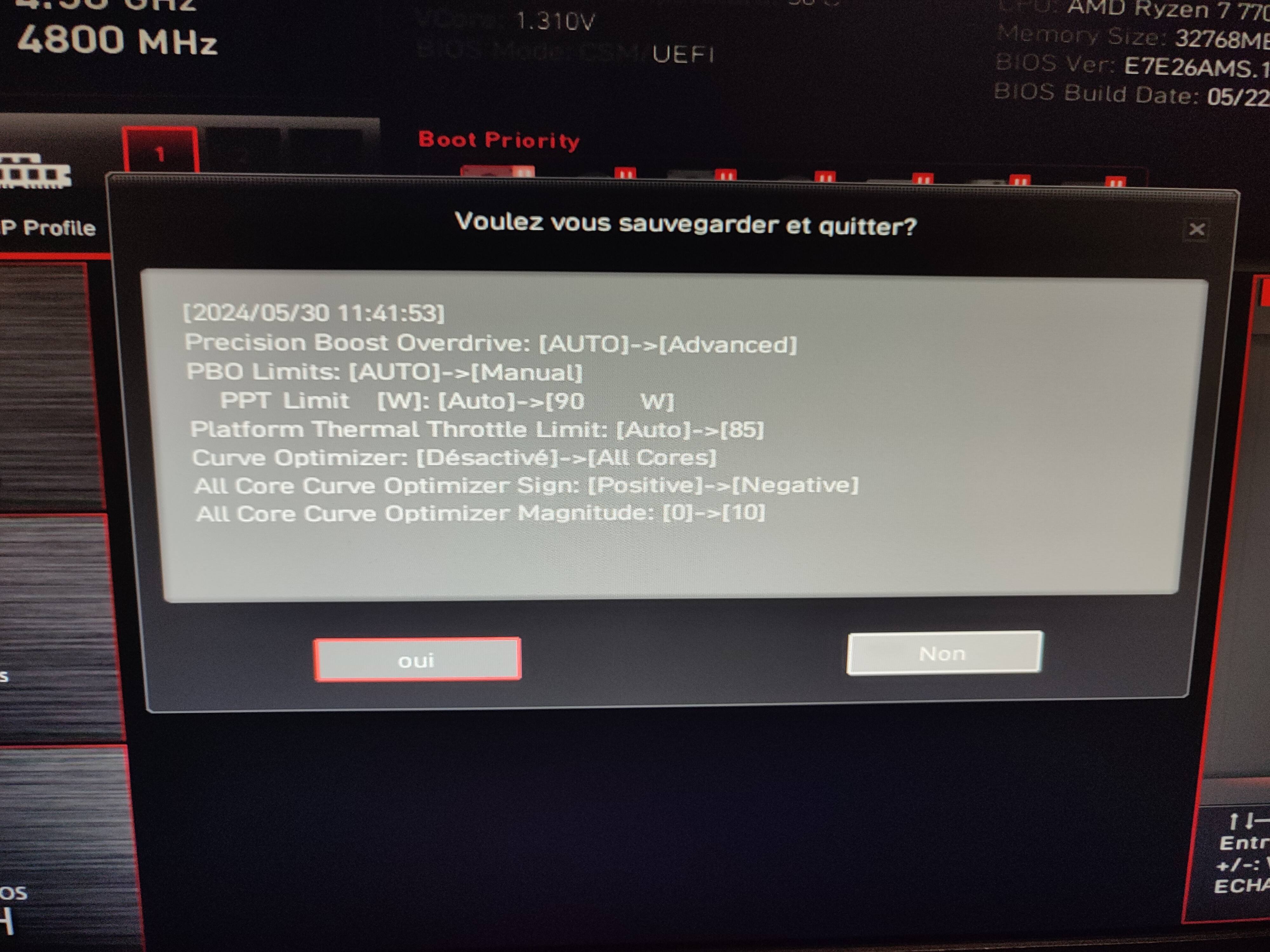

Posted May 30, 2024 Hey everyone ! Hope you're doing well ! I wanted to stop the 7700x from going at high temps for nothing (even tho it has been designed for that) so i followed that tutorial about Undervolting and did mine ! https://youtu.be/FaOYYHNGlLs?si=atraw_2rTxCVdSHF Here's in the picture what i edited in the bios for the undervolt, i put the magnitude to 10 because it wasn't stable a 30 when i tried back then ! So yeah i'd love your opinion about it (if it's well made and if it's okay or not ), i'm doing tests to see its stability while posting this Also, general questions i had about thi subject can undervolting reduce the lifespan of a cpu ? Can it increase its lifespan ? Can it cause other components to ''malfunction'' (like the cooling or something else ?) Thank you in advance for all your answers and have a great day =) Link to comment https://linustechtips.com/topic/1572006-your-opinion-about-my-undervolting-of-the-7700x-questions/ Share on other sites More sharing options... Link to post Share on other sites More sharing options...

Posted May 30, 2024 Author 14 minutes ago, Eigenvektor said: Running the CPU at a lower voltage should technically increase its lifespan. But the effect isn't going to be significant enough to matter. Most CPUs should last for decades, much longer than you will typically use it for, before it is replaced. No. If voltage is too low, you computer might become unstable/crash a lot, but there is virtually no risk if lasting hardware damage. Simply increase the voltage again until it becomes stable. Okay ! That reassures me, IT guy told me to leave it as default (as it should run normally) but seeing my 7700x running too hot was making me sweat in every senses haha (even though they have been designed to pump heat for max performances). Do you have an opinion on the values i put for the undervolt (in the picture) by any chances ? Like i said i followed the tutorial and tweaked the tdp and magnitude but other than those values displayed in the picture i touched nothing else haha Thank you again for your answers =) Link to comment https://linustechtips.com/topic/1572006-your-opinion-about-my-undervolting-of-the-7700x-questions/#findComment-16424331 Share on other sites More sharing options... Link to post Share on other sites More sharing options...

Posted May 30, 2024 Author 8 minutes ago, Dedayog said: My 7700x did -30 all day and ran 83c gaming at 5.5ghz all core. Not sure why you're having issues with the manufacturer specs but heat is relative and the chip can do it for years. Set the voltage and temp limits to your preference. You are right, i know it's perfectly normal to output those temps for a 7700x but yeah it's just me being picky on that topic haha Do you find the values i put in the bios (in the image above) for the undervolt "safe and normal" ? like i said i followed the tutorial in the video and only touched what's in the image but we never know haha Link to comment https://linustechtips.com/topic/1572006-your-opinion-about-my-undervolting-of-the-7700x-questions/#findComment-16424397 Share on other sites More sharing options... Link to post Share on other sites More sharing options...
Posted May 30, 2024 10 minutes ago, Psycko123 said: You are right, i know it's perfectly normal to output those temps for a 7700x but yeah it's just me being picky on that topic haha Do you find the values i put in the bios (in the image above) for the undervolt "safe and normal" ? like i said i followed the tutorial in the video and only touched what's in the image but we never know haha Yes, I used his guide as well as Level 1 Tech. "Do what makes the experience better" - in regards to PCs and Life itself. Onyx: AMD Ryzen 7 7800x3d / ASRock Taichi 7900xtx OC / Gigabyte B650 AORUS Pro AX / G. Skill Flare X5 6000CL36 64GB (4x16GB) / Samsung 980 1TB x3 / Super Flower Leadex V Platinum Pro 1000 / EK-AIO 360 Basic / Fractal Design North XL (black mesh) / AOC AGON 35" 3440x1440 100Hz / Mackie CR5BT / Corsair Virtuoso SE / Cherry MX Board 3.0 / Logitech G502 - https://valid.x86.fr/my9nnr 7800X3D - PBO -30 all cores, 4.90GHz all core, 5.05GHz single core, Cinebench 23: 18401 multi, 1779 single Sage: Ryzen 7800X3D - Gigabyte B650 Gaming X V2 - ASRock Steel Legend 7900GRE - G. Skill Flare X5 32GB 6000CL32 - TeamGroup MP44L 2TB - Super Flower Leadex Platinum SE 1000w - NZXT H5 Elite Emma: i9 9900K @5.1Ghz - MSI 6900XT Gaming X Trio - Gigabyte AORUS Z370 Gaming 5 - G. Skill Ripjaws V 32GB 3200CL16 - 750 EVO 512GB + 2x 860 EVO 1TB (RAID0) - Super Flower Combat FG 850w - Thermaltake Water 3.0 Ultimate 360mm - Fractal Design Define R6 - TP-Link AC1900 PCIe Wifi Raven: AMD Ryzen 5 5600X3D - ASRock B550M Pro4 - G. Skill Ripjaws V 16GB 3200Mhz - XFX Radeon RX6650XT - Samsung 980 1TB + Crucial MX500 1TB - Cudy AX3000 PCIe Wifi 6 - Gigabyte GP-P450B PSU - Cooler Master MasterBox Q300L - Samsung 27" 1080p Plex: AMD Ryzen 5 5600 - Gigabyte B550M AORUS Elite AX - G. Skill Ripjaws V 16GB 2400Mhz - MSI 1050Ti 4GB - Crucial P3 Plus 500GB + WD Red NAS 4TBx2 - TP-Link AC1200 PCIe Wifi - EVGA SuperNova 650 P2 - ASUS Prime AP201 - Spectre 24" 1080p GF Rig: Steam Deck 512GB OLED, Vizio 43" 4K TV OnePlus Ecosystem: OnePlus 11 5G - 16GB RAM, 256GB NAND, Eternal Green OnePlus Watch 2 - Radiant Steel OnePlus Buds Pro 2 - Eternal Green Other Tech: - 2021 Volvo S60 Recharge T8 Polestar Engineered - 415hp/495tq 2.0L 4cyl. turbocharged, supercharged and electrified. - Lenovo 720S Touch 15.6" - i7 7700HQ, 16GB RAM 2400MHz, 512GB NVMe SSD, 1050Ti, 4K touchscreen - MSI GF62 15.6" - i7 7700HQ, 16GB RAM 2400 MHz, 256GB NVMe SSD + 1TB 7200rpm HDD, 1050Ti Link to comment https://linustechtips.com/topic/1572006-your-opinion-about-my-undervolting-of-the-7700x-questions/#findComment-16424405 Share on other sites More sharing options... Link to post Share on other sites More sharing options...

Posted June 1, 2024 Author 3 hours ago, Dedayog said: Yep. I usually just load Optimized Defaults if I want to go back to stock, but just undoing those will work too if that's all you did. The 7700x tweaked well does an excel job of performing near the top of the heap. Great CPU. I agree yes, with the "simple" tweaks i put yes i lost like 8% perfs on cinebench (18336 score compared to 19614 stock score) multicore (which is really not a lot haha) but like also lost more than 30° C temps while still having those sweet insane performances. The only thing i notices was the voltage whom during the famous temps spikes were going to 1.35-1.4V but honestly i don't have any experiences on voltages behaviour to tell if that's abnormal or just the symptomes of the temps spikes that the 7700x is known for haha (don't know if you have those too) Link to comment https://linustechtips.com/topic/1572006-your-opinion-about-my-undervolting-of-the-7700x-questions/#findComment-16426447 Share on other sites More sharing options... Link to post Share on other sites More sharing options...
