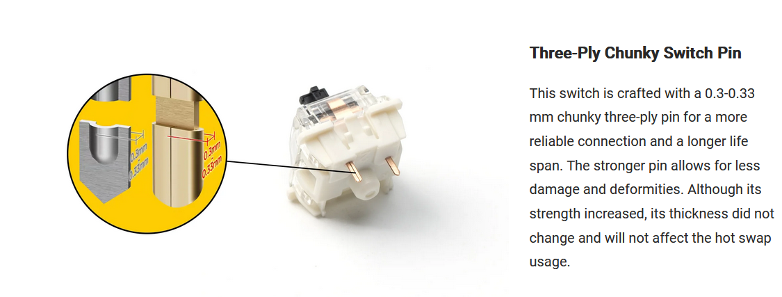

I think Gateron has thicker reinforced contact pins on their newer switches:
So something like G Pro 3.0 or any newer revisions of the other switches like the Baby Kangaroo v2 should have that. I think even newer batches of Oil Kings have this now (which would make sense if they just swapped over all the lines that make the contacts).
