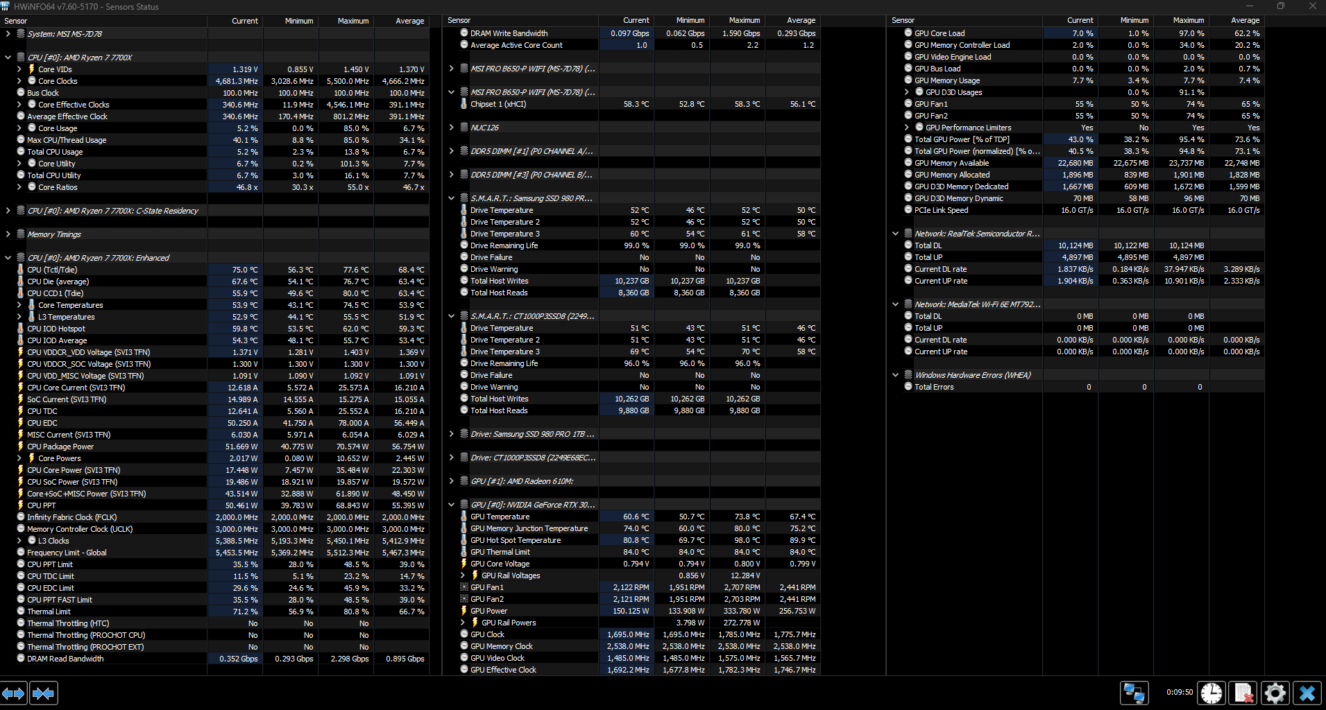

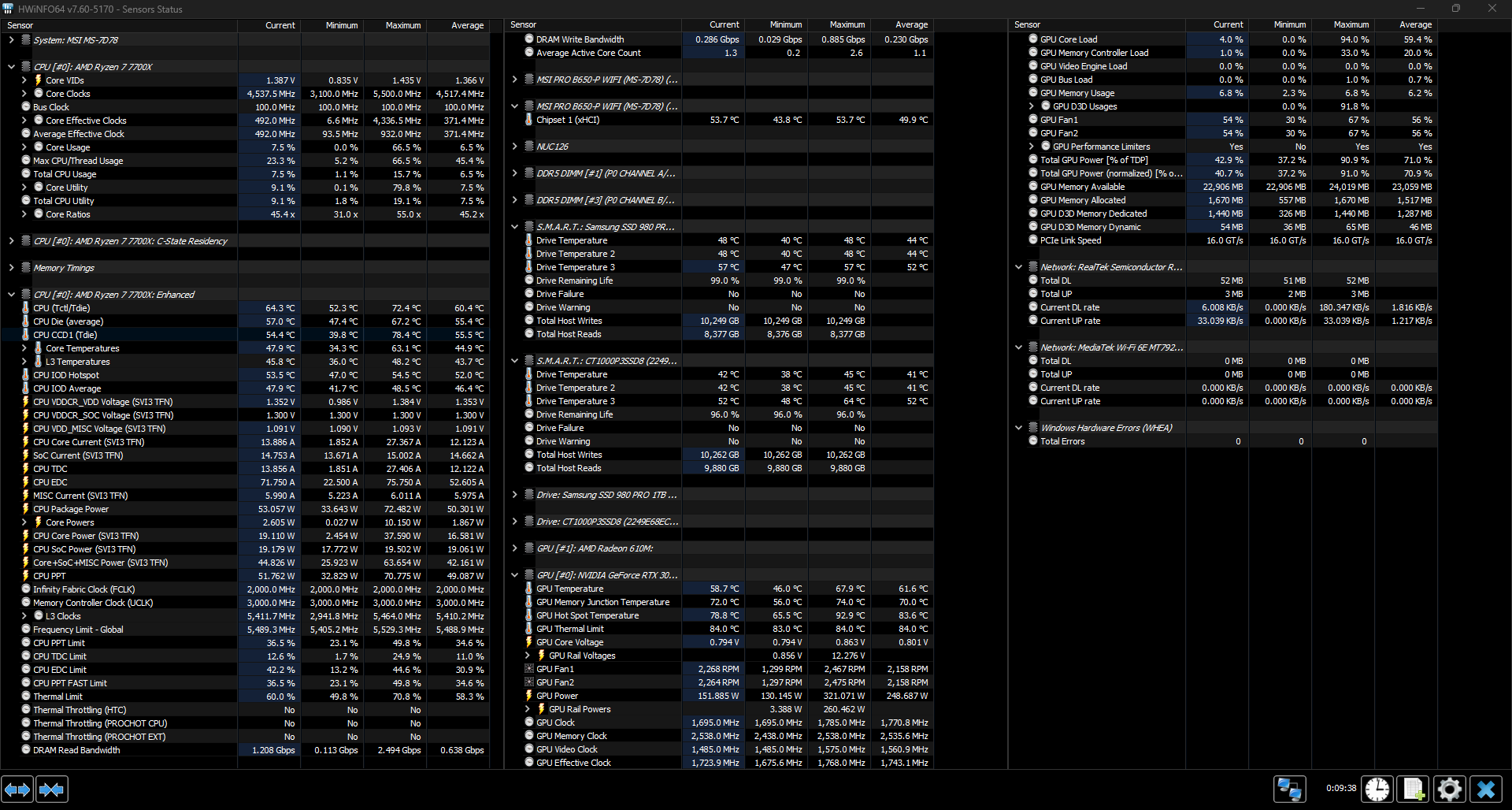

my main concern with the high temps is gpu, specially the hotspot temps, this is an example of temps playing cyberpunk 2077 on highest settings raytracing overdrive for 20 min in two different undervolt settings
1- less aggressive undervolt:
r/pcmasterrace - how can i improve this cases air flow ?
2- a more aggressive undervolte
now i know sooner or later i ll have to open the gpu and respate/ change thermal pads of the whole thing, but i wanna first improve my case air flow, see if it gives me reasonable temps, then take the step of opening the Gpu
any advice / help would be greatly appreciated

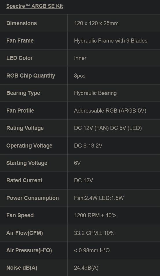

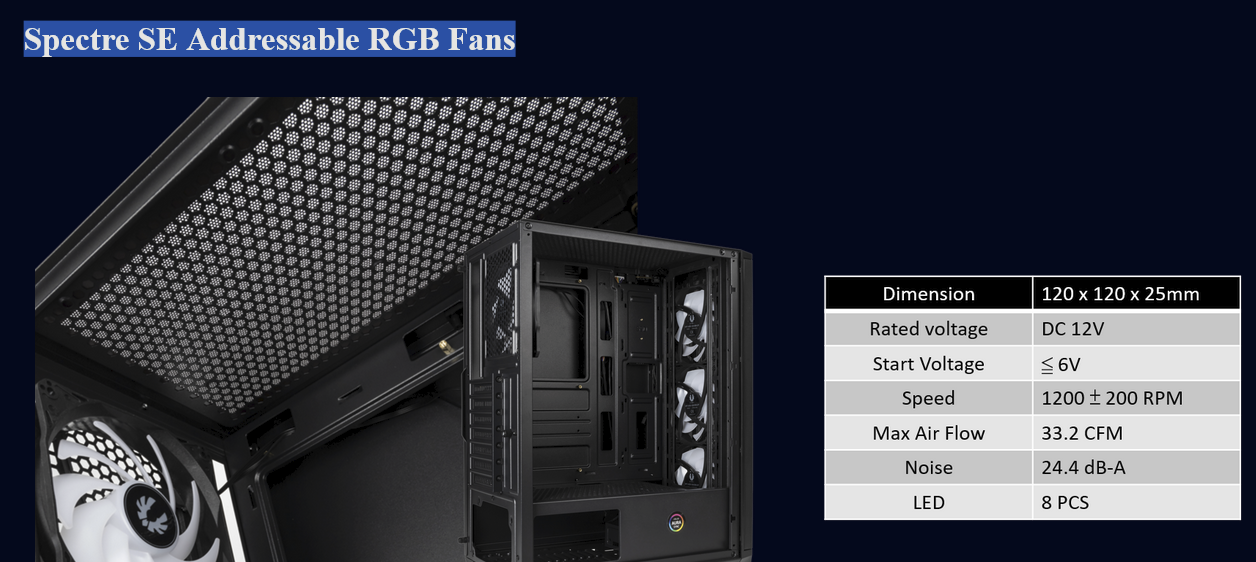

Anywaay, are you using stock fans that came with the case? If so, have you tried using another fan? preferably a better one.
Because from the tech spec I'm seeing on their website, IMO, they seem suck, especially for a mesh that tight and for a 3090.

It's pretty well ventilated case.
Adding an extra 1 or 2 exhaust fans at the top *might* drop the overall temperatures by a couple of *C, but I wouldn't expect like 10*C+ difference.
74*C GPU temperature is fine.
Hotspot / Junction temperature is more with the GPU cooler, given that the case is not suffocating everything -- and it doesn't appear to be here.
Repasting and fresh set of (proper thickness) thermal pads is the more likely solution.
Seeing the CPU temperature hit 84 / 85*C.
If that concerns you, a CPU Cooler with more thermal mass / cooling should drop those temperatures down a bit more.

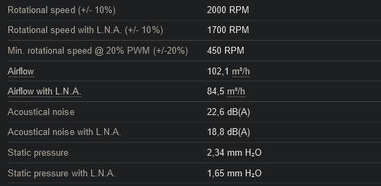

28 minutes ago, AnxiousBeat said:
What factors show that a fan is bad or good? can you please suggest some good ones/ show me how can i know for myself

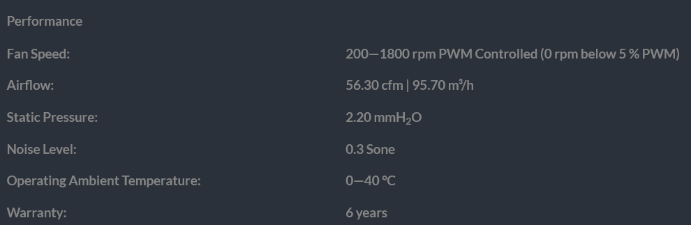

Generally you look at their CFM (Cubic Feet per Minute) and their Pressure when it's about cooling capability.
CFM is how much air they can move
While pressure is useful when the air needs to go through tight obstructions, like mesh panel, filter insert, radiators.
You can find youtube videos comparing SP and AF, usually they do the test using smoke, so you can see the difference on the air each of them expel.
A good and cheap PWM fan that often gets recommended is Arctic P12 PWM PST (There's version without PWM PST, but I don't advise getting it)
IIRC, at amazon they're usually $5 each if you buy a pack of 5.
Here's Arctic P12 PWM PST specs :
https://www.arctic.de/en/P12-PWM-PST/ACFAN00120A
Here is Noctua A12x25 (Pretty much one of the creme of the crops)
You see Noctua listed airflow using m³/h (Cubic Meters per Hour) instead of CFM, it can be converted. 1 m³/h = around 0.589 CFM said Noctua.
So A12x25 CFM is around 60
L.N.A meaning Low Noise Adapter, it's an adapter cable Noctua sells and sometimes include in package so that the fan will operate at lower performance, usually used to lower noise level of the fan.
Then the rest of the details is nosie level, bearing type, etc. Like @RevGAM have said.
But yeah, I wouldn't worry too much about it unless you're picky about such thing.
Since I assume with your 3090 the GPU fan gonna be the most noisy one when under load, while when not in heavy load, the system usually be fine enough with case fans running at 50% or so (if they're atleast decently powerful enough that is).

52 minutes ago, Poinkachu said:
Generally you look at their CFM and their Pressure.
While pressure is useful when the air needs to go through tight obstructions, like mesh panel, radiators.
You see Noctua listed airflow using m³/h instead of CFM, it can be converted. 1 m³/h = around 0.589 CFM said Noctua.

I only recommended that because those fans are so pathetic that they'd have a hard time disrupting the floor. In my PC, I have 2 weak fans occupying the first 2 ports and a T30 in the rear one. My front fans are 2 iPPC-3000 and another of the weak fans. Along with the 3 ML120s in the side and the A12x25 in the rear, plus my U12A, it keeps my computer significantly cooler than the TR Frozen Notte I'm currently testing with just the rear exhaust. Well, at least in the configurations I've tried so far.
2 hours ago, AnxiousBeat said:
helps alot, my last question is what is considered a high AF/SP value,
It's pretty rare to see a fan with AF over 100 CFM, so at 75 and above is really nice.  For SP, below 1 mmAq is only good for exhaust, really, >1 is important for a heatsink and greater than 3 is best for radiator. There is a point of diminishing returns, though, which is heavily influenced by multiple factors, including the fan thickness and blade design.

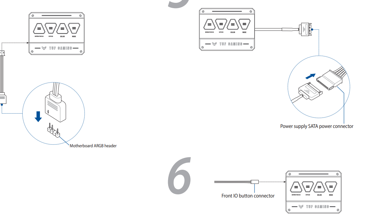

You can use the hub, or you can directly plug to your motherboard. Your choice.
The hub will make cable management a bit tidier and easier. Although since you most likely gonna place the hub inside the case, those buttons on the hub is pretty much useless.
You can control your fan curve using BIOS at the very least. Regardless of the brand of the fan and motherboard.
Or if you want more in OS software based control, at the very least there's FanControl software.
If you connect 3 Fans using a 3to1 adapter, then those 3 Fans will act as one. Meaning, if you change the curve for one of them, all 3 will use the same curve.
Because BIOS basing it on the header itself. And since those 3 are connected to the same header through 3to1 adapter... they're counted as 1.
Front IO button connector is for when you have a special LED control button on your PC case's front I/O. Or atleast a button aside from POWER that you want to repurpose. If you don't have it, no biggie.
Not that I'm an RGB enthusiast, but I'd say most likely you will be able to change the color using MSI Mystic Light.
Since logically all that software does is to send RGB signal to the LEDs through the header.
And all the LEDs on the fan does is to accept and perform as commanded.
Same goes for fan control signal.
If it really doesn't work, then optionally you can install ASUS whatever proprietary software, or a 3rd party software, like SignalRGB or OpenRGB.
Basically, unless explicitly specified otherwise, the brand of the motherboard doesn't matter.

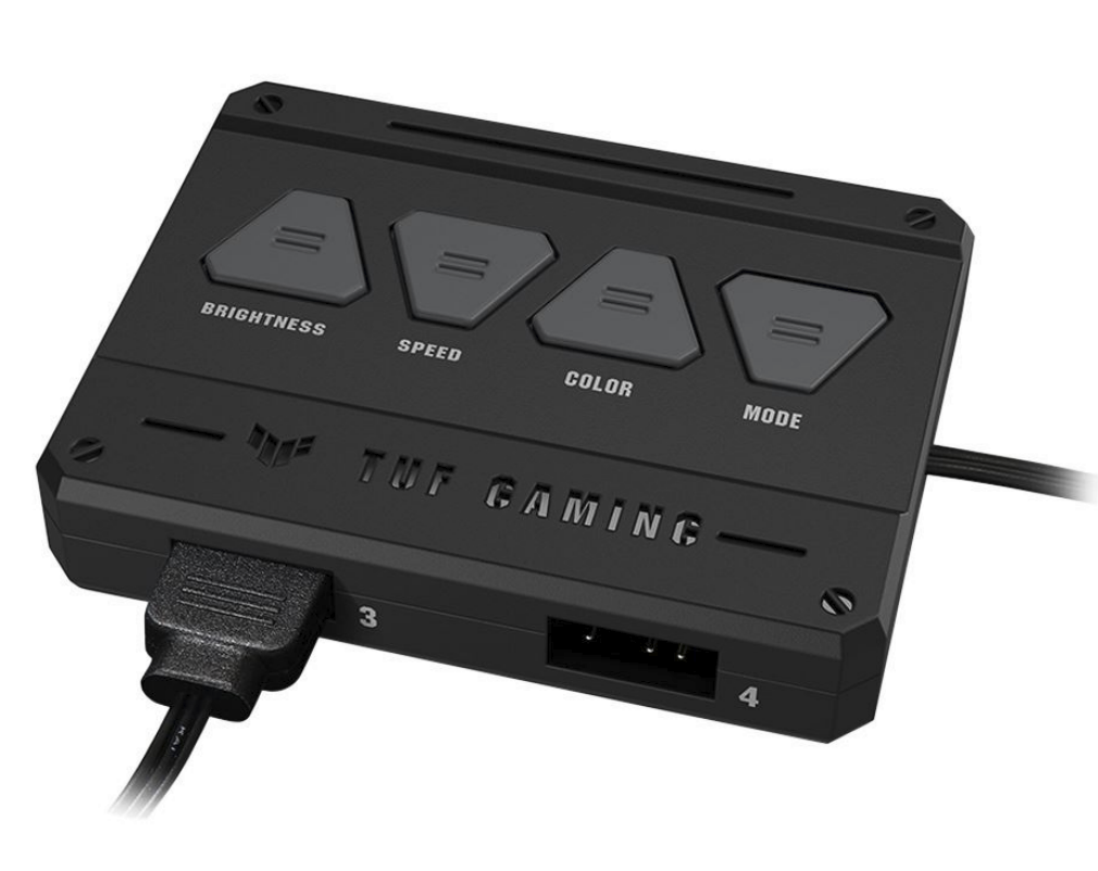

There doesn't seem to be much info about the fan hub. Does it have only 4 ARGB ports, or are there also 4 PWM ports? You can plug the ARGB cable into the hub and use the buttons to control them or, as @Poinkachusaid, you can use SignalRGB or OpenRGB.
If the hub doesn't have PWM ports, you can buy a PWM hub or splitters or, if you've got lots of PWM headers, use them all.
Fan speeds can be controlled by your mobo software or BIOS fan curves, or you can use 3rd party software like Fan Control by Rem0o. As they said, the 4 fans will act as one. If you want individual control of your fans, you'll need enough headers, or you'll have to buy or build a fully functional fan controller
Yes, using the 4 Asus fans like that is great. My suggestion about the fans remains the same, although I invite you to experiment by first adding one of the old fans on top in the rear port.
Before adding old fans on top, download and install HWInfo or some other program (including your mobo software) that will show you the temps for the CPU and GC, and either play a game or run a benchmark like Unigine Superposition or a 3DMark benchmark like Time Spy, Port Royal or Speed Way. 3DMark is better because it will track the temps for you, so you won't actually need HWInfo.  Note the temperatures for the CPU and GC. Screenshot it or, if you use HWInfo, you can use the record function in the main window to save the data. You can also select specific temperature sensors to be displayed on your screen with a graph, minimum, average and maximum temps of you want.
That's your baseline. Now add one fan on top and run the same benchmark. Note the temps. Add another fan and repeat. Feel free to try different locations for 1-2 fans on top to see what gives you the best results.

It is just 4 headers RGB hub/controller btw.
Hence why they bothered with adding 3to1 PWM adapter cable.
https://www.microcenter.com/product/651071/asus-tuf-gaming-tf120-argb-chassis-fan

i ll definitely try this and share the results here, i have just one question about HWINFO regarding the cpu temp, i have two sections for it and only one show temps that are split into multiple section, which one is important to keep track of? and i noticed that under heavy load it shoots to 95 sometimes and goes back down, after some research i learned that its normal for Ryzen 7000 series to do that, is that true? image.png.50b63d29dab0ca04355082d5f89bd491.png
