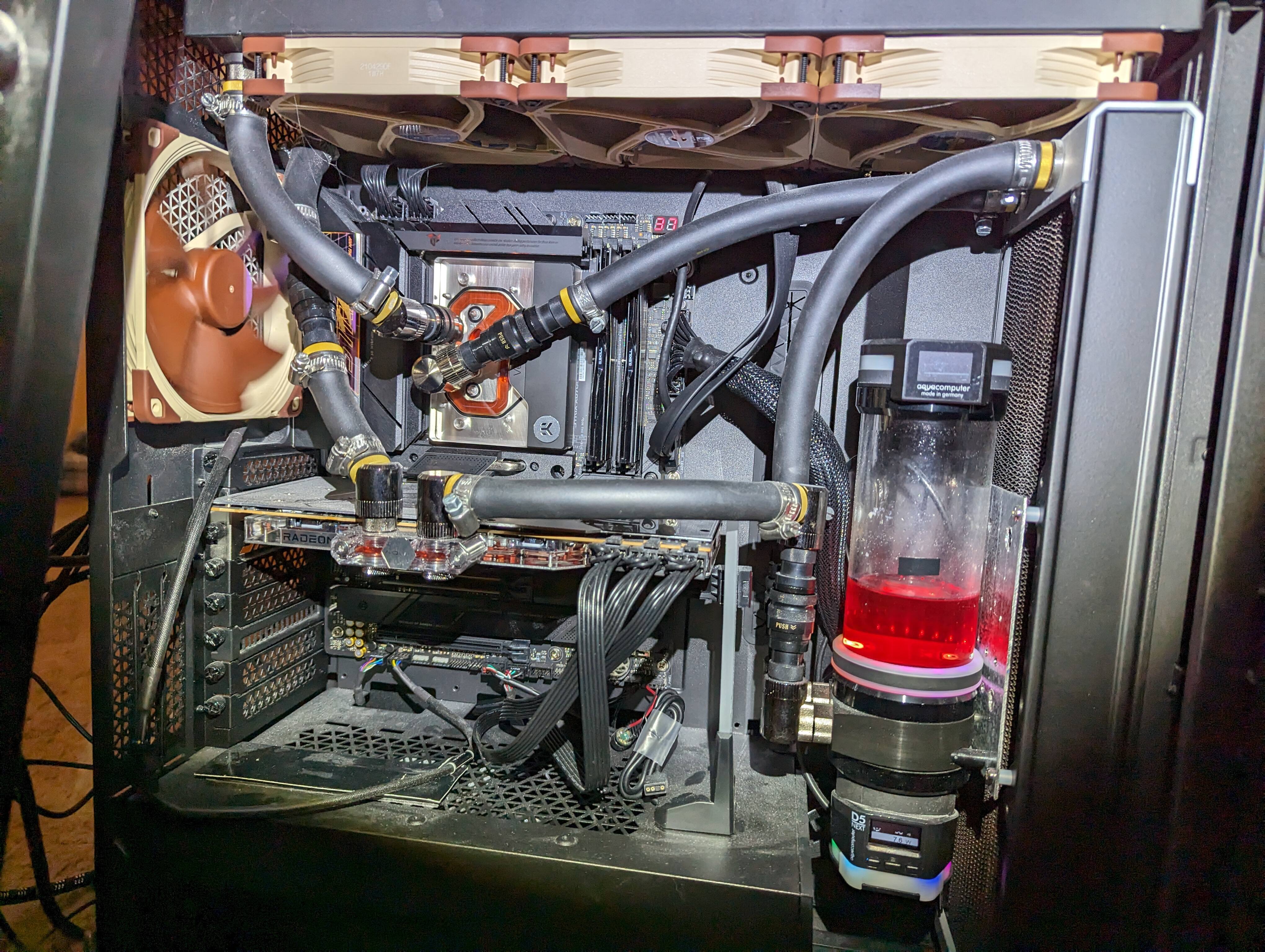

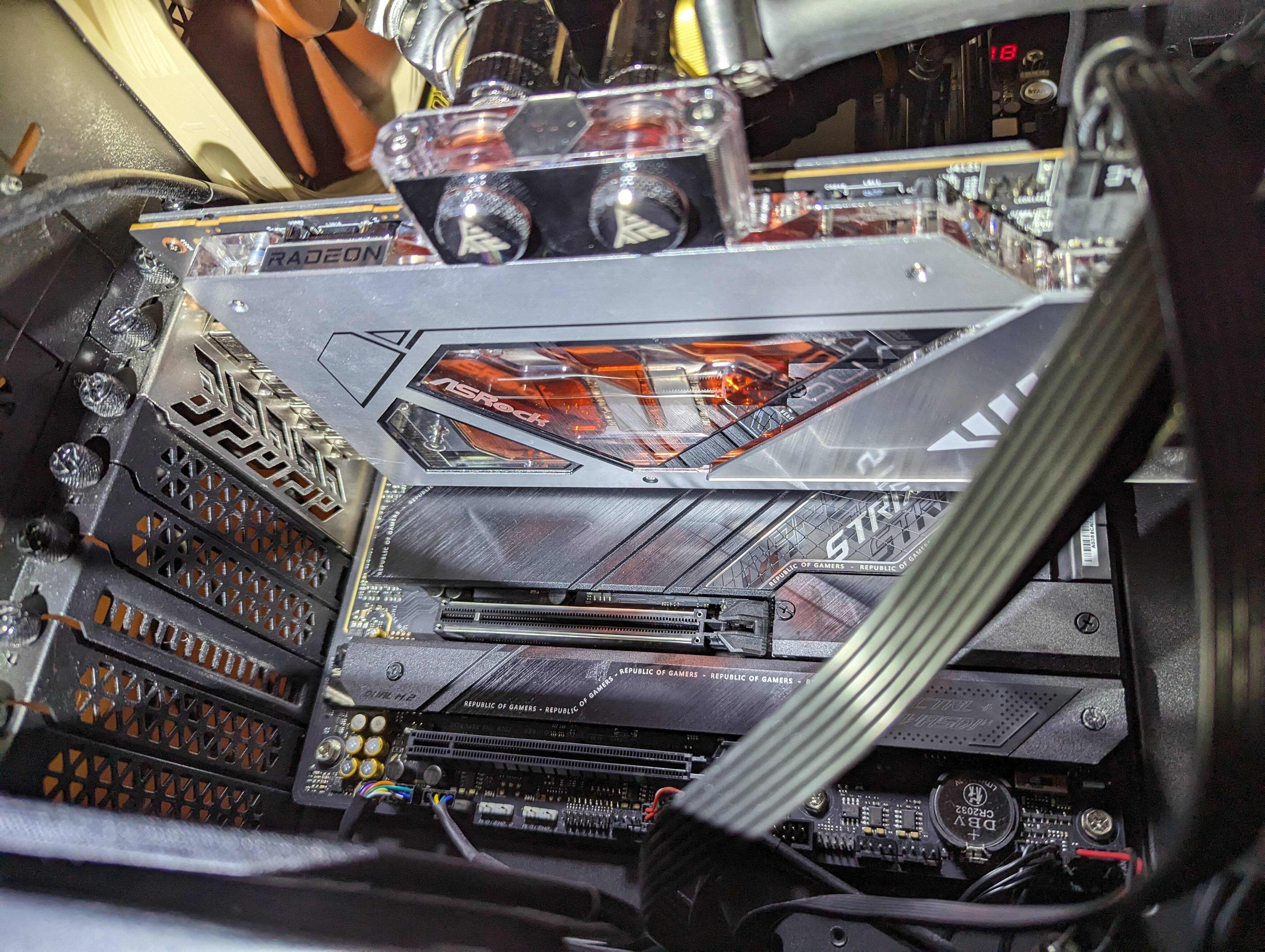

I'm attaching some photos of my system.

According to the liquid cooling quick start guide for that card the inlet is the port closest to the cable ports so I think you may have the flow reversed?
I just looked that up, and yes the inlet is on the left in my photos. Unless I have the pump backwards the flow is res/pump -> front rad -> CPU -> top rad -> GPU -> res/pump.
Ah I see, I assumed it was going the other way with cool water returning to the reservoir and then starting out through the gpu.
In hindsight, that might've been a good idea. I get a lot of pressure fluctuation because of the water heating up in the res. Though I'm under the impression it shouldn't *really* matter what order things are in, provided the flow is in the correct direction.

Yeah, I can't see the markings on my setup because of the fittings, but this guy's photo from reddit suggests the inlet is closest to the camera in my photo.

3. Right now in your loop the gpu is getting all its water on the downward direction which is the most likely way to get air bubbles through it. A good design for a loop would be wherever possible to have the water flowing up through the loads. if you push water up through a pipe there can't be any air in it because the pipe is full, water falling down is inherently more likely to bubble, like a waterfall would.
https://youtu.be/r_lrR_Y4_UM?si=CIC5s7INypsZlxNG
If you decide to change the loop up, definitely confirm the ports.

Damn, that's a good idea. I'm fairly certain there are no air bubbles, I've run the leakshield's deaerate enough times and I can't see any air pockets in the waterblock, but I'll definitely change things around next time I rebuild the loop.
