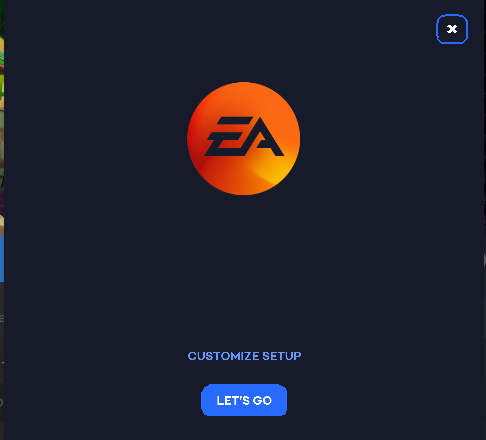

I recently bought Plants vs Zombies gw2 on Steam, and when I try to launch it using proton experimental, it tries to download the EA App, Microsoft DirextX, and the fails to launch, going back to the green play button. When using proton 8.0-3, it gets to opening what appears to be the EA App installer, which after clicking 'lets go', opens Link2EA, but with a graphical error. It's where I can still interact with the window as normal, but it appears as a solid color (picture below). When I try to use Lutris to install Origin(from the launcher) or EA app(from the website[both used the same method]) they both had the same outcome of spitting out an error code that, upon further research, didn't mean much. The big warnings that I took out of this is as follows(I will post the entire log in a follow up comment):

After all of that, it is pretty clear that I have dug myself in a pretty deep hole. Would it be easier to just fresh install and troubleshoot from there? I've been tinkering for a couple of days and haven't gotten anywhere.
