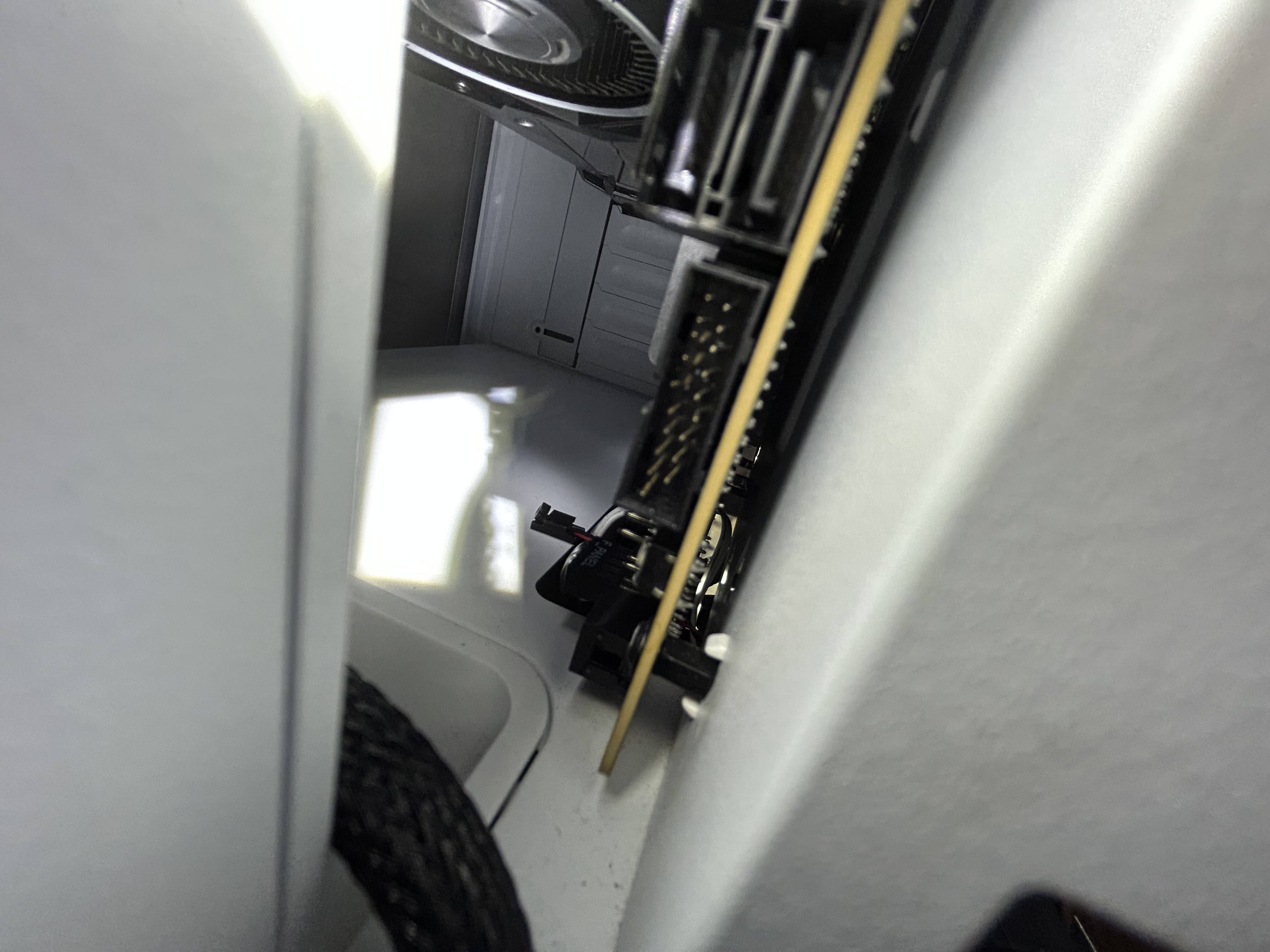

How f*cked am I? It’s for the front panel of my pc, I don’t particularly care about the front panel usb but it kinda sucks now that I can’t use it. What’s the best way to fix it? I just bought the motherboard from a micro center two hours away from me. Is it worth going back?

So it’s way more the one pin, the bottom half goes in fine but then the top half dosent go in at all, it’s like Half of the pins

Could you include a photo? A steady hand and a pair of tweezers are still what you need to fix it.

OK, that doesn't look like it's an entire row that's bent, more like just 6 pins (that could be the angle of the photo though, so that number might be slightly off). It's still not great, but it's at least better than bending an entire row.
Personally I'd take the board out at this time and start trying to bend everything into position. It'll make everything a lot easier.

Pretty much, the skinny ones from the iFixIt kit are probably the best (or at least that style of them is). It's not that hard, but it does require a lot of patience and a steady hand. Play some relaxing music or something else to calm your nerves first, then just go at it.

Well I guess I gotta take off the aio, I will when I get my new psu on Wednesday, I will update then

I fixed it!
