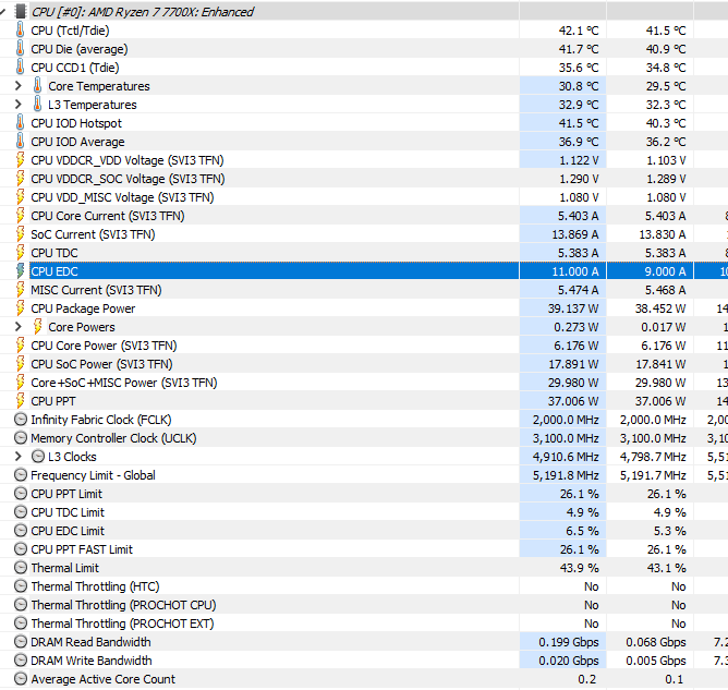

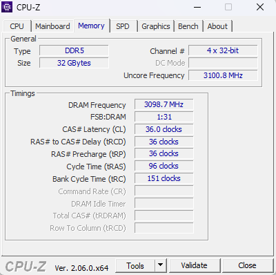

13 hours ago, RONOTHAN## said:
(NB Frequency, also called UCLK in HWInfo and Ryzen Master) is half the DRAM frequency, go into the BIOS and change the MEMCLK/UCLK divider to
it seems to be all in order based on what you said. Please check the images i uploaded and tell me what you think. I think is all good. the SOC even with cinebench running 10 min on multicore is staying always in 1,290 v and the UCLK is the same frecuency as the DRam too. so i think im good to go right ?
PD: this is the score i got when i finised the cinebench multicore test or benchmark and i even did a test with memtest64 and told me i have no errors.
Yup, that looks good. You'll get a slight performance improvement from having it at a slightly higher memory clock anyway.
