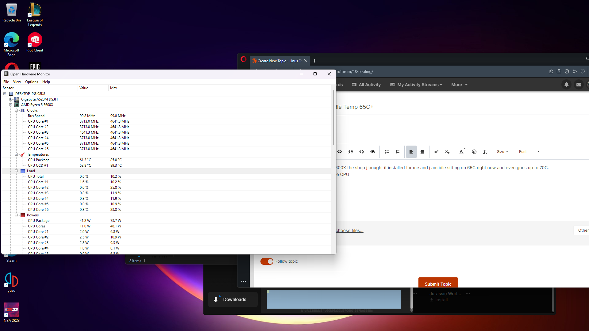

So i bought a new Amd Ryzen 5 5600X the shop i bought it installed for me and i am idle sitting on 65C right now and even goes up to 70C.

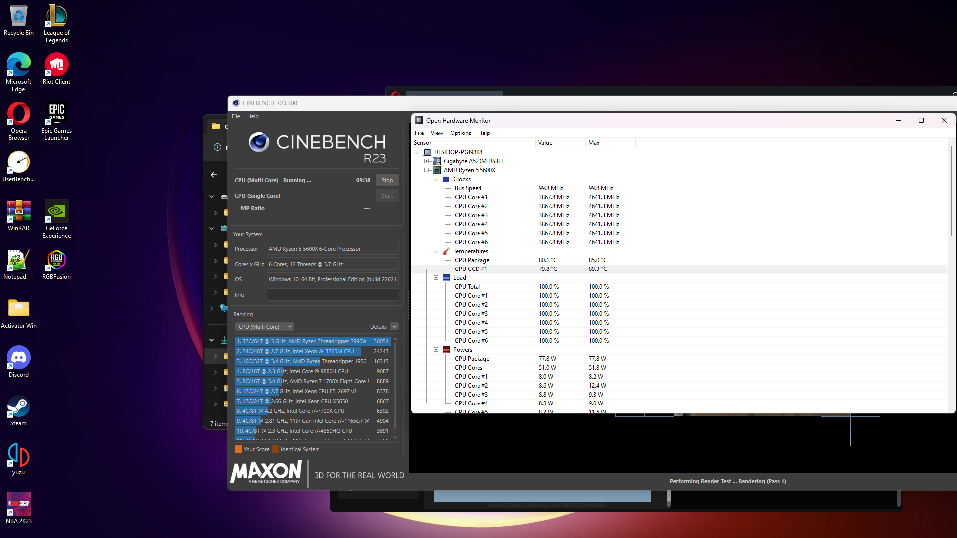

When i use Cinebench to stress the CPU it doesnt get more then 85C that i think is normal.
Even on 85C i dont feel hot air coming out of the cpu
Any ideas?

I would return it to whoever installed it and point at the temperatures. 65-70 idle is not ok regardless, especially for a 5600X.
Your cinebench just being started and it's in the late 80s is def not working correctly.

i just removed cpu fan and everything looks normal my case flow is good i think i have 2 fans in front sucking in air one back pushing out air and one in the top pushing out air
any chance my windows install is reading wrong or smth every time i go to the bios my cpu is sitting around 50-55C

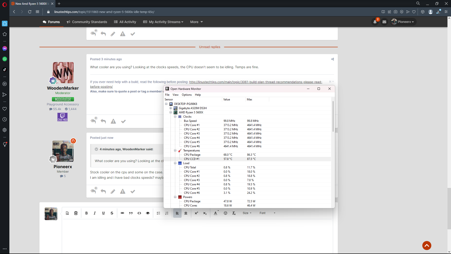

I cant understand it i have been idle for about 2 hours and i have 65C atm doing nothing and i dont feel hot air on the cpu cooler i even installed by my self to see if its correct.Maybe they put bad thermal paste?
What cooler are you using? Looking at the clocks speeds, the CPU doesn't seem to be idling. Temps are fine.
Stock cooler on the cpu and some on the case.
I am idling and i have bad clocks speeds? maybe its a bad windows install cause i have a feeling thats the problem
Those aren't bad clock speeds. They're just not idling and that's normal since background processes can cause the CPU to boost. Temps seem normal with a stock cooler and perfectly safe.
