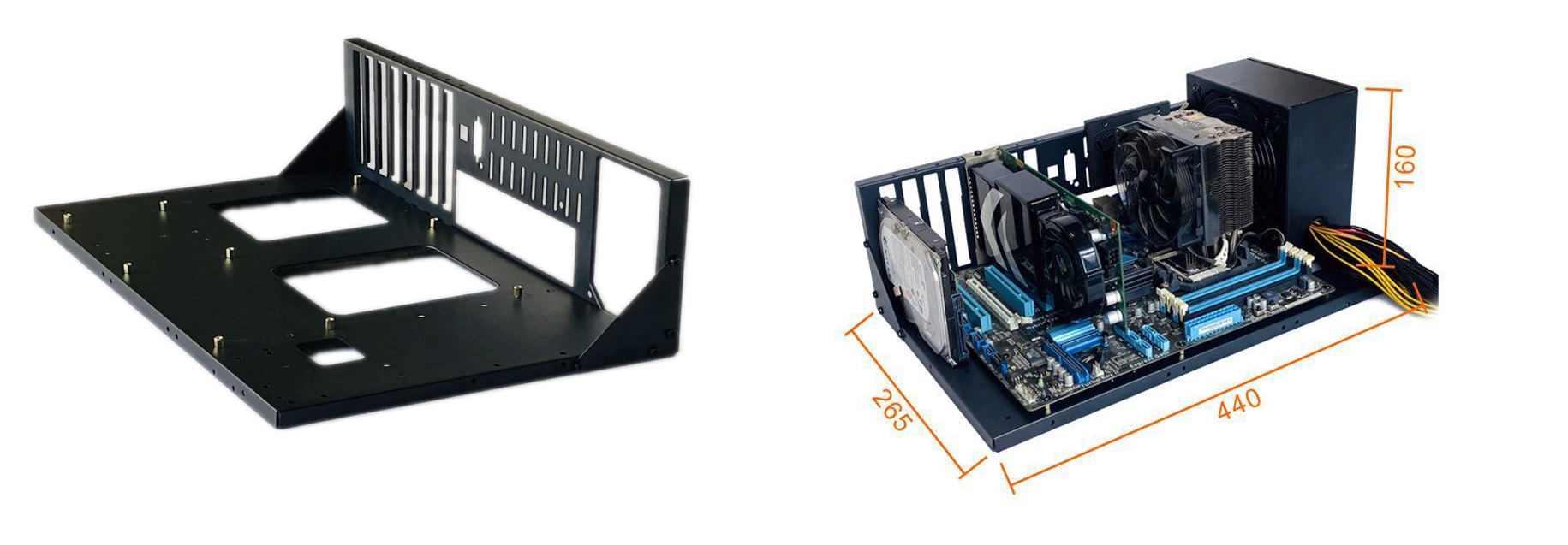

And then it hit me. This chest of drawers my display and stand are sitting on are relatively empty at the moment. I'm not likely to use all the drawers, either. The two small ones topside measure 5.5" H, 21" D, 14.75" W. Quite spacious, so maybe I could transfer my components to an open-air test bench, like the one shown here, and mount it to the floor of the drawer. Newegg has this one for $23. A larger one appearing to have more space for larger mobos or perhaps more drives is available for a bit more.
However, my existing Mugen 5 measures 6.08 inches tall, and I'm not sure if that includes motherboard / CPU / standoff height. There is a bit more vertical clearance inside the drawer cabinet, but I'm wondering how much finagling it will take to make this work.
The beauty of this idea is that I can set up two systems if I want, one for gaming, one for media NAS (I have several laying around), maybe even run a dual system off of one power supply. I wonder about cooling, but I can probably work this out, and maybe this would be an excuse to go liquid cooling (not my first choice)? Or would it really be necessary? Anyone think the Noctua low-profiles will keep my 5900X cool if the Mugen 5 won't fit?

Worst case router the wood thinner
Mesh front and have fans blasting air in. The pcie slots in the back will provise enoigh air out for the gpu

So, after some thinking, headscratching, plotting and conspiring, I noticed the lower drawers looked slightly taller. Measurements reveal they are. A whopping 6.5" D, 30.5" W, with the same 21" depth. So my existing components should have no problem fitting in the lower drawers, even with non-standard plastic standoffs.
Theoretically, I could even set up dual systems in the first wide drawer. Although the barrage of pump failure / evaporation horror stories I've read make me leery of liquid cooling, it occurs to me the two top drawers can each fit a 280 front and rear, with room to spare, if I elect to do so. And I have to admit, I've been toying with the idea of a custom loop -- if a better pump setup can be cobbled up. And I've had some ideas.
OH, BOY, have I had some ideas. Automotive in-tank electric fuel pumps last a LONG time. Most multi-port injection systems use 30-70 psi or more, but throttle-body-injection systems use a mere 9-13 psi of pressure, which should be low enough not to stress the fittings and tubing. I'm sure an ATX PSU has at least one output with enough amperage.
These pumps are designed to be submerged, but I'm considering using a 2-3 ft section of 8" PVC pipe I have laying around, it would make a great reservoir with the right caps and sealing. I've wondered about submerging the radiators too, possibly a fully-contained system, with only a supply and return from the cooler plate.
