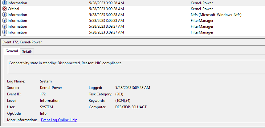

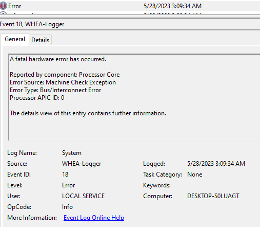

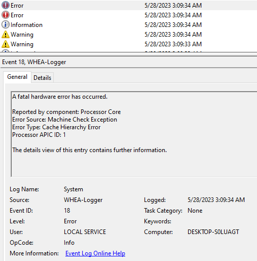

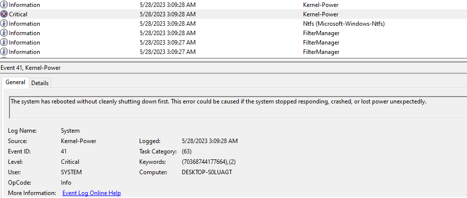

One more thing, after a crash I find in the even viewer a kernel power error like shown in images.

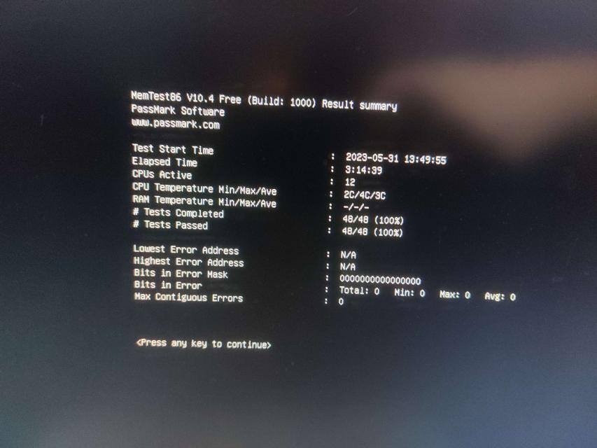

run memtest overnight, this seems like a bad memory stick.

Looks like CPU thread dropping, as when they don't have enough voltage, don't see any fix
Either CPU bugs out else the board don't work correctly, seems a quite old system
Your mobo is quite crap honestly, I'd change it for a B550 or at least B450 one ($70-$100 used, +$30-50 new ), if crashes persist upgrade the (quite old) CPU to at least a 5500 (less than $100)

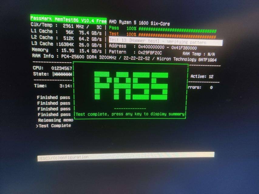

i ran MemTest, and it doesn't seem to be the memory, zero errors as far as I can see.

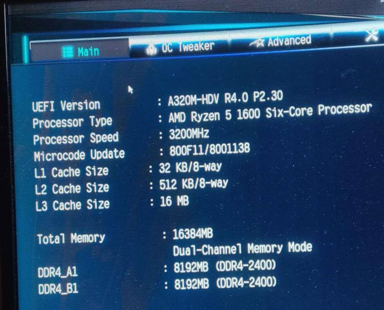

I'm not sure but here is the UEFI version of my motherboard, that should be it right? Google says that the latest UEFI version is UEFI 2.9, although I am not sure which number here would be the UEFI version number, sorry.
This is your board and the latest Bios is 8 something.
You have version 2.40.
https://www.asrock.com/mb/AMD/A320M-HDV/index.asp#BIOS
You need to flash P3.40, then P5.50, then P7.00 and then you can flash the latest.
Since you've on an extremely old bios, the new Bios will highly likely solve all your issues.
