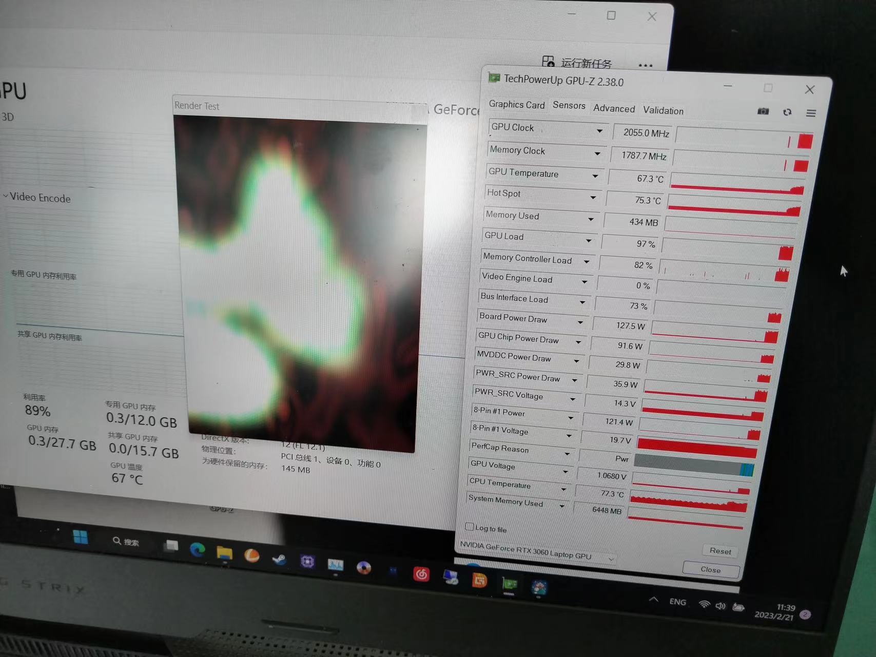

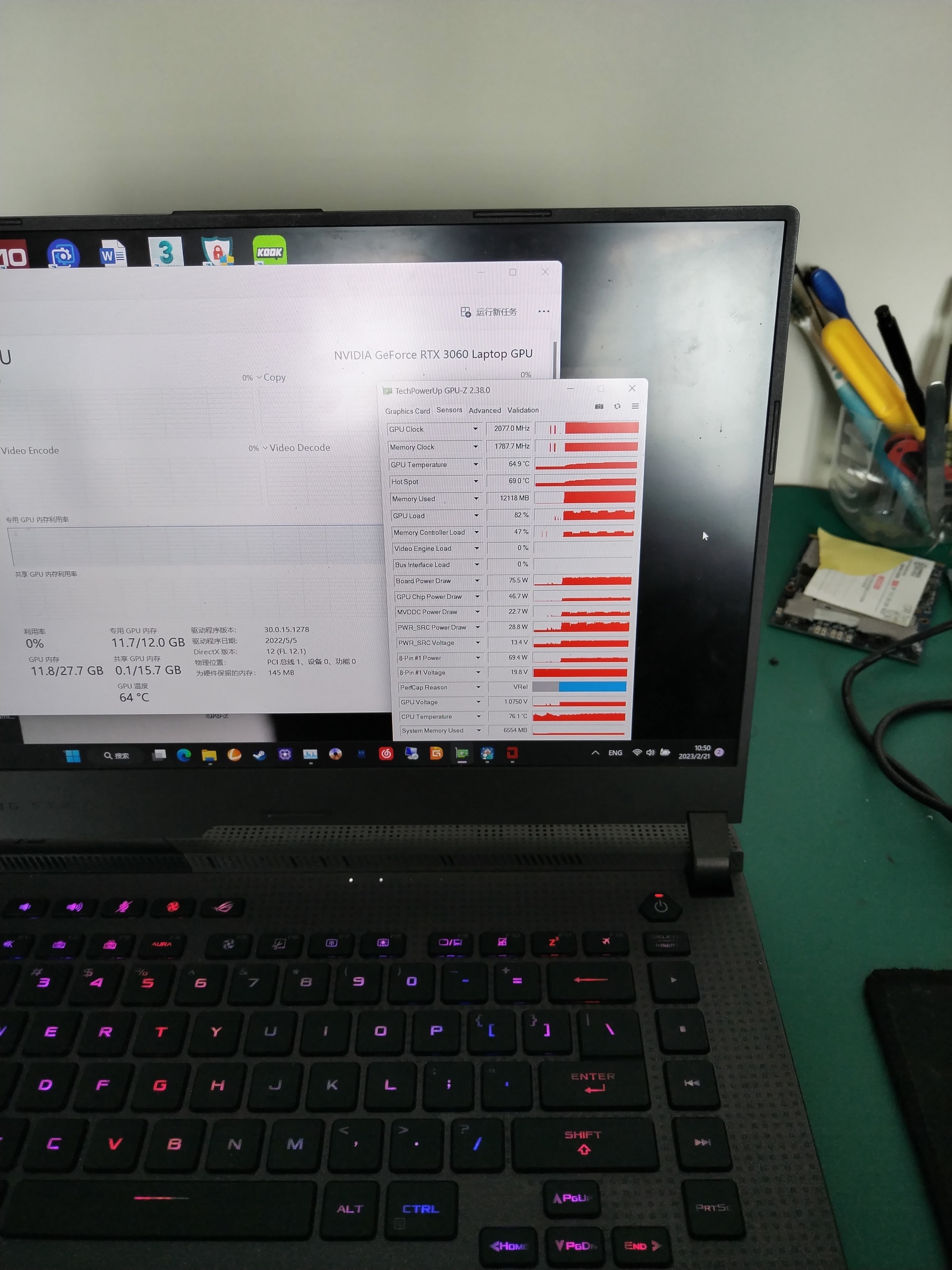

I'm from China Mainland.We have some tricks on Modifying VRAM
I’ve already modified and tested the 3060 Laptop with 12GDDR6 instead of 6.It seems like NVIDIA had a idea of launching a 12G model of the laptop 3060,but canceled with some reason.We have confirmed all 30s have the native support of 16Gbit SAMSUNG memory so we did the swap on this particular card and it has been proved to be success.
In theory,3070 3080 3090can be modified too.I’ll try it then.
with 12Gigs of VRAM,3060L proved to have better performance than Desktop ones.
https://linustechtips.com/topic/1489557-3060-laptop-with-12g-vram/
Well that’s neat. I’d like to see some bar charts similar to what Linus tech tips puts out on reviews for stock vs modified in certain games, resolutions, etc.

I was his friend and collaborator. After testing, the graphics card can maintain 130w power consumption, as shown in the figure.
Our next plan is to convert the rtx3090ti to 48gb vram. Since the rtx3090tupcb board only has one layer of video memory particles, we plan to transplant the rtx3090ti to the pcb of rtx3090. Why not retrofit it with rtx3090? Some technicians in China have tried to modify the rtx3090, and finally failed to run properly due to bios problems, which do not exist in the rtx3090ti bios.
