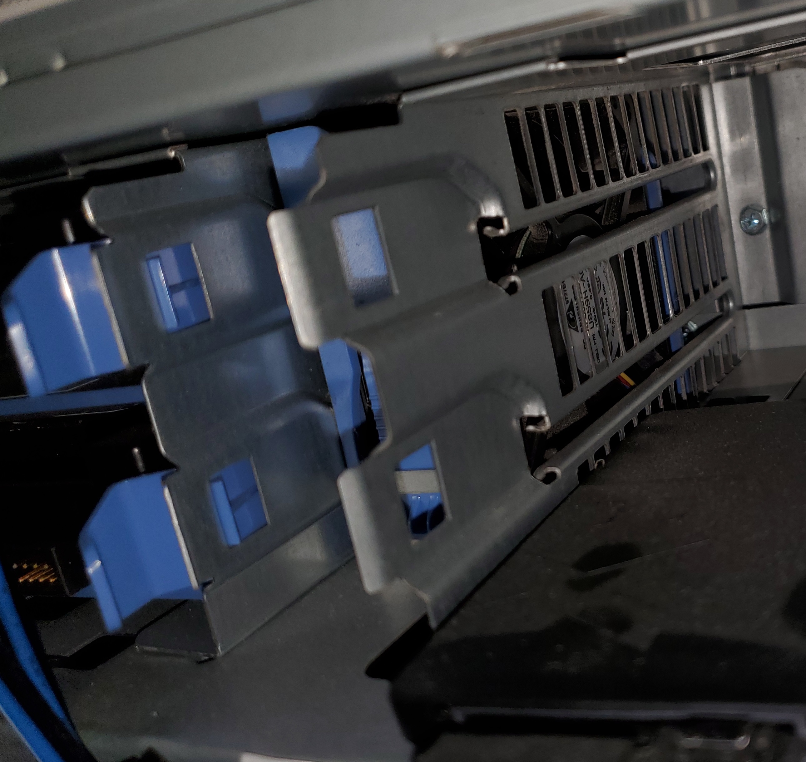

I have a repurposed Dell Precision T7500 workstation that originally had an OEM 1100 watt PSU. Recently, said PSU decided to die on me.
Before said demise, the system was dual Xeon X5570s, a Zotac GTX 970 GPU, 32 GB of RAM (if I recall correctly) in various 2GB and 4GB DIMMS, a 240 GB Crucial SSD for the OS, and 2 250 GB Western Digital Velociraptors.
From factory, the system also comes with dual front fan assembly ( 1 x 120mm x 120mm x 35mm PWM fan and 1 x 150mm x 150mm x 50mm PWM fan approx.), a hard drive cooler fan (80mm x 25mm), a passive heatsink for CPU 1, an active heatsink for CPU 2 with 1 x 80mm x 55mm (approx.) pwm fan, and 1 x 120mm x 35mm rear PWM fan.
At present, my main concern is advice and recommendation on what wattage of PSU I need to get the system up and running again but also allow for future upgrades like a newer GPU and maybe 6 core Xeons, if budget allows. A few PSU calculators have recommended 600 watt PSUs but that seems a little low, especially with possible future upgrades.

The other part I am concerned about is, upgrading my fans. Overall, the system is much louder than I'd like. Especially with an ear problem making certain frequencies extra annoying.
However, with my research, I am unsure which fans will do an adequate job of cooling as opposed to what I have now.
So, any help with that, also, would be greatly appreciated.
In general, my biggest concern is the PSU but would very much like advice about fans too.
Thanks VERY much in advance and I look forward to hearing back from you.
P.S. I have included the layout of my tower and shown the fan locations. There are also a couple tiny fans on the motherboard but, am not expecting to be able to upgrade those.

At present, 2 of the case fans are already 120mm (top of front cage, and rear case fan) and 1 is a 150mm (at the bottom of the front cage), but, what I am unsure of it what kind of CFM rating I am going to need for adequate cooling and flow.

At present, I've been considering swapping out the 120mm fans, front and rear, to see if that makes any difference.

Yes, I am aware that the 150mm is uncommon and have resigned myself to the fact that I may be stuck with that one, unless I try mounting a 140mm in it's place but will have to see.
The 80mm fans are between the hard drive cages and 1 on the 2nd CPU active cooler. Still researching quiet versions of those.
