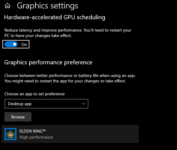

Hey guys. So whenever i play any game it doesn't matter what game it is, my pc only uses CPU and it doesn't use GPU my monitors are both plugged in the GPU,I added the game in the Nvidia control panel too, I set the performance to high from the Graphics settings in the windows menu but nothing seems to work. Please help me

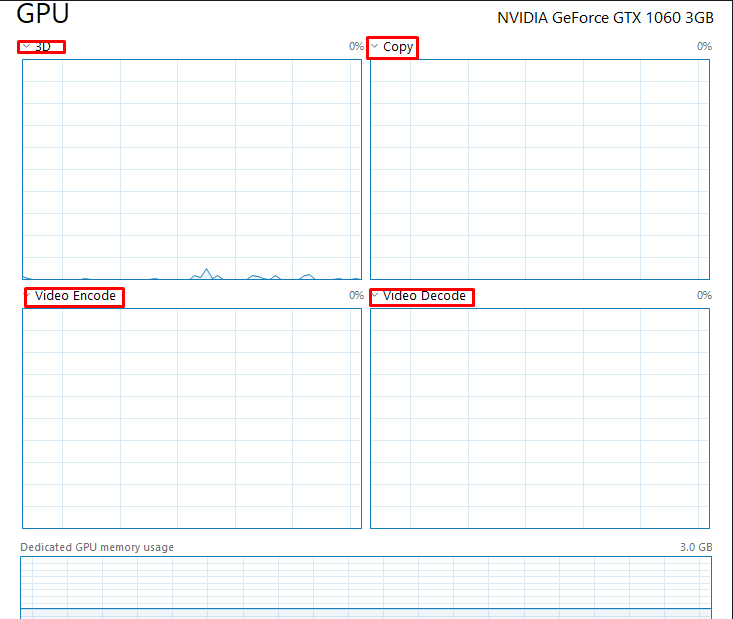

Have you also been to the Performance TAB, clicked on GPU on the left side, then at the graphs you see, selected another graph from the about 10-15 options?
Because Windows task-manager doesn't display GPU usage to well all the time. And for some cards and/or with the wrong drivers it just wont show up at all.

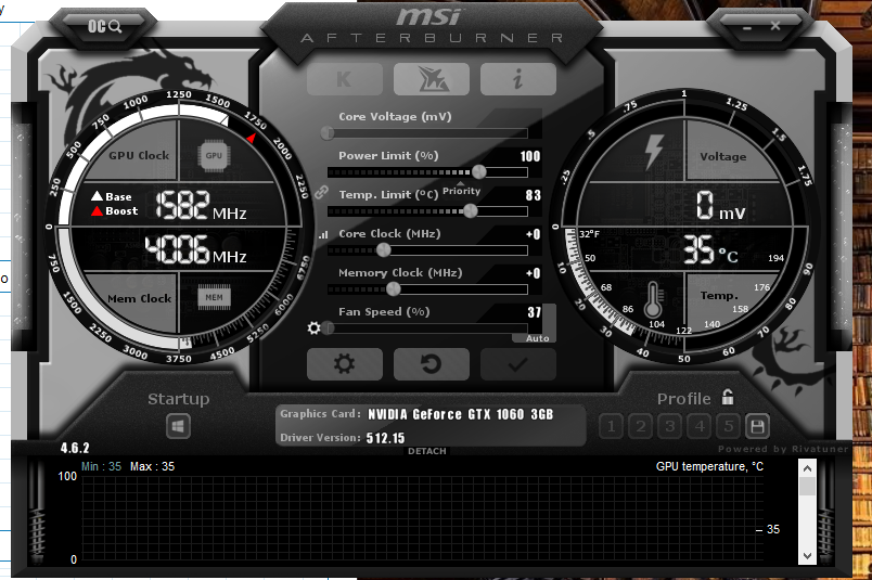

That CPU shouldn't bottleneck a 1060 that much. Can you download MSI Afterburner and see what usage that says?
Maybe you're monitoring the iGPU and not the 1060?

Download the GPU-Z and actually monitor it.
I doubt a game is "using zero GPU" unless you have plugged in a software-GPU device like a USB-dock.

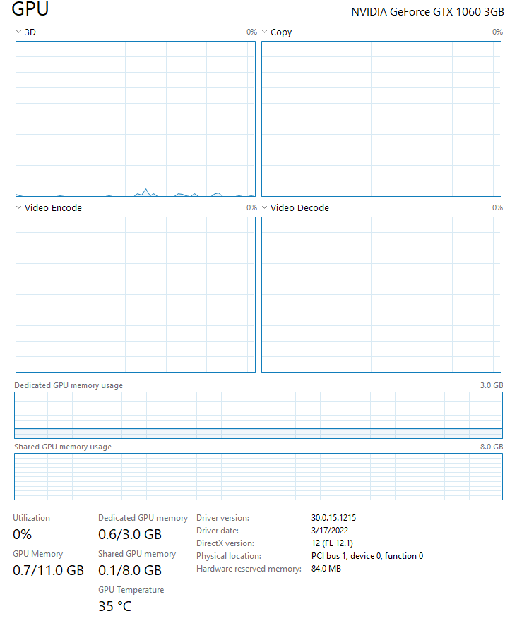

I've got no idea what you said but im just gonna send a screenshot
Either Task Manager doesn't read the sensors correctly, or ... maybe because you Alt+Tab and the game is minimized/paused the video card is not busy rendering the game, so it shows as less or no activity.
Get something like MSI Afterburner or some other software that can monitor and take measurements every few seconds and make a graph ... leave that in background and play the game for a few minutes and then come back to that and see the graph.
In the picture above, you're looking at the TEMPERATURE of the video card. it's possible it just doesn't measure the right sensor and always shows 35c.

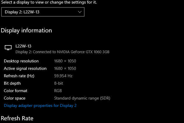

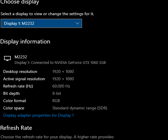

Sharing some specs is the only thing i understood so here!
1 minute ago, mariushm said:
Do you use the integrated graphics from CPU?
Move the video cables to the dedicated video card.
the cables are on the right place i think
On that screen you can click the "3D" "Copy" "Video Decode" and "Video Encode" to put other measures there as your GPU can do a lot more then only those 4 things.

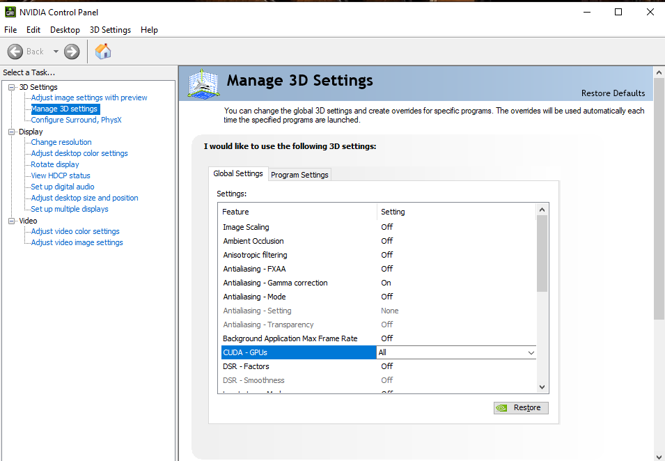

But i would start with resetting the 3D options in the NVIDIA control panel.

Some games do not report GPU usage in Task manager, need to use other tools to see the real usage like GPU-Z or Afterburner.

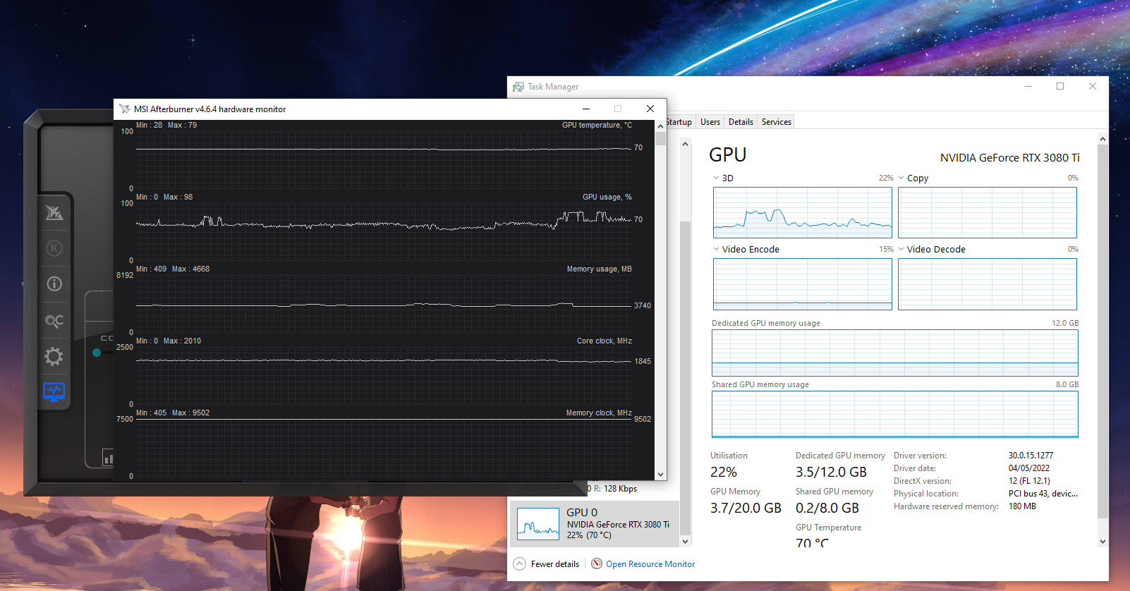

Like others have said, Task Manager can be really inaccurate, especially with GPU usage. For proper GPU monitoring there's a few good options:
For MSI Afterburner, if you chose to install RivaTuner during the initial setup, you should be able to set up an OSD you can pull up in-game to see various stats, I usually do this when troubleshooting games (I set it to show all GPU sensors, CPU core/thread usage and temps, and then framerates and frametimes as a graph). The settings for that should be under the "Monitoring" tab (and then "On-Screen Display" for setting the keybind to toggle it on and off).
