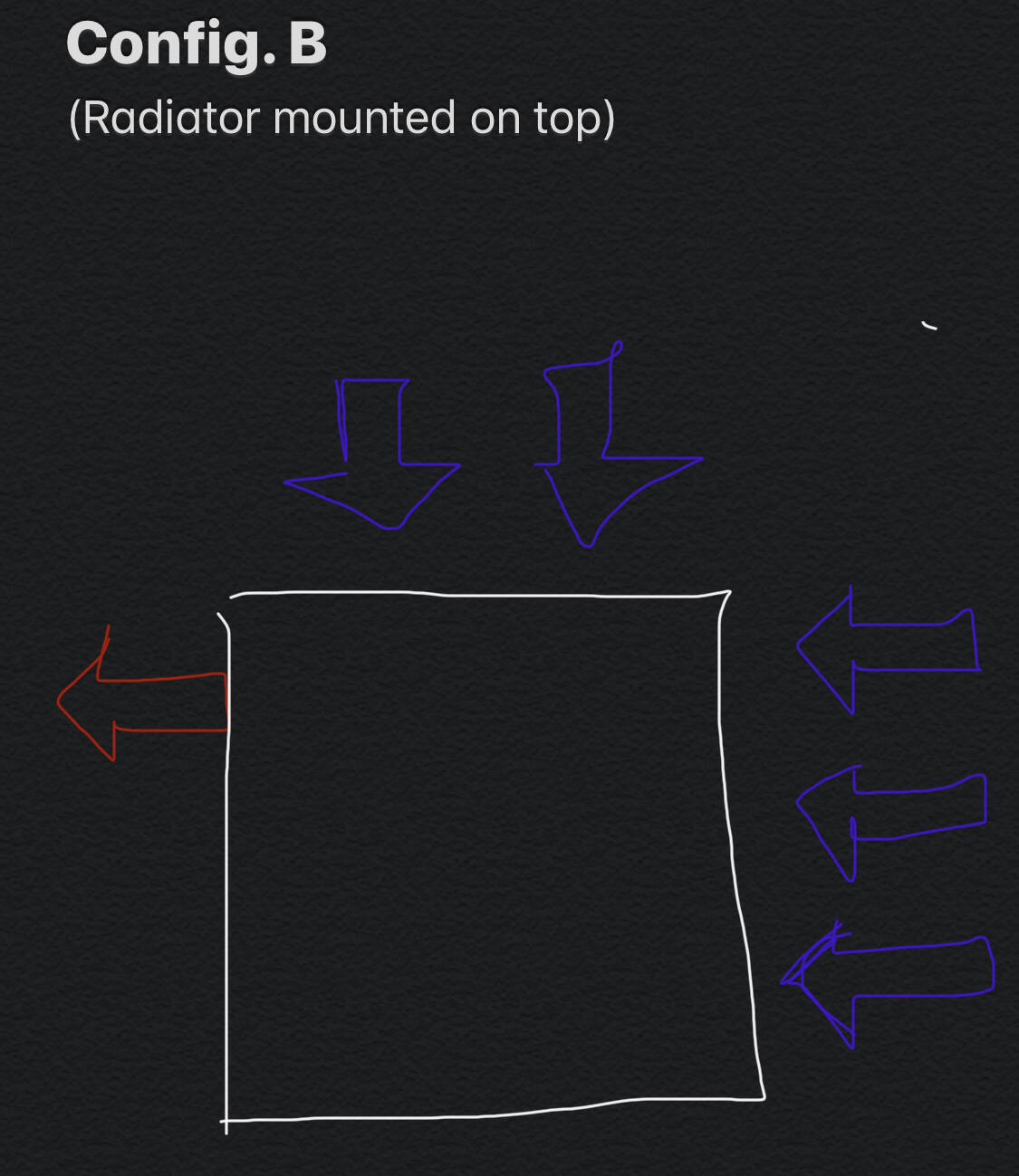

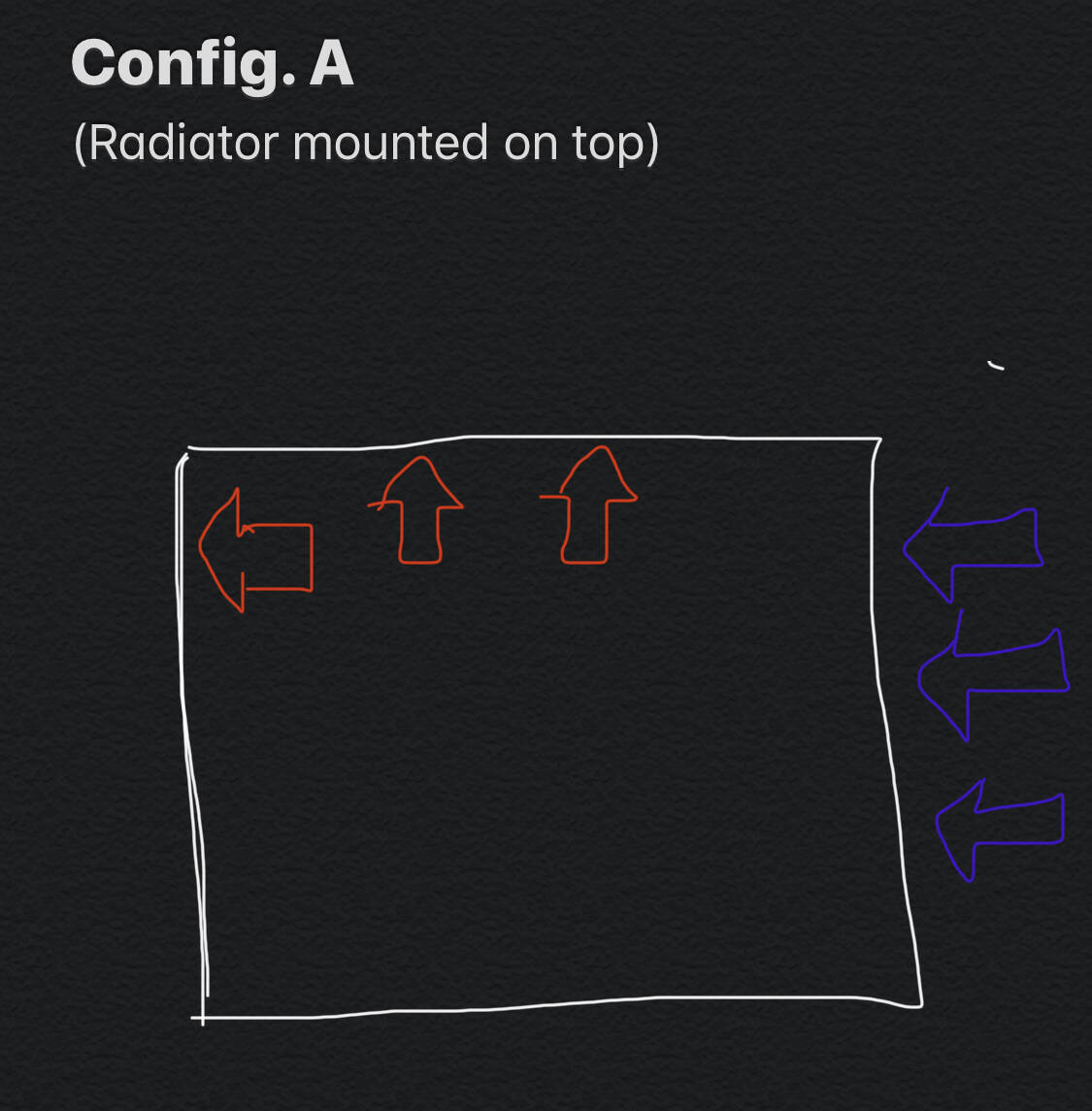

Either will work. Since rad is on top, doesn't really matter which way its mounted. As intake it will be bit cooler than as exhaust.
Ok, so I have a case (Corsair Obsidian 500D RGB SE) that comes with 3 120mm fans, then I have 1 extra identical fan, and I have a Corsair H100i RGB Platinum cpu cooler (w/ 2 120mm fans). I currently have 2 possible configurations (see professionally designed images below). Both of them have the radiator mounted in the top, 3 front fans and 1 rear. Basically I’m trying to figure out whether I should mount the radiator fans as intake or exhaust. I’m torn because I know it would be better for dust if I mounted them as intake, but I feel like there could be some problems associated with a 5 intake/1 exhaust ratio. I’m running a stock R7 3700X and RTX 2080, and I don’t plan on OCing at any point in the near future, so to me dust buildup is a bigger worry than thermals. Any help / suggestions are much appreciated!
