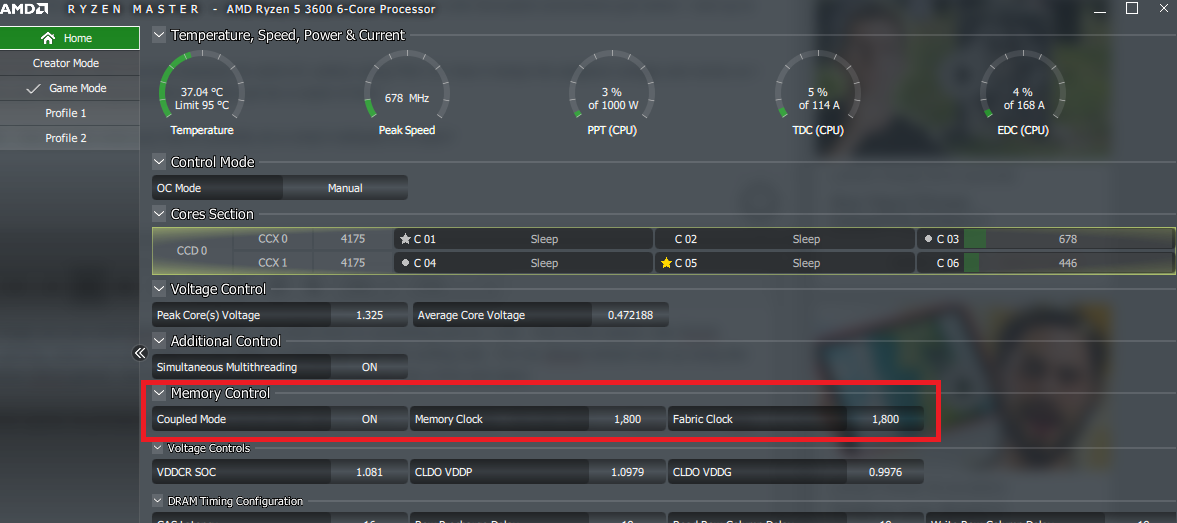

so what does fclk default to if set to auto?  Would it just be half of the slowest ram for ryzen? Can you check what your fclk is running at (I didn’t see anything in bios for its current rated speed but I’ll check again tonight), Confusing.

so I guess my last bit of confusion is fclk.  Can you test what your fclk is currently at or what it defaults to in auto?

FLCK should be automatically set to half your rated memory speed, its probably already setup up as such, almost always is automatically.  You can check it in Ryzen Master i fyou want.
Yea I just found that info.  Seems it will auto set it to half up to 3600 (which is what I have) so I’ll only need to manually set it if I decide to try running 3800/1900 OC but I think right now I’m good where it is.  BF 5 and new COD are probably the most demanding games
