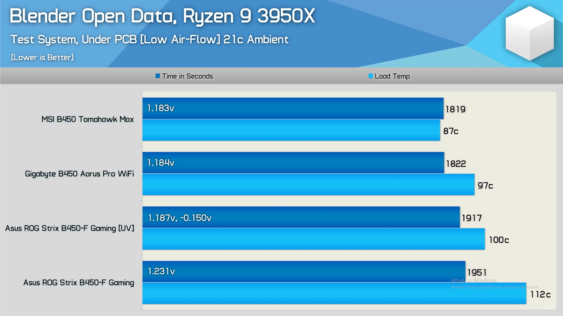

The ASUS ROG Strix B450-F is overpriced and among the worst B450 motherboards there is, it gets destroyed by the significantly cheaper Tomahawk so it's better to not mention it.
Even undervolting it the VRM performance didn't keep up with the Tomahawk... stock for stock with the R9 3950X we can see the VRM on the ROG Strix peaked at 112Cº while the Tomahawk peaked only at 87Cº
That extra heat caused the 3950X to throttle reason why the performance was lower taking 1951 seconds to complete the Blender benchmark opposed to 1819 seconds on the Tomahawk.
A terrible and disappointing result to what was the most expensive B450 board on launch.
