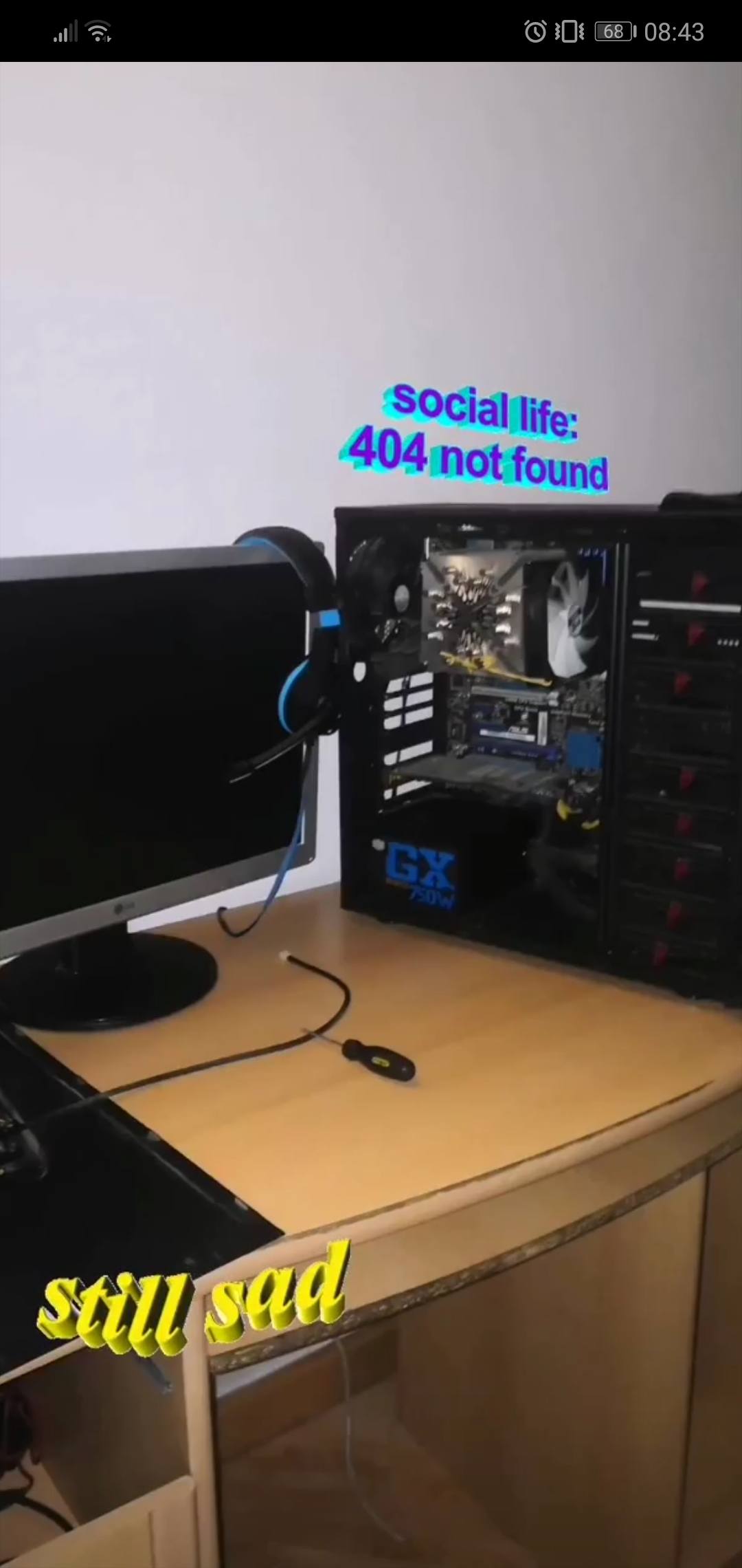

Hi everyone I am new here, so I need some help with my gpu I bought it on 24.November its an AMD Radeon RX560 4GB Gigabyte edition and it has been working since then, but last night i turned on my pc and there was nothing showing up on my monitor, the monitor whic I have is an LG Flatron W2242T I bought it back in 2016 and it was working perfectly. So yeah nothing was showing up and I saw that my fans aren't spinning at all, I was shocked first so I turned off my pc and took out the front panel then I removed the gpu and I puted back in and it didn't start spinning when I turned the pc on, only few seconds later after the start up, and then it stops few seconds later.Sometimes it dosent spin at all and sometimes it does but still no signal to the monitor.So what should I do? Had a spare gpu whic is the NVIDIA GeForce gt 9400 so i decided to remove the 560 and put this one, the fan strated spinning and everything but still no signal to the monitor. Can anyone help? I would really appriciate it

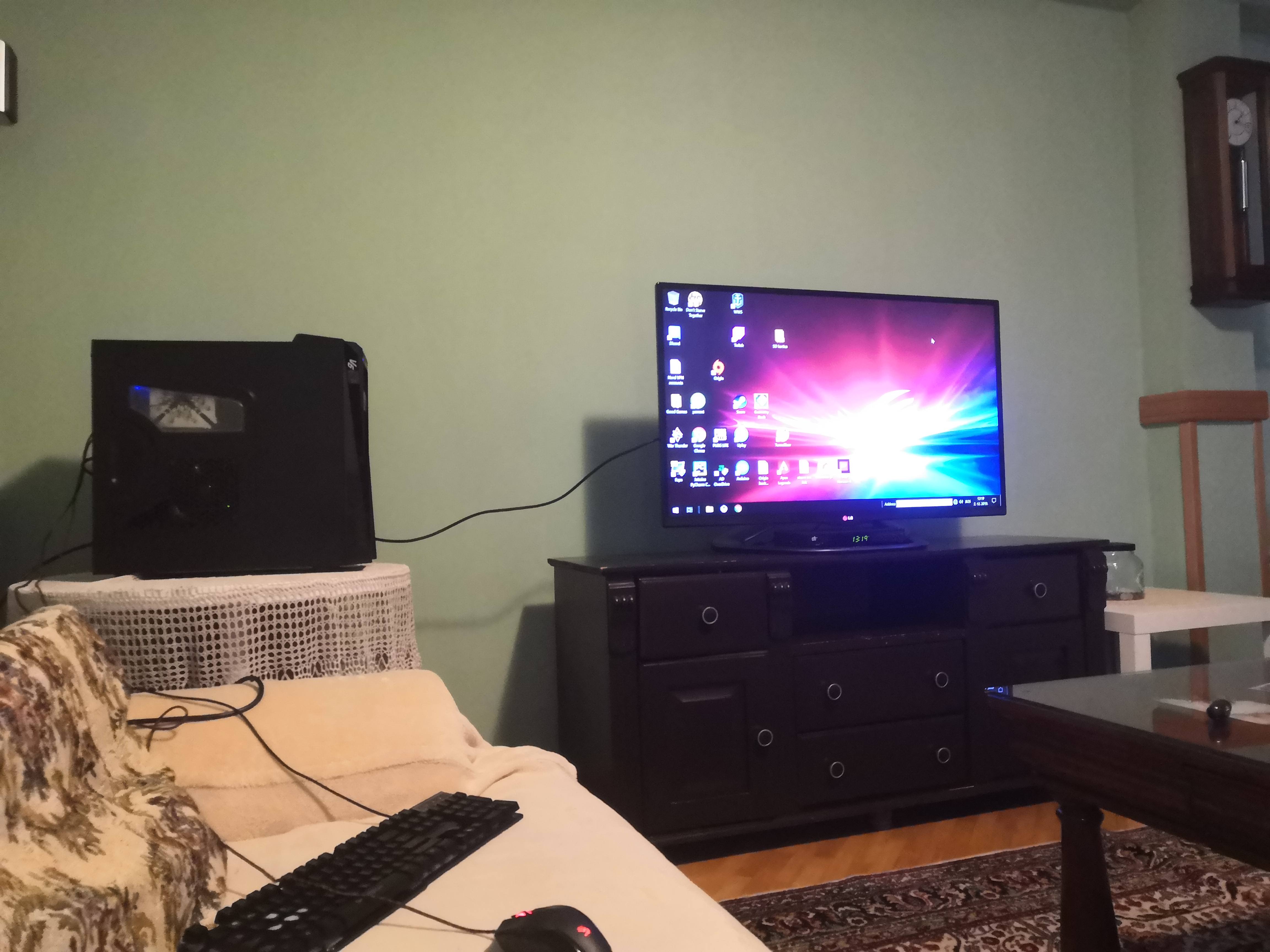

Hey bro i did what you said and everything is working but the fans on the gpu are not spinning why?
I said :
5 hours ago, Plouffe said:
Hello,
When not running something using a lot of GPU usage, the fans won't spin (saw it on the url of your card).
As for the monitor I don't know, maybe it's dead :/
There is a no spin mode until you reach a certain temp (for me it's 55°C) then it will go in jet mode, try launching a game and see/hear if the fans start to spin, if they don't there is also a problem with the GPU.
9 minutes ago, Plouffe said:
After launching Apex Legends the fans started spinning
1 hour ago, Plouffe said:
So your monitor or adapter is dead :/
Anyway like I said launching a game does make the fans start to spin and they continue to spin eaven when i am done playing but is that okay for the gpu like will I run into problems?
Just now, Plouffe said:
Well if it was DVI, it wasn't 1080p I suppose ? So might as well buy a ne fancy 1080p monitor :)
Yes the monitor is not 1080p the resolution was 1680x1050, yeah I will see what can I find on the Internet
