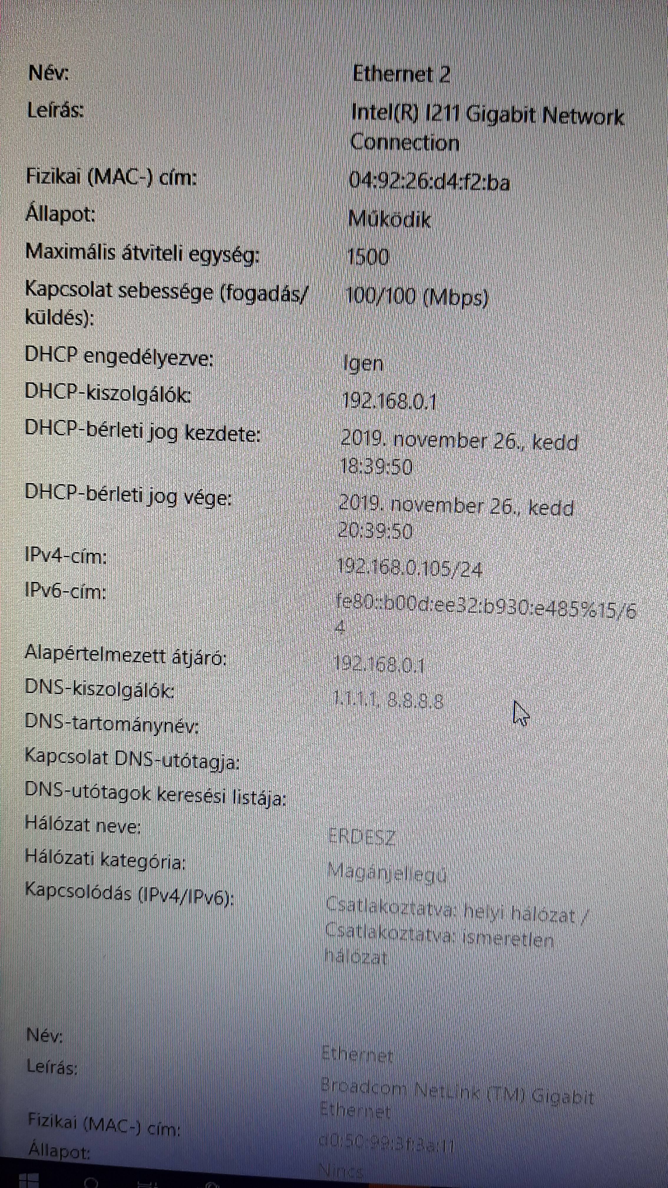

Right click Network > Open Network & Internet settings, then click on View your network properties. What does it show there?
You should have an IP address (that does not start with 169.254.x.x), a DHCP server, a default gateway (your router's IP) and at least one DNS server.

Yes I can see those. I know the pic is in Hungarian, sorry about that.

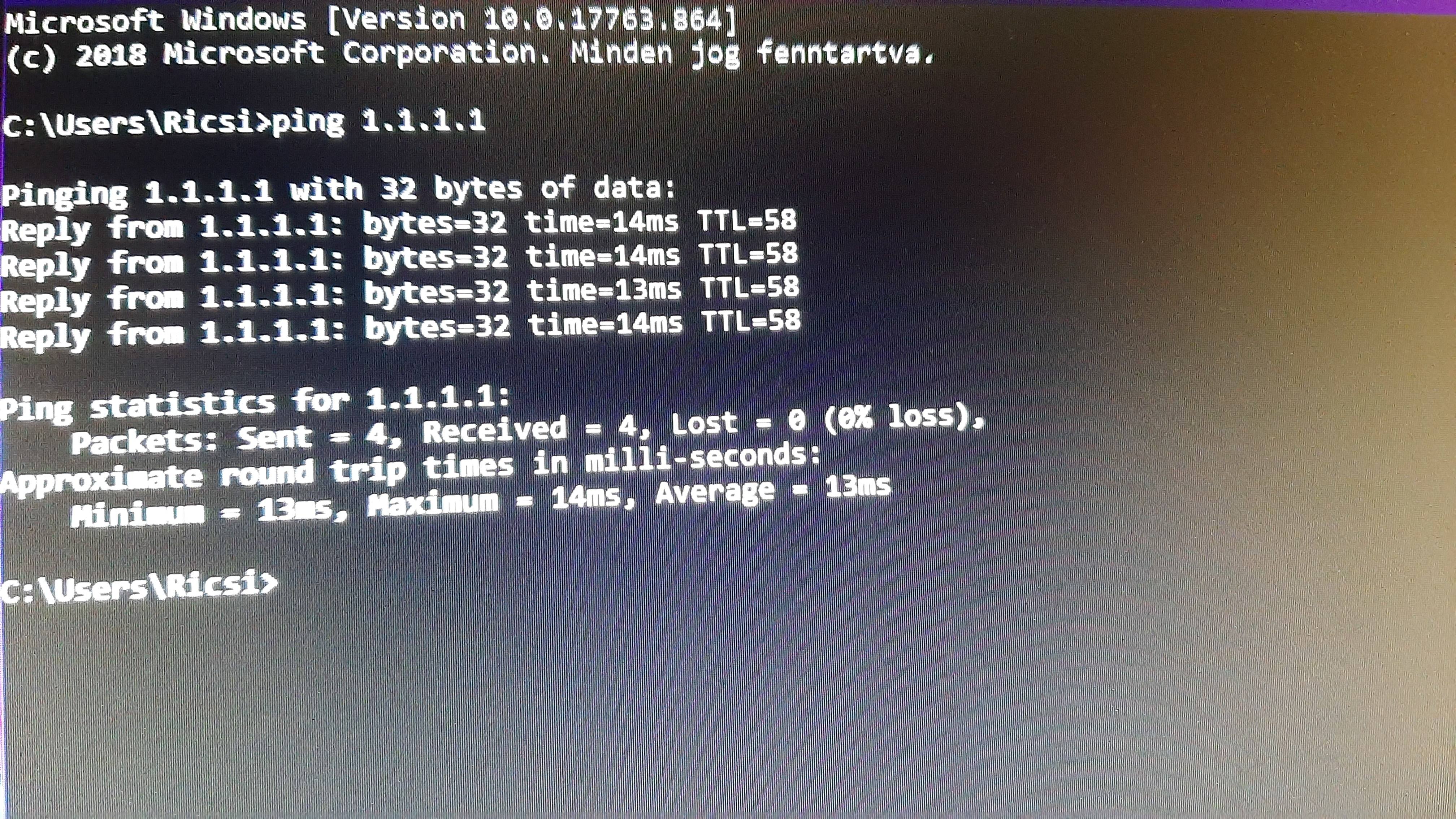

I can ping my router but idk what a DHCP lease is.
Your DHCP server gives you an IP address. That address is valid for a certain time, before your computer is expected to renew it. That's a "lease". You can see it in your screenshot actually (Should be "DHCP-bérleti jog kezdete/vége").
Well, that means you're online, because otherwise you couldn't ping a DNS server that is on the Internet ;)
It may just be Windows acting stupid. You should be able to open "1.1.1.1" in your browser. If that works and something like "google.com" still doesn't it means you "only" have an issue resolving IP addresses.

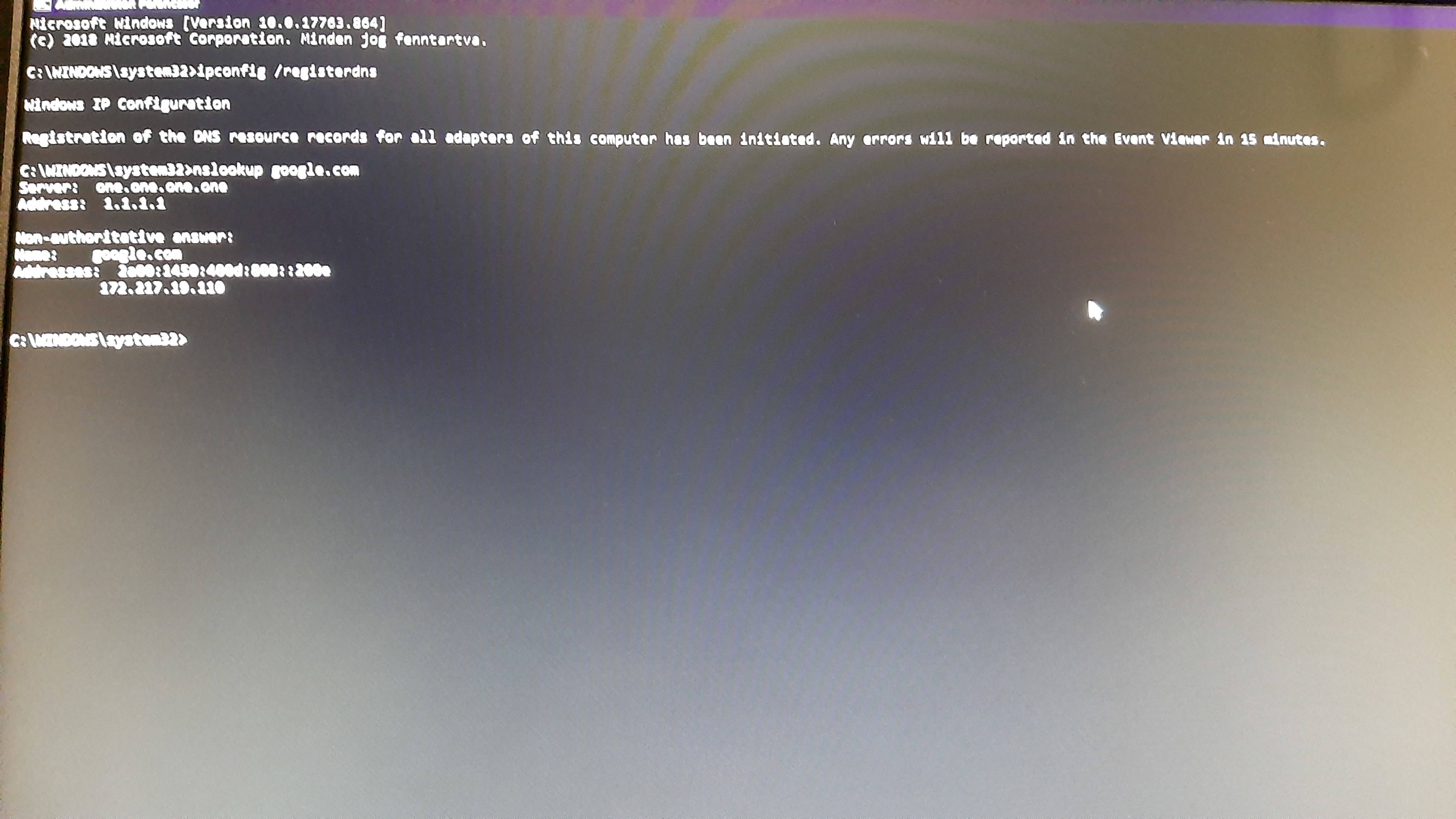

Hm, so you're online in general, but it looks like DNS isn't working properly for some reason. Can you do "nslookup google.com" on the command line? That should show which DNS server it's attempting to use.
You can also try "ipconfig /registerdns" and then retry the first command.

So... you should be able to open google.com in your browser now, because that shows that your computer can resolve the name to an IP address

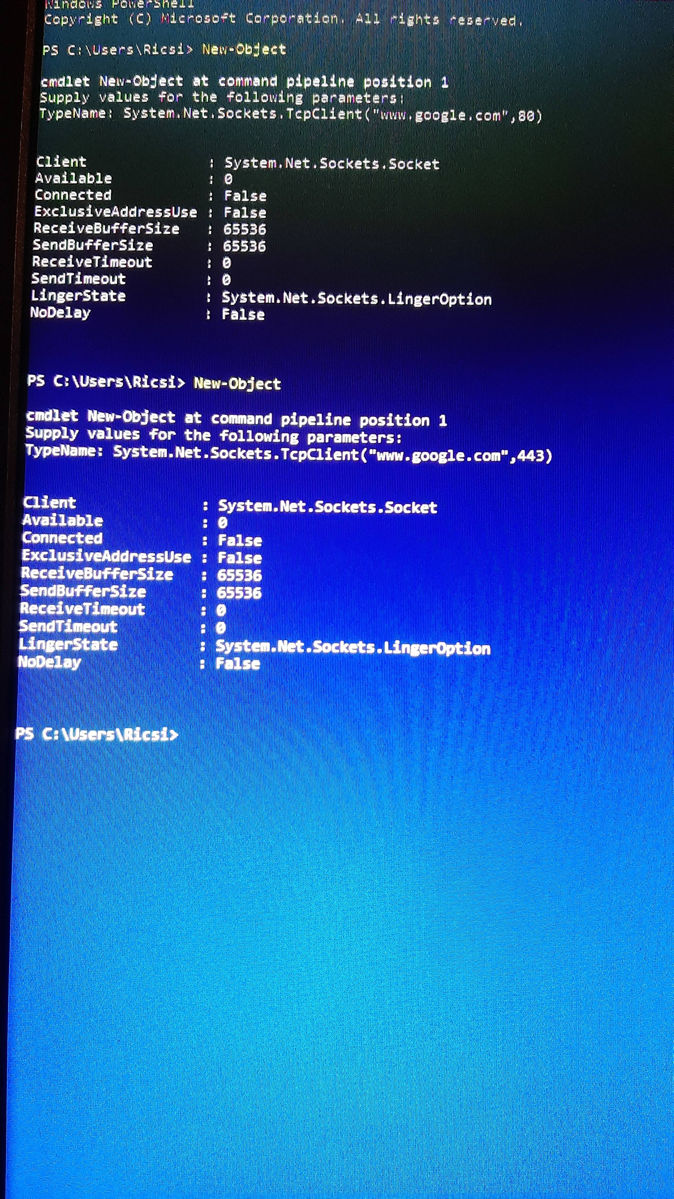

You could try the following on PowerShell:
New-Object System.Net.Sockets.TcpClient("www.google.com", 80)
You should see "Connected: True" in the output. If you don't, then something is blocking your connection to port 80 (HTTP). You can try the same with port 443 (HTTPS). If neither of those works, then something is preventing you from connecting to port 80. Might be a firewall, might be a virus.

Yeah I can't connect to either of them. What can I do about that? I'm 90% sure it's a firewall issue because I have both Malwarebytes and Avast.
