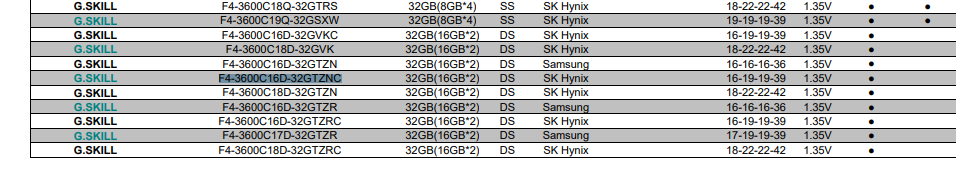

I can apply the the DOCP and get the timings right but anything over 3200mhz i cant post. I've made sure I have latest BIOS installed. My RAM kit is on the 3000 series compatibility chart. I've tried to adjust voltages and timing manually and just can't seem to get it to boot at 3600mhz. My theory is that because it is an x470 chipset that im just waiting for the right BIOS update. Any ideas?

Thats likely specification for unsupported ram or something unrelated to their problem, like they said the ram is supported, albeit only for 2 dimm slots, on manufacturers QVL https://dlcdnets.asus.com/pub/ASUS/mb/SocketAM4/ROG_CROSSHAIR-VII-HERO/ROG_Crosshair_VII_Series_Ryzen_3000-series_Memory_QVL.pdf
OP seems to know what they are doing, so i doubt they put them in the wrong dimm slots etc (usual b2 and a2 location ofc)
