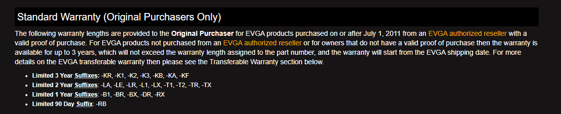

With your model: Part Number: 06G-P4-1996-KR seems you have 3 year warranty.. Depending when you bought the card, I would just RMA it... As it seems you have two of these cards, that shouldn't be a issue of downtime either.
https://www.evga.com/warranty/2011/graphics-cards/
Unfortunately the warranty is expired. I've already submitted a ticket to EVGA, but they just told me to check a couple things, but closed the ticket. So I have to open a new one now and see if anything can be done. Thanks though!
That's unfortunate :(
