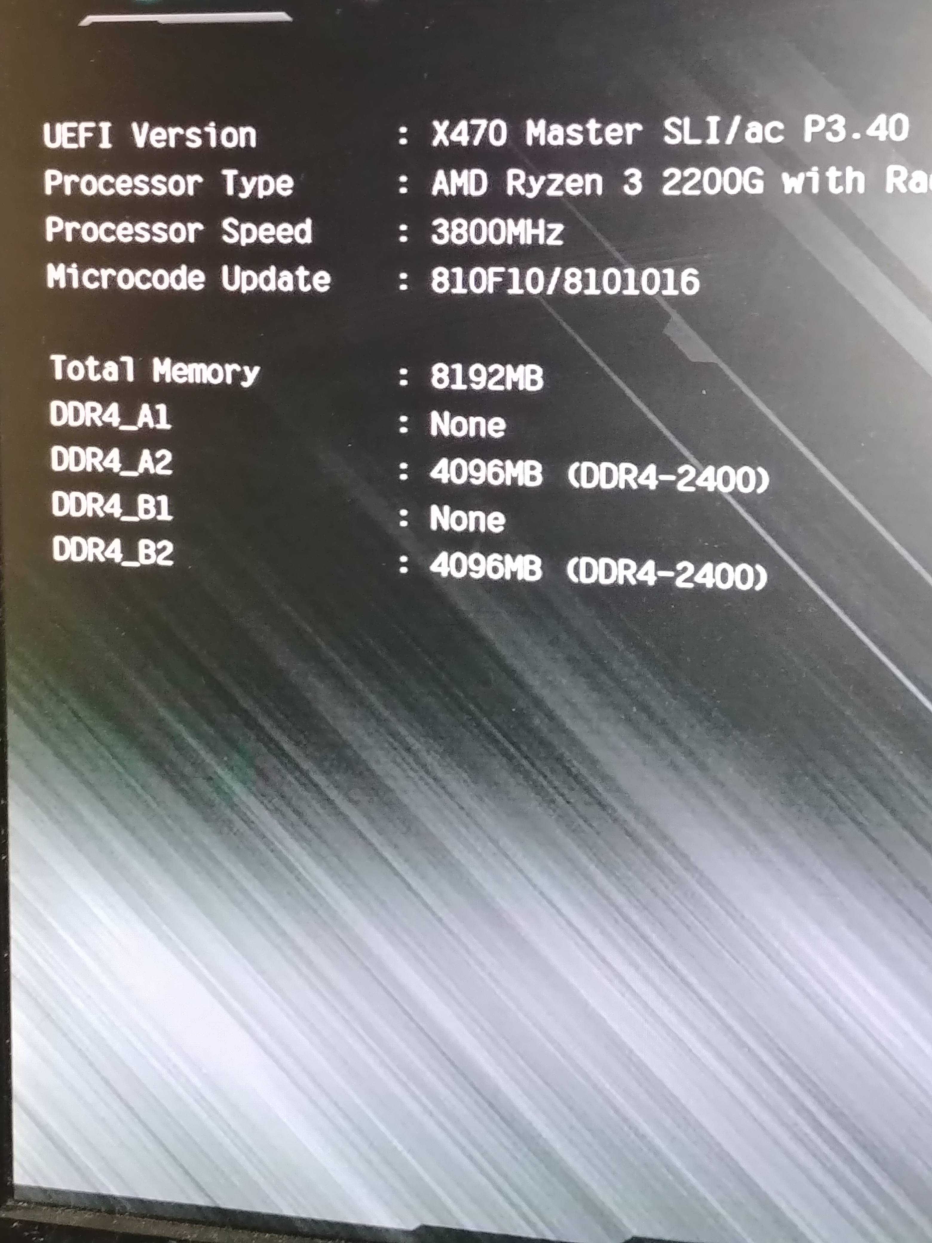

Sometimes it will restart a few times when first installed, usually 3-5 times for ram training. This is normal. If it continues after then there could be a problem. If there is a problem, then take and boot up with a single stick testing each slot to see if there is a defective slot on the board. Could also be a problem with the memory controller on the CPU too.

If it doesn't boot with only B2, the board needs to be RMA'd.
