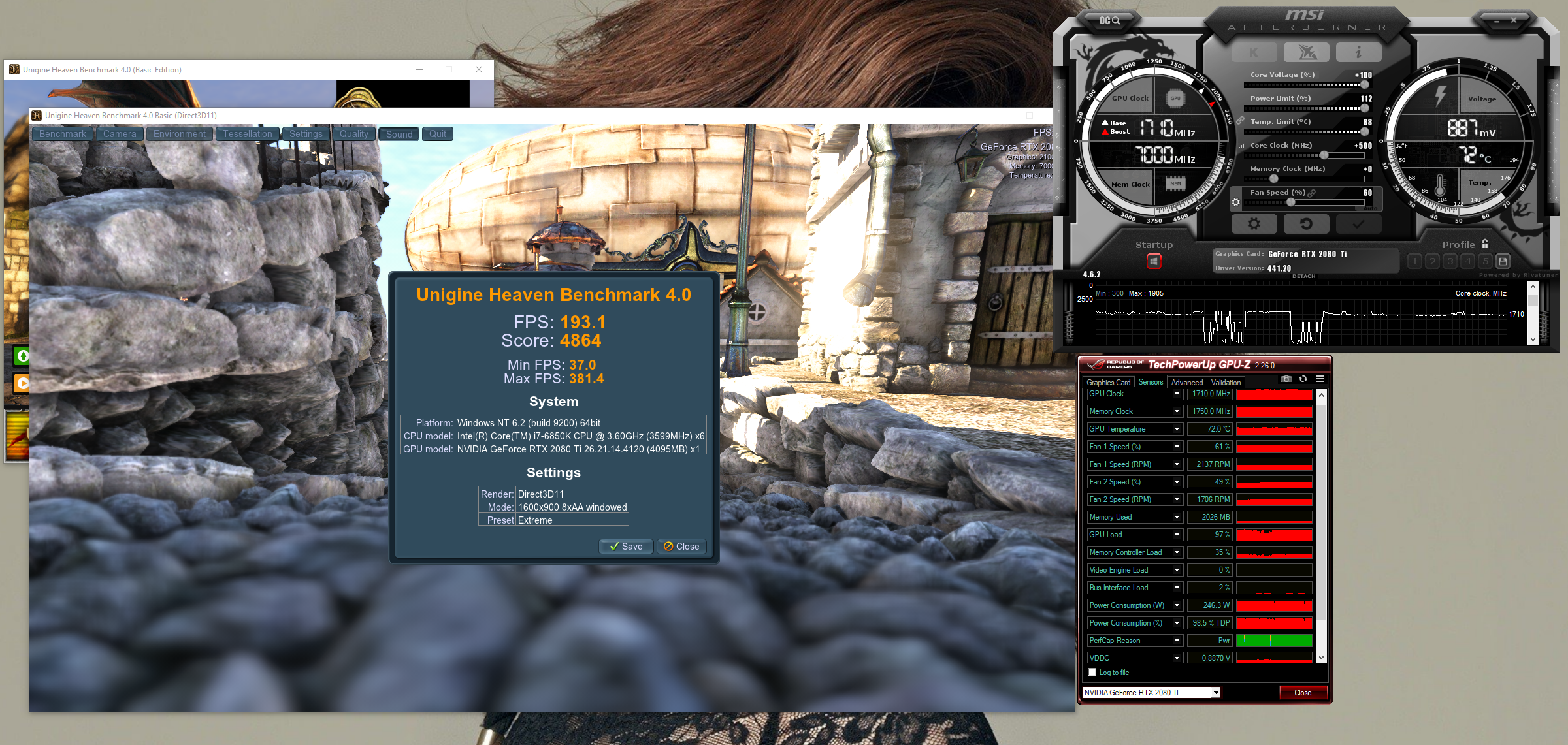

Hi everyone,
So before i start to refund this GALAX GeForce® RTX 2080Ti SG Edition, I just want to ask everyone's opinion on the card below.
http://www.galax.com/en/graphics-card/20-series/2080ti-series/galax-geforce-rtx-2080ti-sg-edition.html
I was only looking at 1700Mhz of overclocking capability with fan speed at 60%
Memory clock was impossible (Don't know why).
Performance gains from what i see with my card before (GTX 1080 xtreme by Gigabyte) wasn't that huge as well.
So yep.... What do you guys/ladies think about the card's performance? Should i just give it a full refund?
PS: I am using a 1440p 165hz monitor, just wanna see 80-100fps in most games.

Try open GPU-Z and check PerfCapReason in Sensors tab.
Also why the clock speed bouncing up and down before the benchmark started? Are you on multi monitor setup?

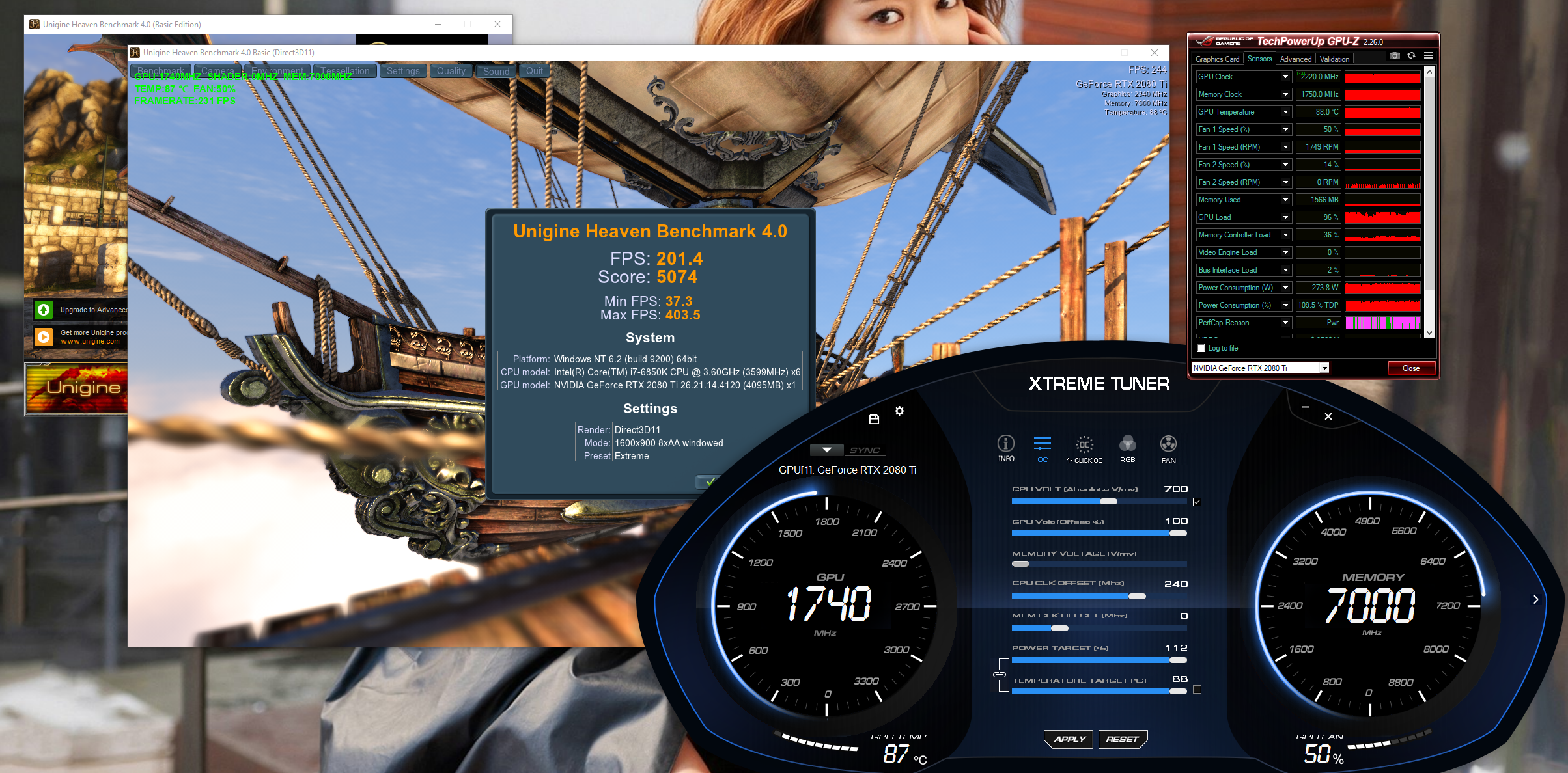

Hi there Jones,
So for your first solution as of below:
With regards to your card, you are getting a FTW3 ultra with boost clock of 1755mhz already while mine its in the 1545mhz.
My overclock was already increased by 500mhz from base which was only 1350mhz.
So i am guessing what i paid is what i get? Hahahha ($1640 SGD for this card).
For the power graph, i am seeing only at about 100 range during benchmarking as of below. I not sure why it is not at 112%?
Edit: So ummm i took a look at the Unlock Voltage control options: I selected "third party" as of other types which are 1) Reference, 2)Standard MSI, 3)Extended MSI and 4) Third party, So generally i thought mine was none of the 3 options which i selected third party instead. Is that option correct?
Hope the above clarifies.

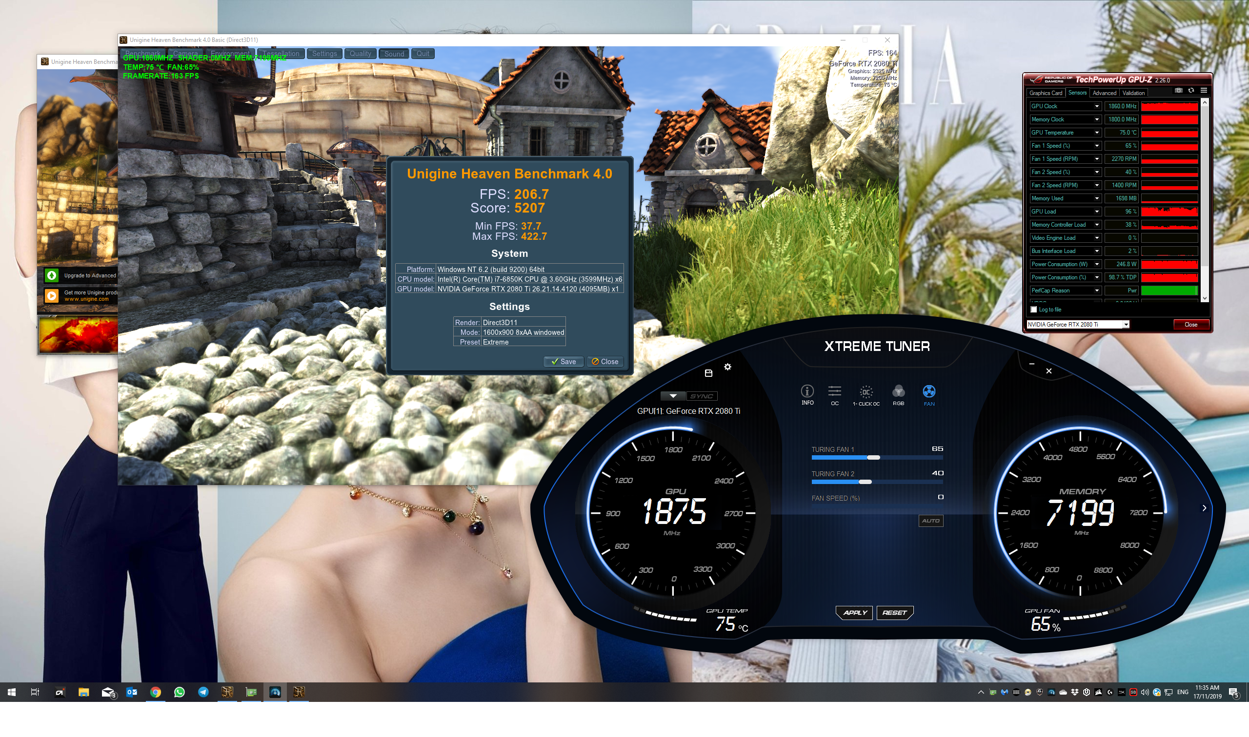

So, I decided to give Galax's own tuner software to test the card itself.
As of below it actually works fine for now!
I am not sure why afterburner wasn't pushing the limits for this card. Was able to push the card to 1800-2000mhz range for the "XTREME TUNER" software.
So in conclusion i guess whatever software the brand throws at you, just... use it? Hahaha

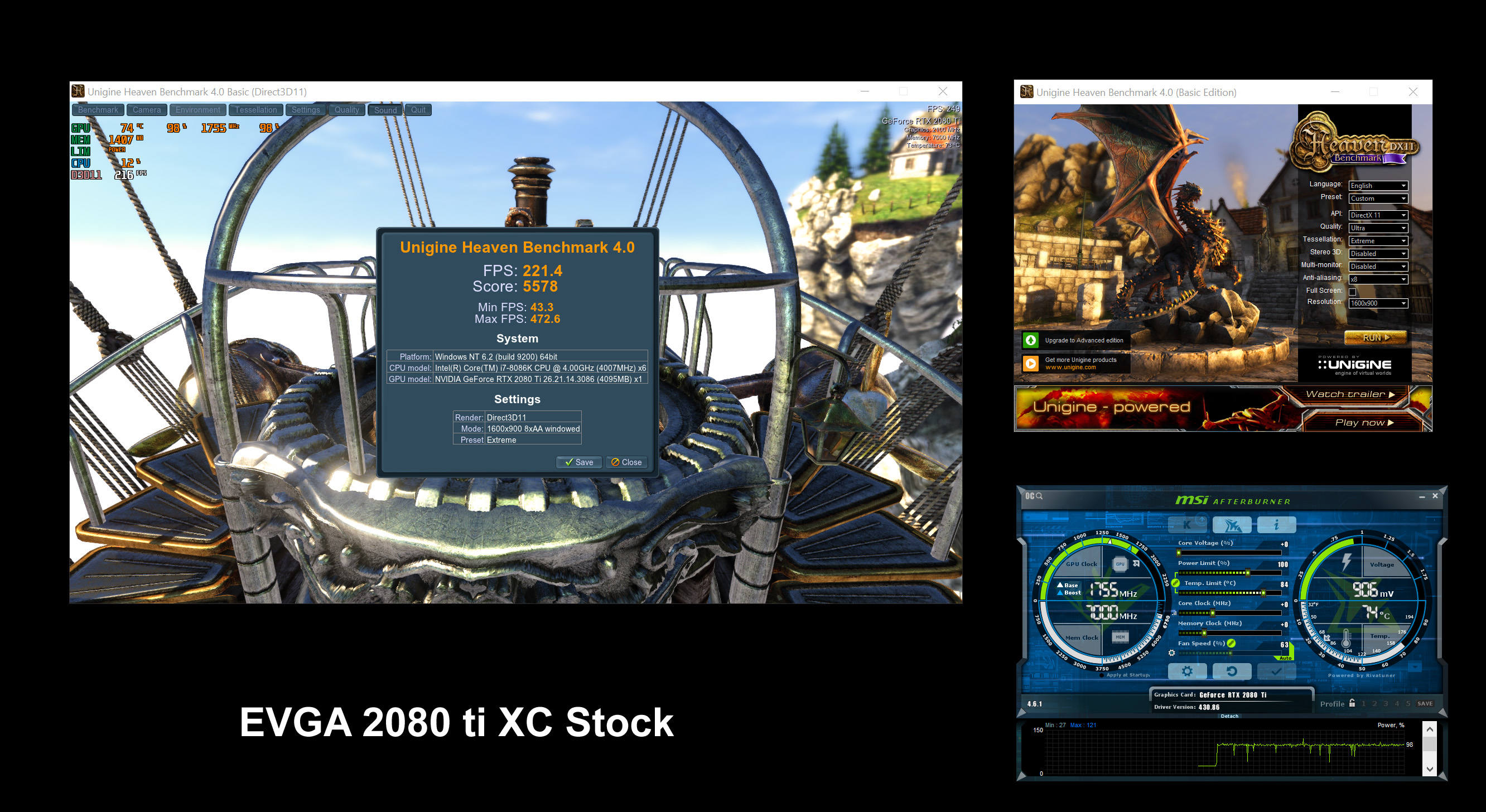

You are still being held back by your CPU.  I also have a computer with an EVGA XC 2080 ti that has closer performance to your GALAX.
Even stock it will beat your score since it is paired with a 5gz CPU.
Here is what it looks like stock and overclocked.
If you run benches at higher resolutions you will meet then beat my EVGA XC scores.

I see, i am surprised you can run both at all because the Galax can't seem to be turned on while afterburner is opened. Therefore i had only GPUZ to monitor the core clocks.
Quote
You are close enough to 112%. If you lower the anti aliasing to 4x or 0 you should be at 112% on the bench.
For this, the MSI afterburner doesn't seem to lock in the 112% that the card offers, so i switched back to the Galax's Xtreme Tuner Plus software instead and got a better result as of what i have shown previously.
I see, noted of this my CPU currently is overclocked to 4.3GHZ only. So yea... heehee
Noted, i am trying to run the same thing as the rest to see how good this Galax card really is.

So as of below are my recent results
Above is additional overclocked of +230mhz with zero overclock to the memory and with the fans at 70%
Above is additional overclocked of +232mhz core clock and memory overclocked of +200mhz with the fans at 65%
I will still continue to run the tests to see what is the limit of this card. I feel that its promising but the longevity of the cooling is a mystery.
