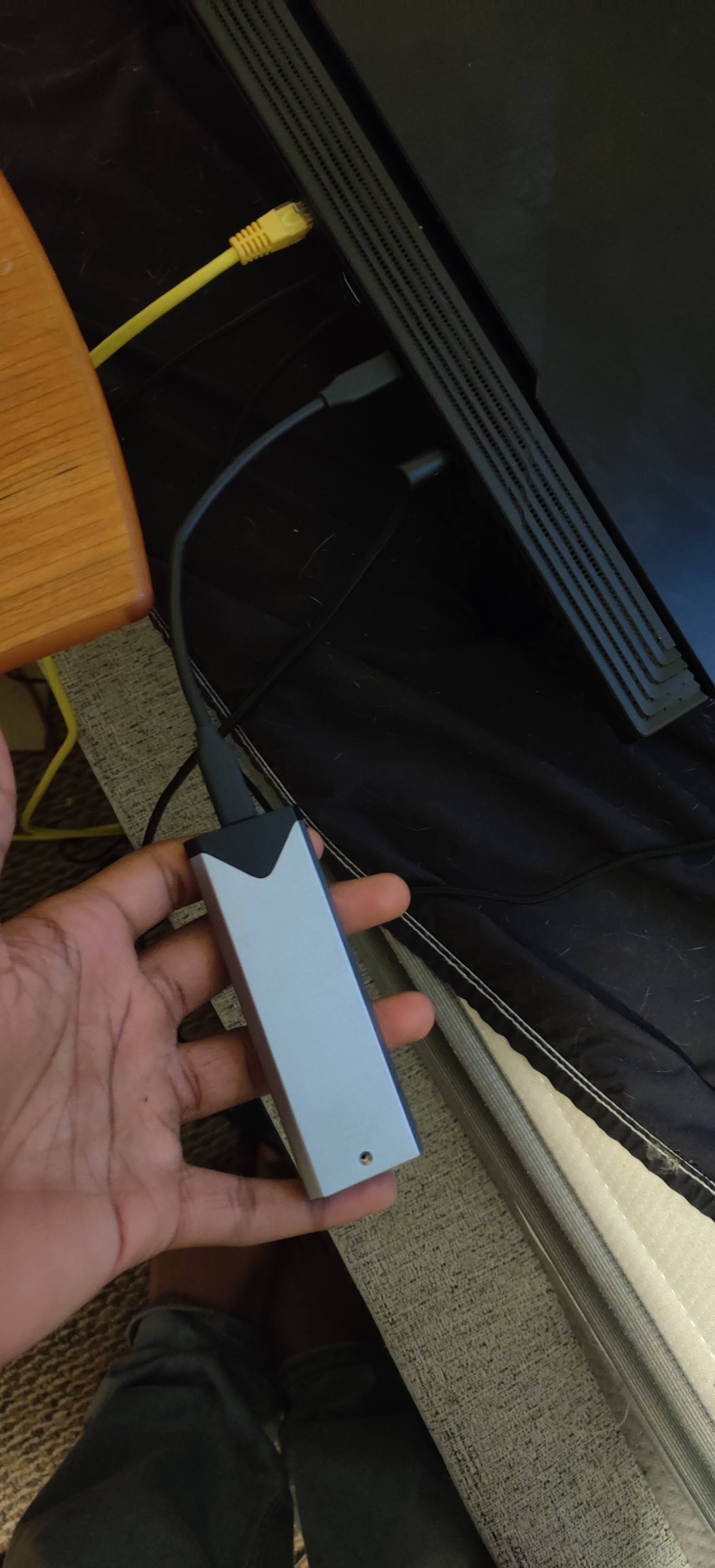

Just tried that, says it doesn't support installing to USB devices and the drive has a mbt partition rather than a gpt partition. Even though I switched the ssd to a gpt partition
Perhaps I should try it on a actual flash drive rather than just an m.2 ssd in an external enclosure?
You need to take some screenshots of these messages and upload them here. Why does it say you're installing to USB?
Wait... I'm very confused. You're trying to install windows onto an M.2 drive inside a USB enclosure?
Or are you trying to create a Windows Install USB onto an M.2 drive?
To install Windows, you first create a bootable USB Drive using the Windows Media Creation Tool. Then, you plug that USB drive into the computer (along with the SSD you want to install onto), and boot form the USB Drive. Then you target the SSD, and go from there.

I have an ssd In a external enclosure and I'm trying to install Windows onto it, so yeah I thinks my situation is the latter
Okay.
So you took a USB Flash Drive (Eg: A Kingston DataTraveler), and you downloaded the Windows 10 Media Creation Tool, and you targeted that USB Flash Drive and created a USB Windows Installer?

2 minutes ago, AzrealNoctis said:
Not exactly, it's just an ssd in an external enclosure with a USB c port
Okay. So you're not doing it correctly. You're skipping a step.
Before you can install Windows, you need to create a Windows Installer. You haven't done that yet.
And I need a separate flash drive to do this correct?
Yes. Or a DVD-R, since you could burn it to DVD instead - but a Flash Drive is the superior method.
Step 1. Download the Windows 10 Media Creation Tool
Step 2. Insert a USB Flash Drive
Step 3. Launch the Media Creation Tool, and select the aforementioned Flash Drive
Step 4. Use the Tool to create a Windows Installer USB Drive onto the aforementioned Flash Drive
Step 5. Shut down the computer
Step 6. Insert the USB Flash Drive into the computer, along with the SSD
Step 7. Boot to the USB Flash Drive
Step 8. Follow the on-screen instructions to install Windows, targeting the SSD. Make sure to delete any existing partitions on the SSD, if any exist (if none exist, just proceed)
Step 9. ???
Step 10. Profit.
