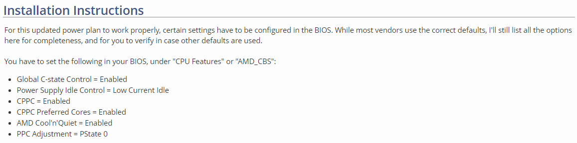

If you aren't willing to update BIOS atleast look for these settings and make sure they are set as so
It was recently confirmed by AMDRob that most issues with Ryzen 3000 voltage issues, usually resulting in issues with excessive power consumption at idle, were due to occasional mobas not being setup correctly and he cited the 1usmus guide as exactly the way they should be set. he talked about it somewhere about 40 minutes into this
Link to article with more information about bios settings: https://www.techpowerup.com/review/1usmus-custom-power-plan-for-ryzen-3000-zen-2-processors/
I'm not recommending you download this power plan, but atleast check if BIOS is set correctly, where it applies and download most recent official chipset driver if you haven't already.
