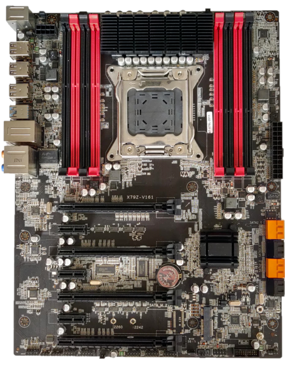

i got this motherboard(see pictures) 2 weeks ago, because my Asus X79 had some issues after the years.

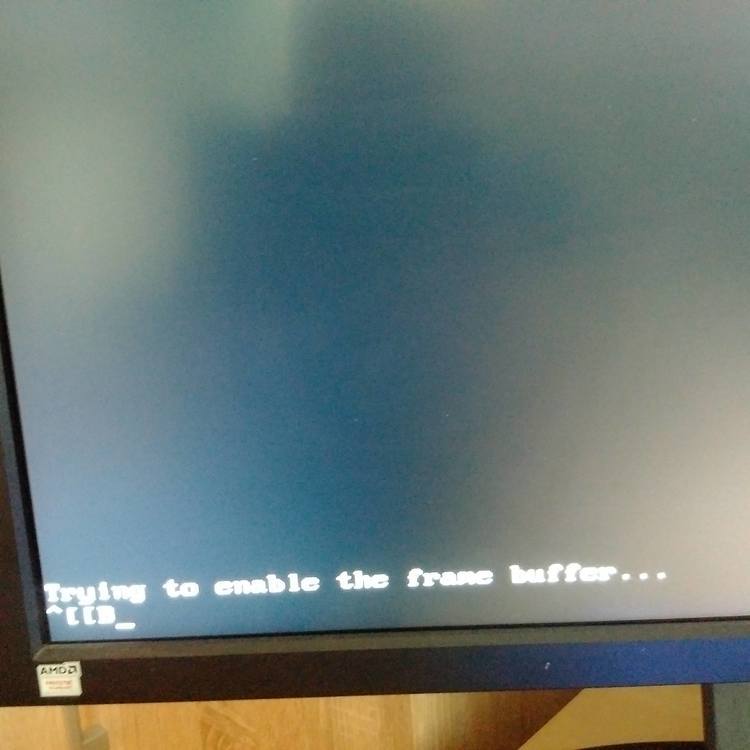

However, when i booted to the Linux which i already had installed, it is just crashing. Usually just in a one or two seconds. So i tried to install new one, however just once the installation process starts, it also crash. (it does not crash actually, it always just completely freeze). The Linux which is already installed is Debian 9.0, tried installation of Debian 9.0, Debian 9.1 and latest Ubuntu and had same results.

(well, he also claimed it support multi GPU, which doesnt, also said it is ATX which is not (its 2.5cm bigger then ATX, so it wont fit any ATX case), and some other things..)

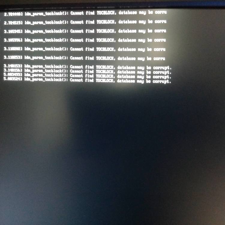

I dont think any of the messages which you can see on screenshots, have anything to do with the crash, i had them before and and it was working fine.

3 minutes ago, elsandosgrande said:
well, thanks for response, but as i said, this error messages are not connected with the freeze issue
i will try some completely different distro, CentOS and will see
