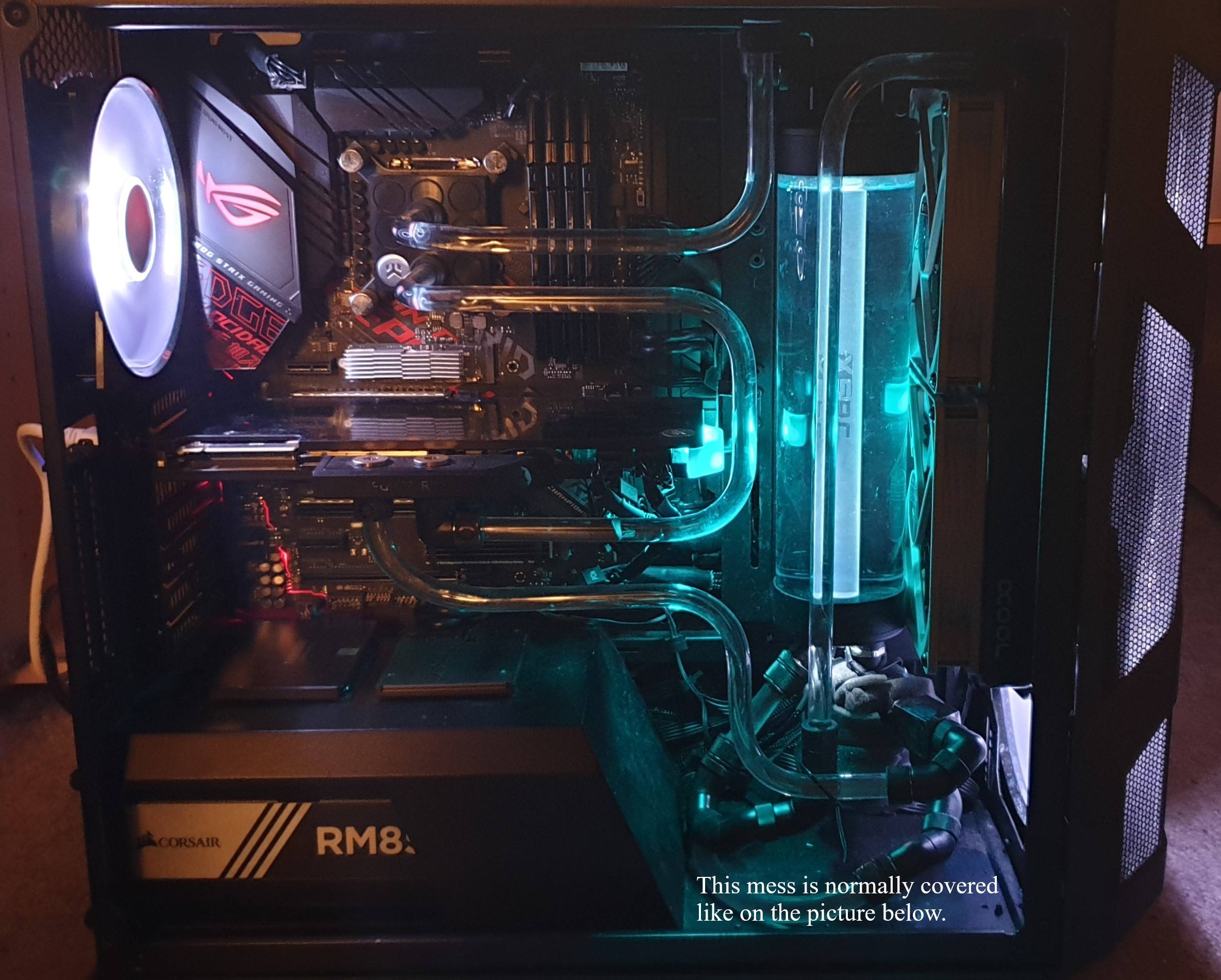

You could just mount the fans on the inside of the case.
Then you can keep the 200m fans on the front. I did that with my 280 and it works great.
At first I tried it with only the 200mm fans and it wasn't good. Barely okay. I wouldn't recommend it.
I am using 2 280mm rads in series, running 1 with CPU fans and the other with GPU fans, so no matter whats under load, the water will be cooled.
